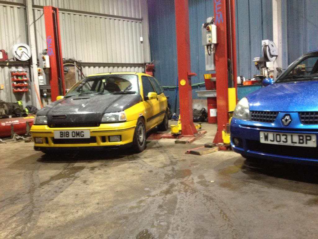

I'm starting a full rebuild on mine so will defo have a look at this. Is the track visibly wider?
In the OP's sig it says he has a 172 cup racer, their engines sit lower right (as well as gearbox) so what drive shafts do they use? If they run 172 cup drive shafts then they would stick out more due to them being lower...right/wrong?
Yes mate, my ph1 turbines sit probably only about 5mm off of flush with the arches on the ph1 172 setup.
Ah, may well look @ it when the time comes. Looks pretty sound there mate... That a willy on a valver? Wing mirrors say valver...
That is a valver shell, but they are absolutely identical anyway mate so makes no difference to how it sits.
