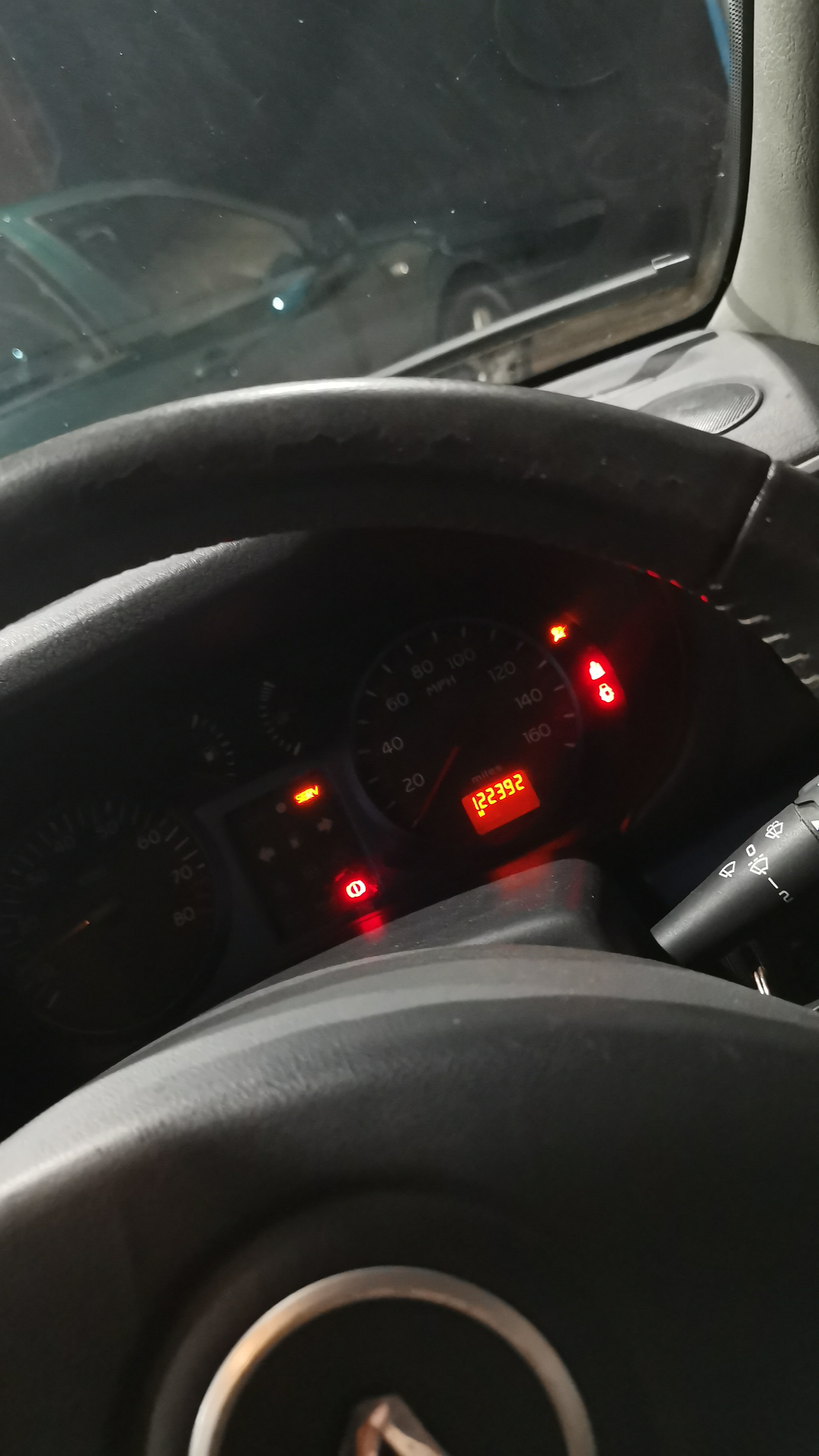

Hi guys,
Got a fault with my 172 Cup.
It's got the EML light on with the faults being for O2 Sensor and Throttle Position Sensor. I've tried another pedal and throttle body neither of which have an effect on the codes.
On top of this, the speedo doesn't work either which suggests it's a different issue rather than the individual components.
Just wondering if anyone had any idea what it could be before I take it to someone.
(engine etc are out of my old Cup and it had none of these faults prior to breaking it)

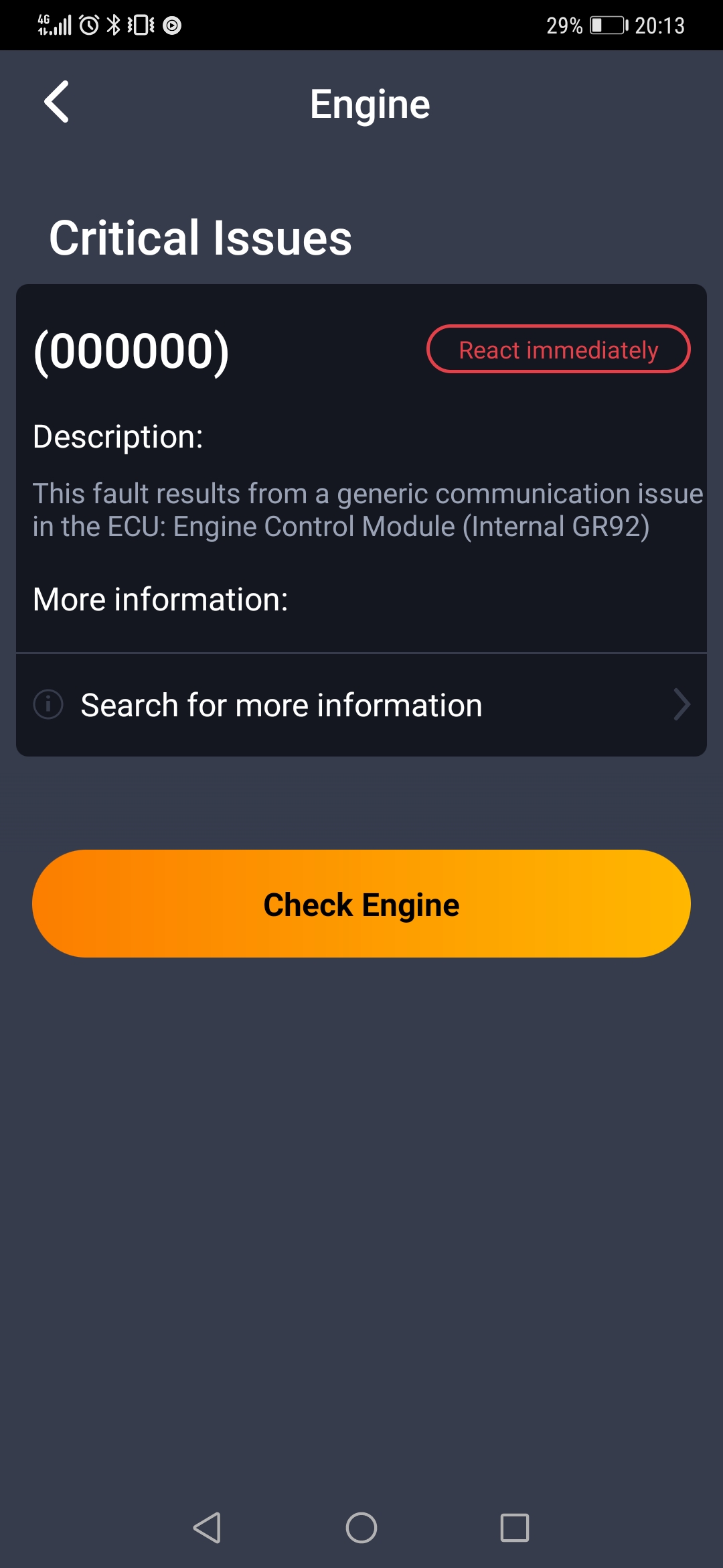

So interestingly I discovered Carly does renaults. Plugged it in and it came up as an ecu communication error. To my surprise its actually cleared it!
Fault still exists but light is gone.
Airbag light to fix next.
