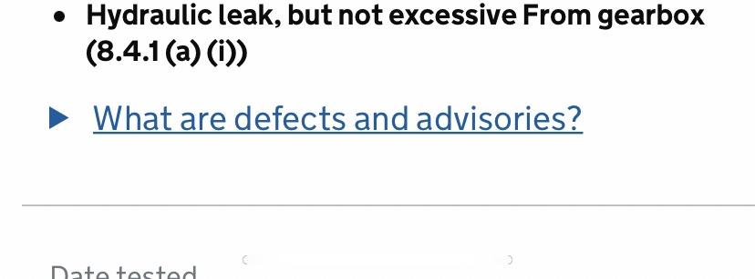

You also need a slight selector seal leak for it to be truly OEM too
Funny you should say that...
