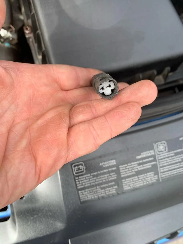

I also found this plug not connected to anything at the front by the fan, does anyone know what it’s for or if it should be connected?

The plug is for the Accoustic valve I think mate. It is part of the air intake system and is located just above the passenger front wheel arch.

I’ll have a look to see if the bonnet switch is present and plug this back in then thanks!

Bonnet switch is completely missing presumably removed due to an alarm fault? RPD lists 2 parts on their website but it’s not clear which is for my car? Can anyone advise? I’ll be placing a rather large order with them in the coming days I think [emoji23]
Yes I’m keen to keep it as clean and original as possible, still finding out what is correct and what needs changing but apart from a ktr stealth cat back exhaust and a panel filter I think it’s completely standard and original.
Haha I think it might take a bit more than that! IF I ever sell it it will be on here no doubt but I certainly don’t have any plans this time around, I regretted selling my last one 9 years ago and to think I sold it for £1k [emoji24]
Thanks [mention]dave120 [/mention] I’ll order that one then.

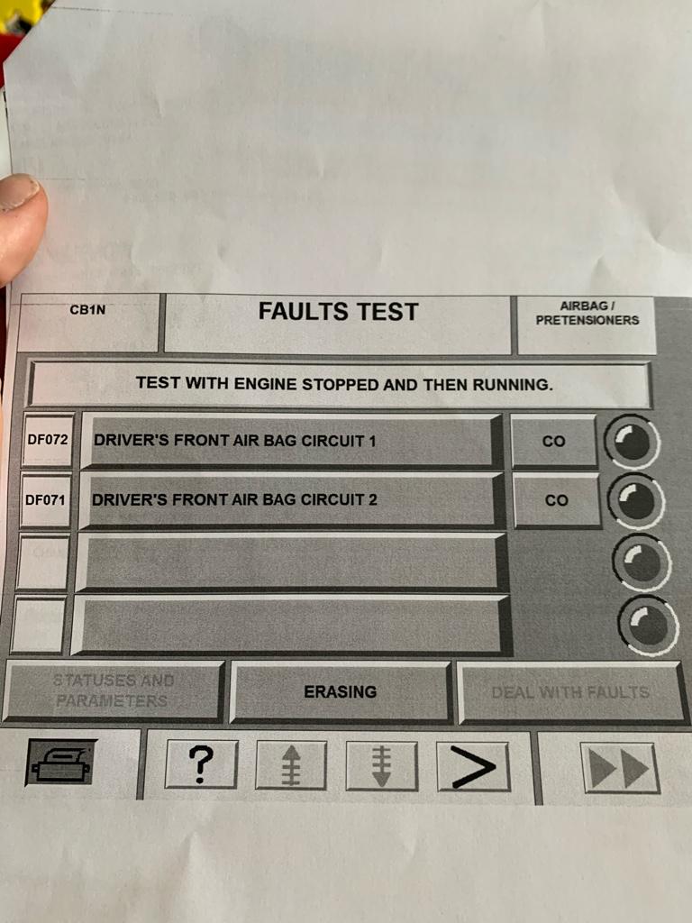

The garage plugged in to try and find out what was causing the SERV light on the dash and found the following codes.
DF071
DF072
They put it down to a faulty steering wheel/column squib and said it would be £272 for a new genuine replacement and fitting. I’m quite happy to try a second hand one and fit it myself but has anyone had any experience of this? And are they interchangeable or does anyone know the part number?
They also said it looks like someone has covered up the airbag light or removed the bulb as this does not come on at all.
Sounds like the Airbag light is the problem and the SERV light is just the secondary issue.
I had the Airbag and SERV light on, in my car and a new Rotary switch on the steering column resolved the issue.
Personally, I’m not very mechanically minded so I was happy to let the professionals diagnose the issue, fit the parts and resolve once and for all.
Im not sure how much a second hand part is but if you are guessing with these types of things then you can end up throwing good money after bad.

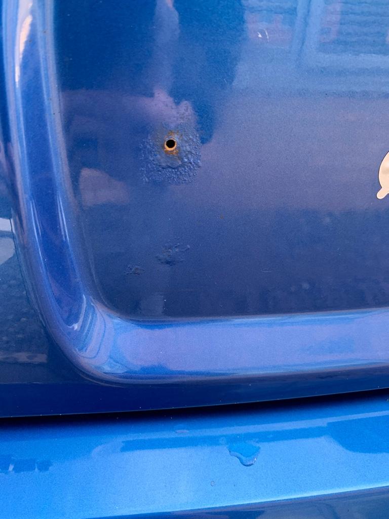

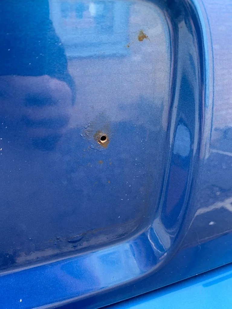

Put new 3/4 plate on the front and fresh plate on the rear. However i found some bubbling around the holes where the old plate was screwed into the body work. Seems daft that Renault fitted plates like this in the first place as surely it was only going to end in corrosion. Hoping it can be taken back to bare metal and treated before painting but if it needs cutting out it’s very localised so only a small patch and will be hidden behind the plate in future.
You’re right the airbag light is causing the SERV light but someone has either covered it,removed the bulb, or had it coded out? Not sure if this is possible? Second hand only seem to be about £30 so I’m tempted to take a punt on a used one providing the seller can confirm no lights on the car it was removed from. I’ve changed squibs on other cars so I’m confident it won’t be a difficult job.

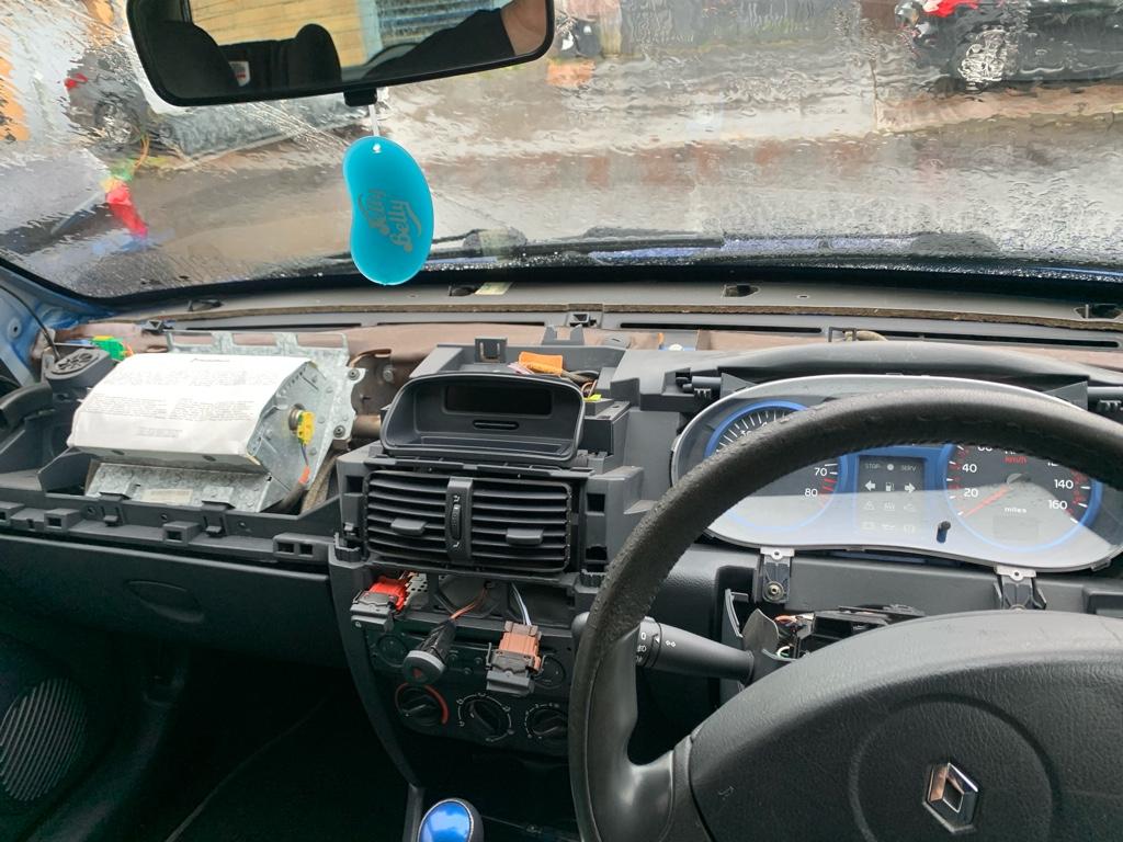

Going to take the dash out when I get chance to see what’s going on with the airbag light.

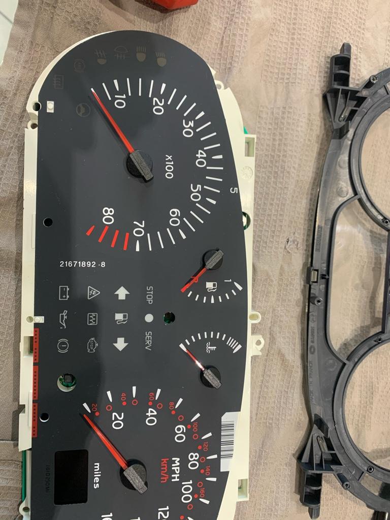

Had the dash out this afternoon to see why the airbag light wasn’t illuminating despite the fault codes.
As suspected someone had put black tape over the light to stop it showing, so that has been removed and I can now try and get to the bottom of the fault which is a suspected steering wheel squib fault.

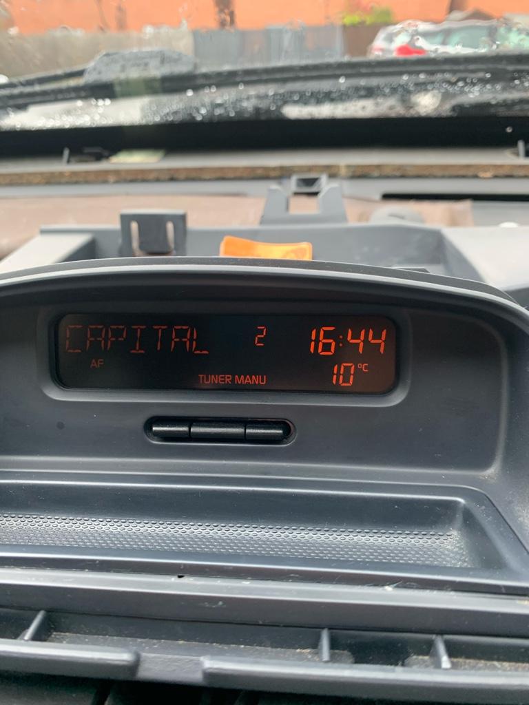

Also noticed the radio display was dimmer on one side so replaced the bulb in that side with the one I bought for the ashtray except now the other side looks dim [emoji2357] so I haven’t replaced the dash yet until I get another bulb.

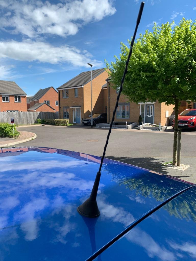

Couple more little jobs ticked off the list today. Correct aerial fitted to replace the existing one that has 2 adapters fitted in the middle [emoji848]

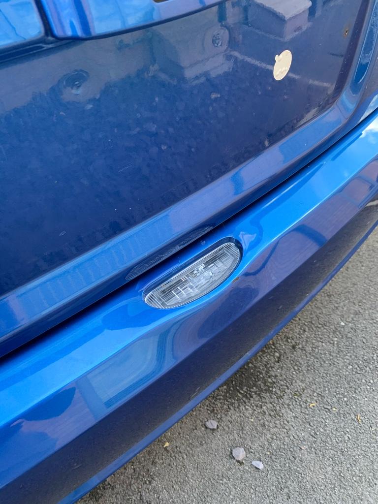

Fresh number plate light fitted to finish off tidying up the rear

Refitted the number plates as the double sided pads I used were terrible. Took a couple of photos of the corrosion around the old number plate screw holes, not sure how best to tackle this as the rest of the paint on the boot lid is in perfect condition so I’d rather avoid getting the full boot lid resprayed.
Ideal place to experiment with rust repair.
I follow this guy on Youtube, he is by far the best automotive "how to" guy I've found so far. Link below. Good luck.
Hmm, i mean that’s a reasonable guide for using filler on your drive and how to paint, but that rust will be back in months. He hasn’t repaired it at all
I think with regards to the paint I’ll probably just take it to a proper body shop to get done. There will be a few bits like front bumper, wing mirrors, possibly bonnet, and any rust spots I find when I get chance to take the bumpers and side skirts off
