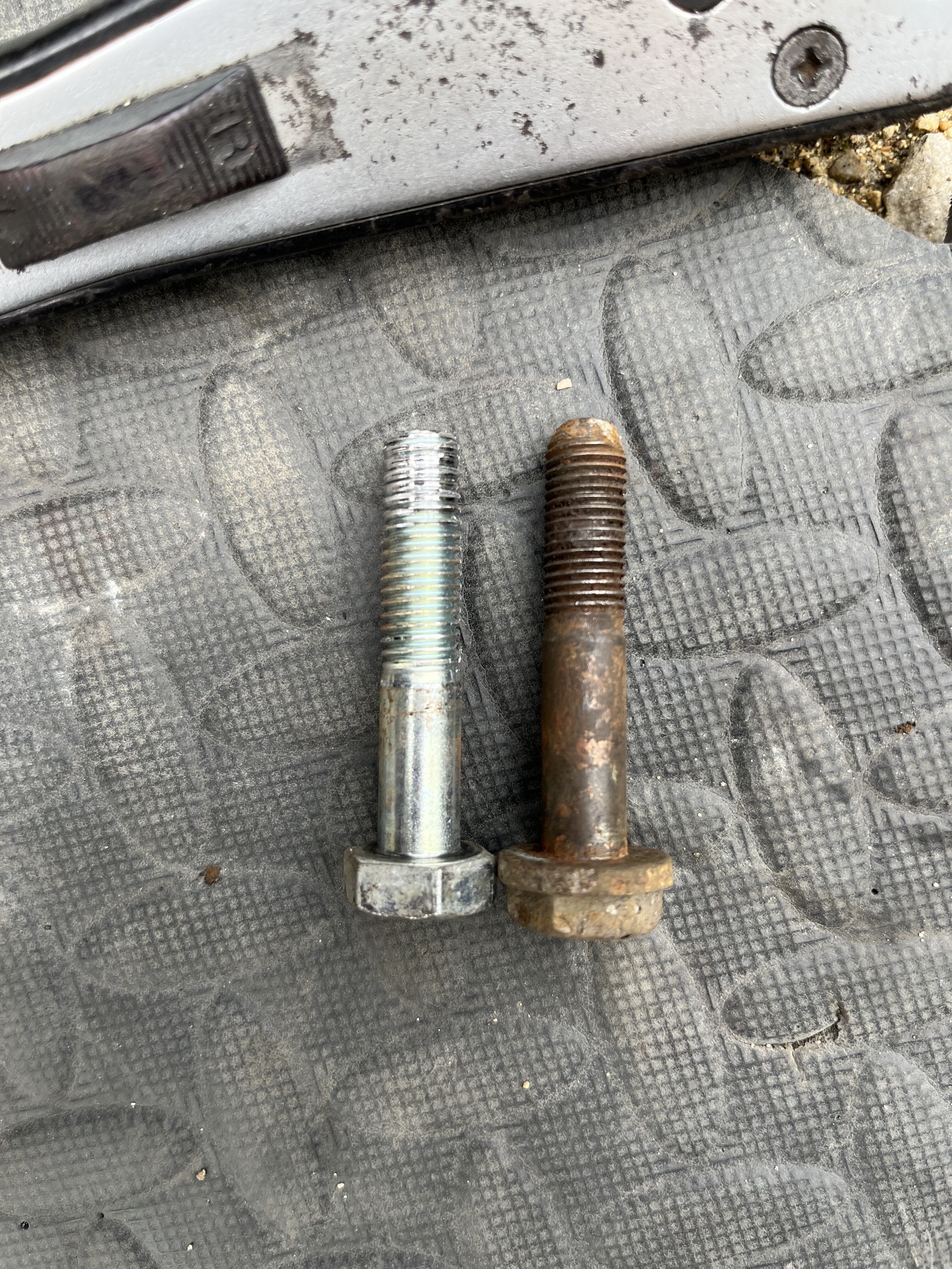

It then occurred to me that i used the supplied Meyle bolt for the ball joints. I bet there isn’t sufficient shoulder length and the ball joint is resting on the thread instead of the shoulder therefore not 100% secure.
c**t, so I've ordered Lemforder ball joints to replace the Meyle as they were on offer so like for like. I’ll get a refund for the Meyles through Ebay so hopefully problem solved. I kept the original pinch bolts so i’ll compare the shoulder length once removed.
99% certain this is the issue. f**k you Renault for discontinuing cup wishbones.

Lemforder ball joints fitted - no more rattle, see pics below of pinch bolts.

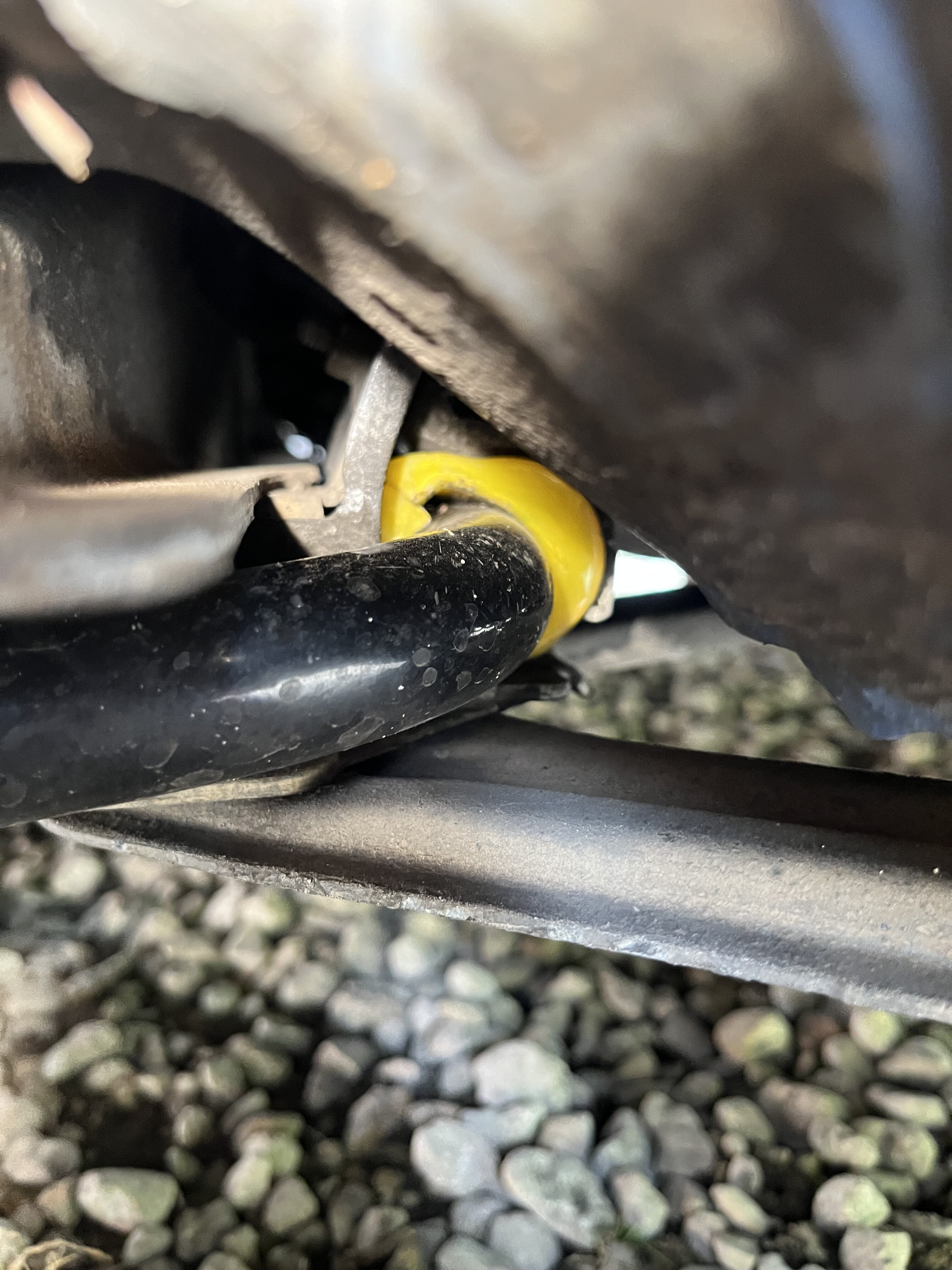

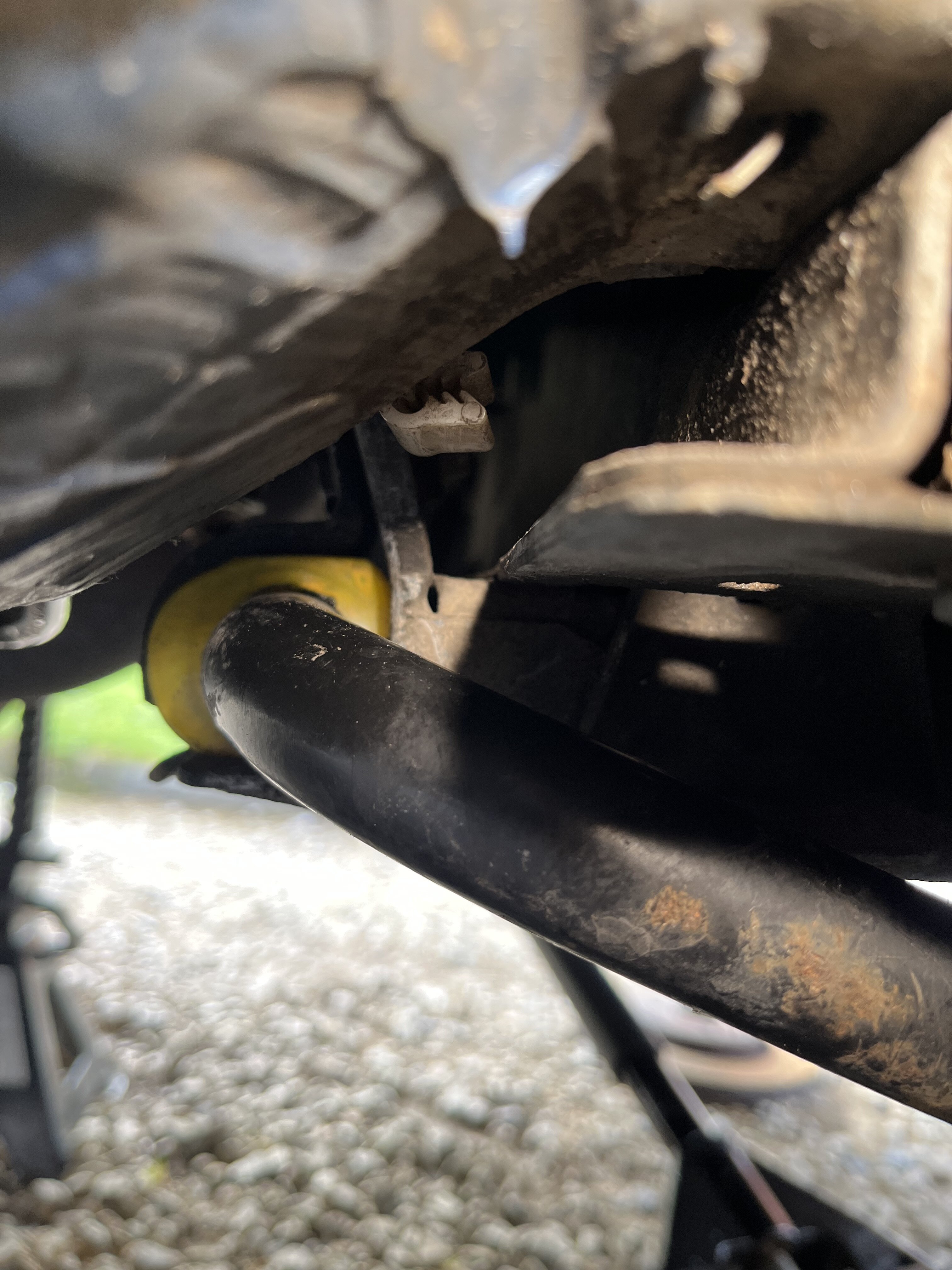

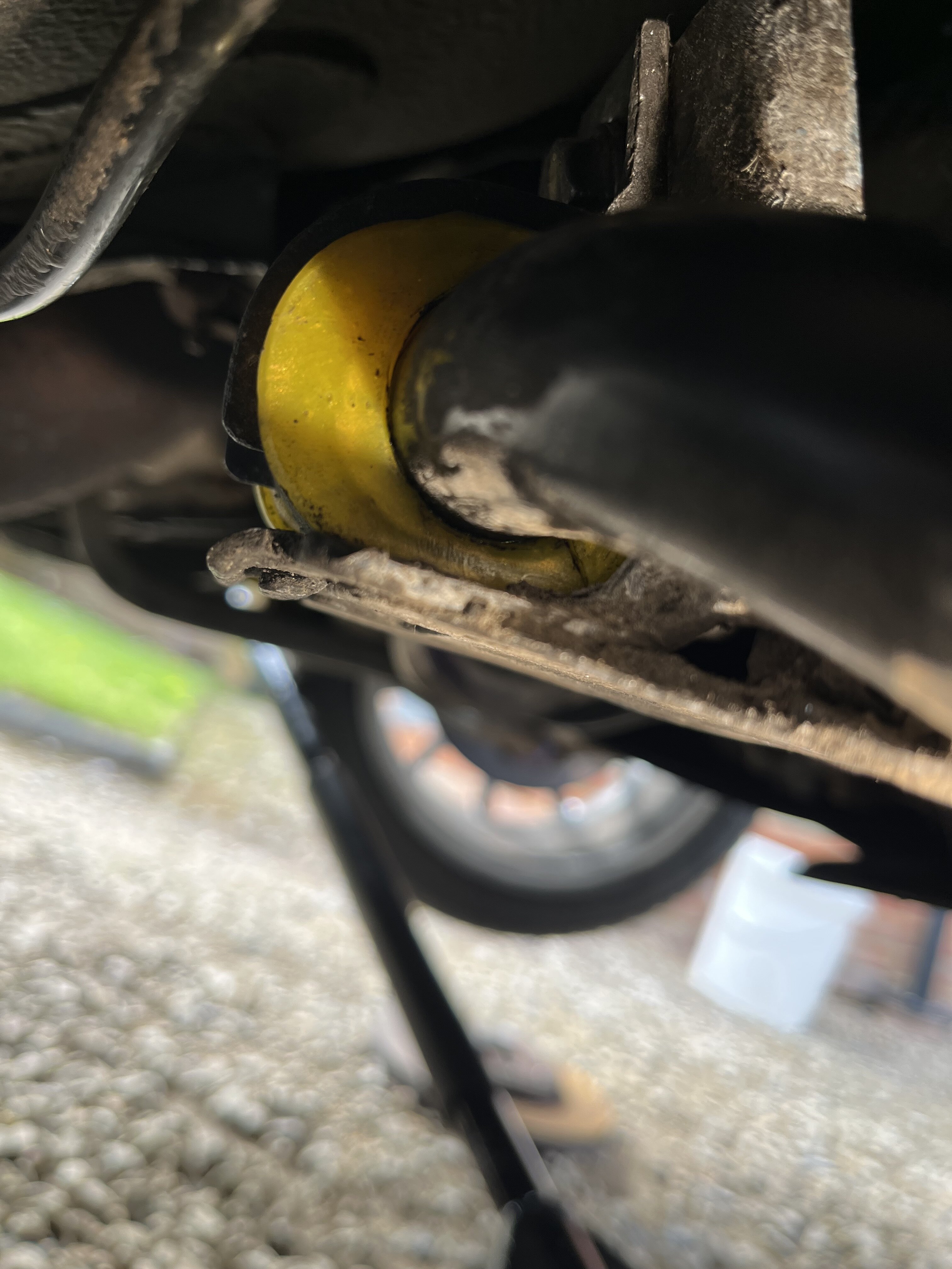

Checked arb bushes and i’m greeted with this. They must have gotten out of shape when brackets tightened. Not sure why this has happened. But i’m pretty sure this the noise unless someone tells me this gap Is normal.
Is normal.
You sure the outer brackets are still intact?
You have a thing about those outer brackets 😂 yes they are fully intact.
Noise isn’t all the time, only over rough uneven ground.

Rotated bushes this morning, done it in a hrs now i have the technique right.
Put some pressure on the arb whilst in the air, bushes now all good but…..
f**king PMS topmounts. Wasn’t the arb after all.

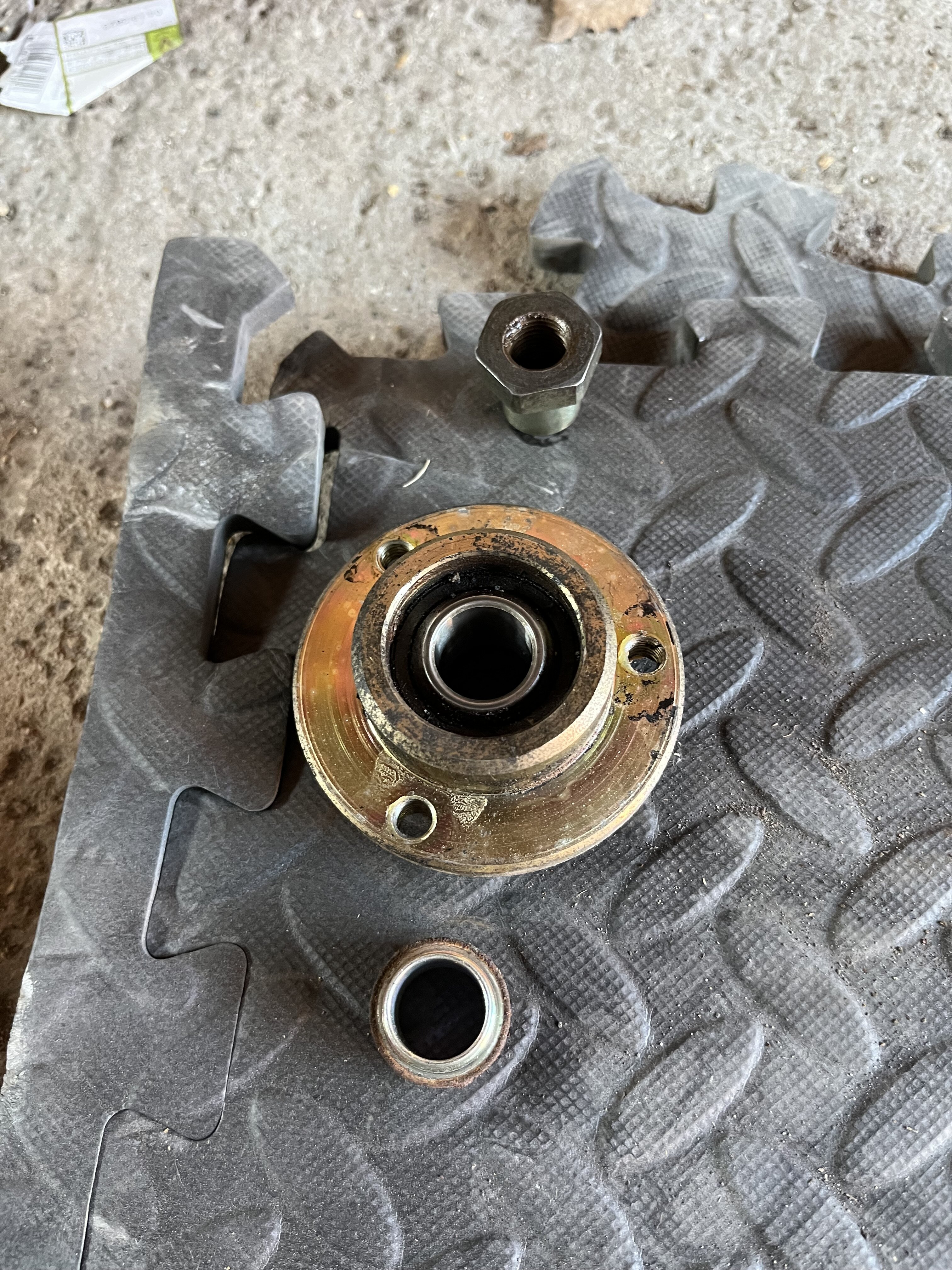

New top mount bearings fitted today. Old bearings were shot.
Much better. Still get the odd rumble over really rough surfaces but still much better.
There is zero play/noise in front end no matter what i put under load whilst on axel stands.
Nothing else to replace other than rack bushes which i will do in a few weeks.

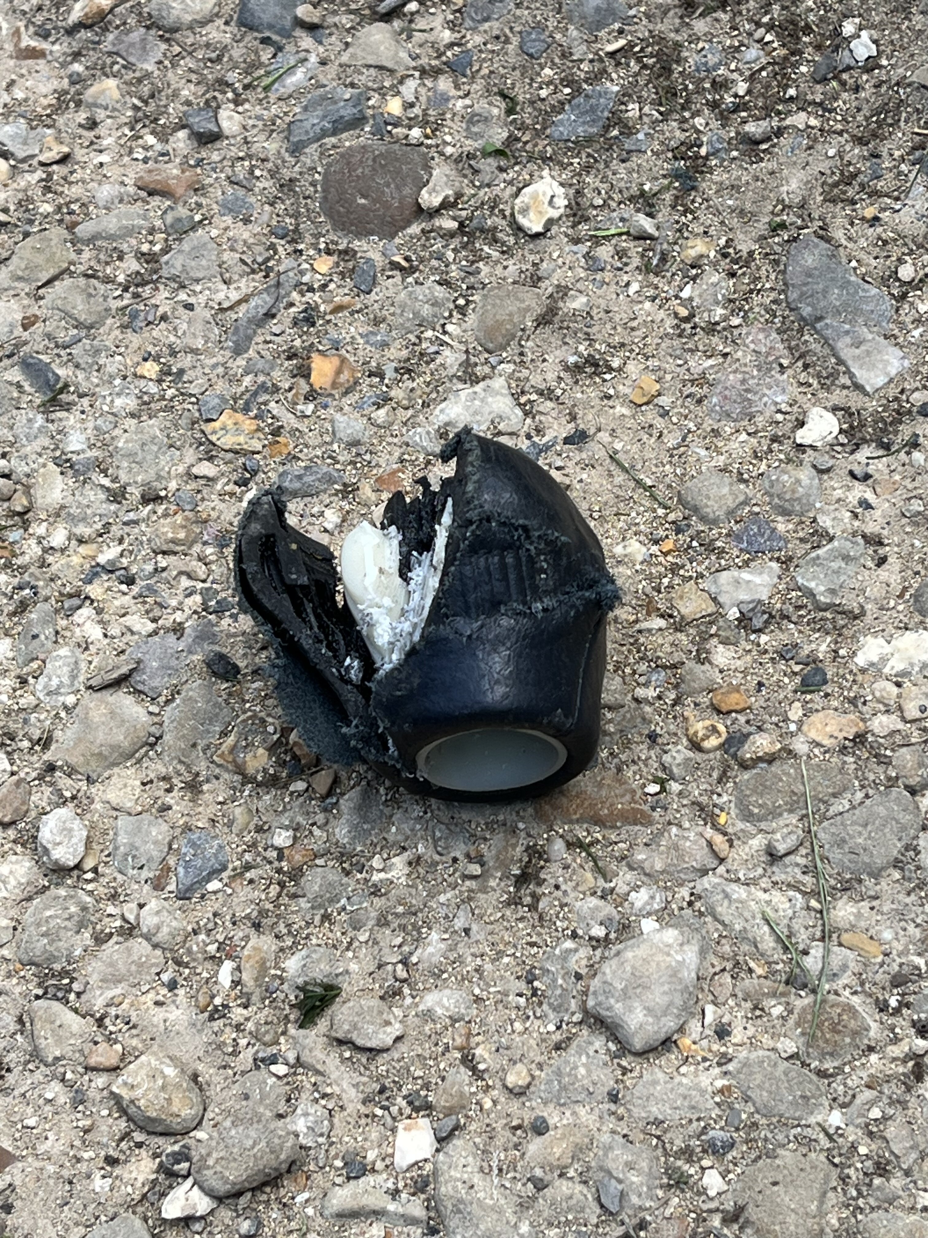

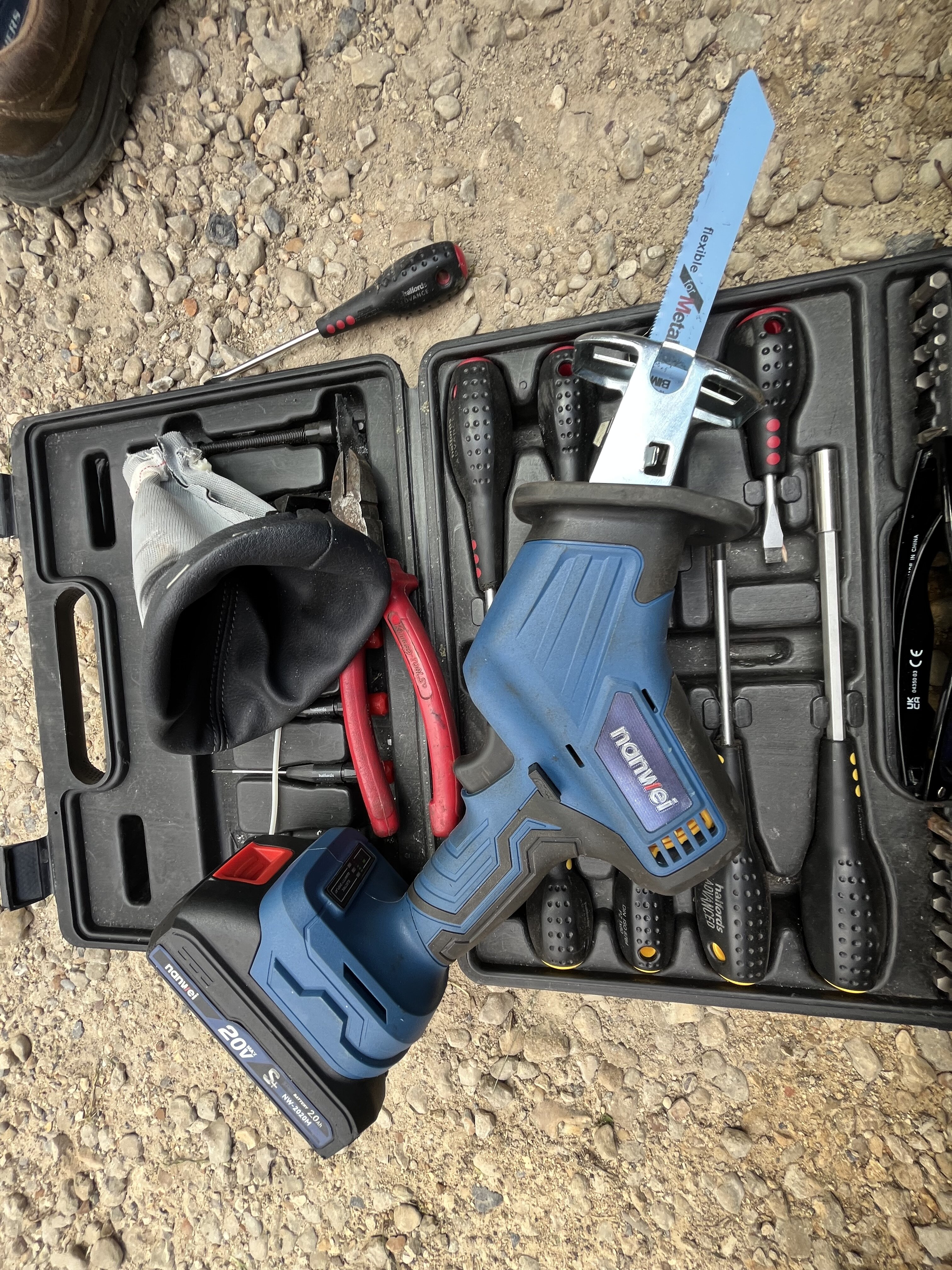

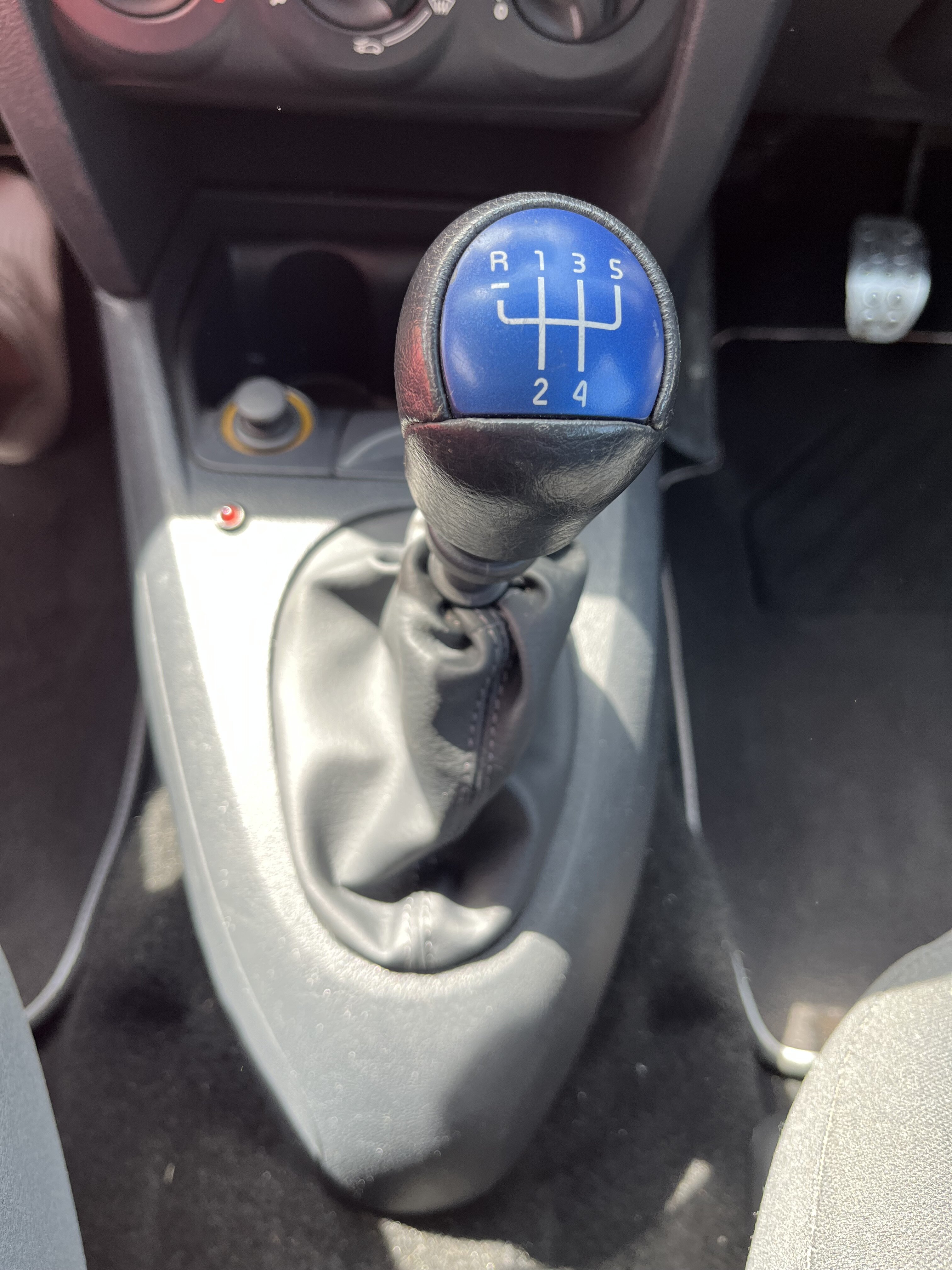

Some spare time this morning to remove old gear gator as the clips on the plastic cage had broken.
Didn’t want to replace the gear knob but i knew it wasn’t going to come off without being cut to shite.
Guy on here was selling a good knob with the original blue top and original print rather than a ebay decal so it was decided.
Tools….
Old knob removed
New gator and knob installed. Job done.

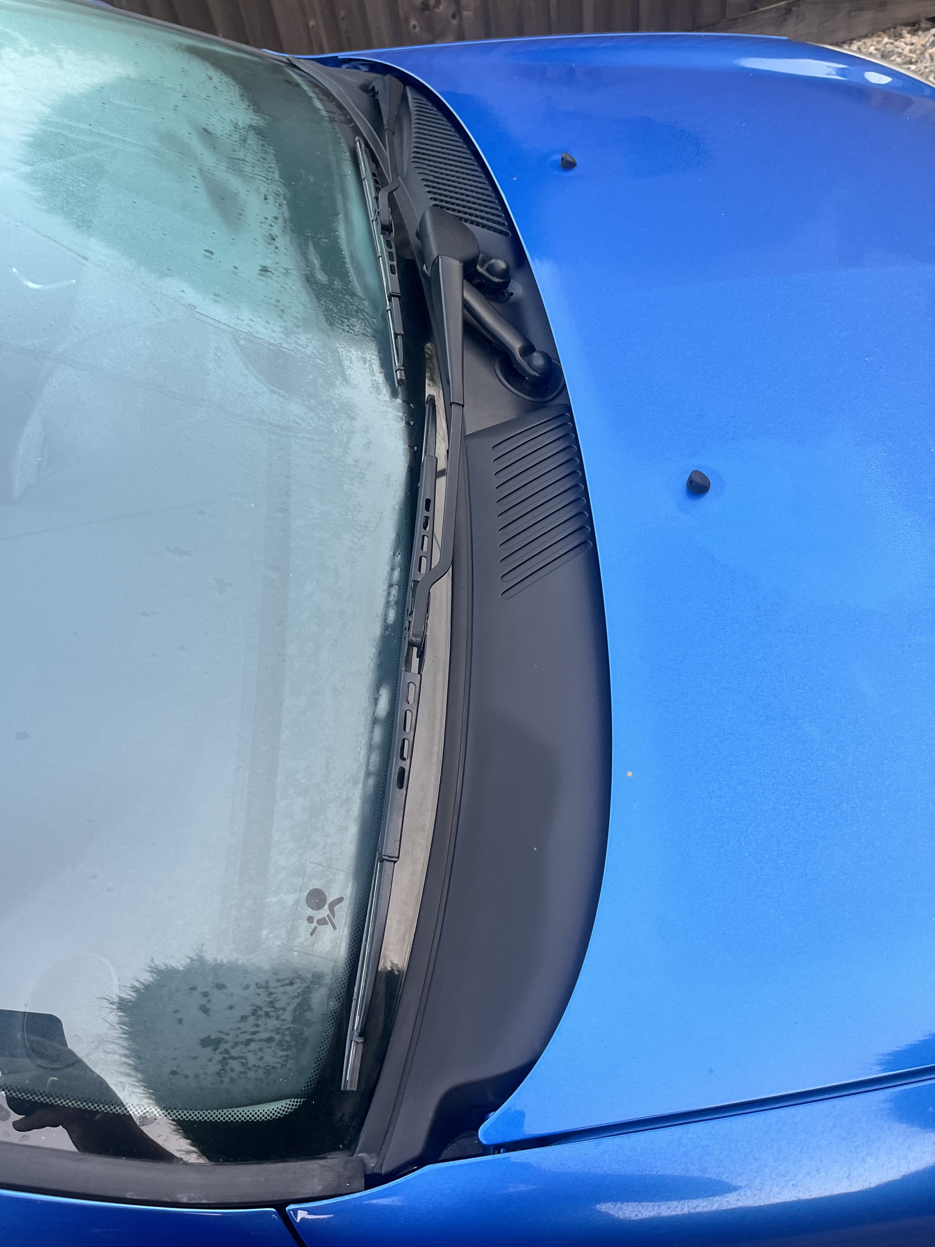

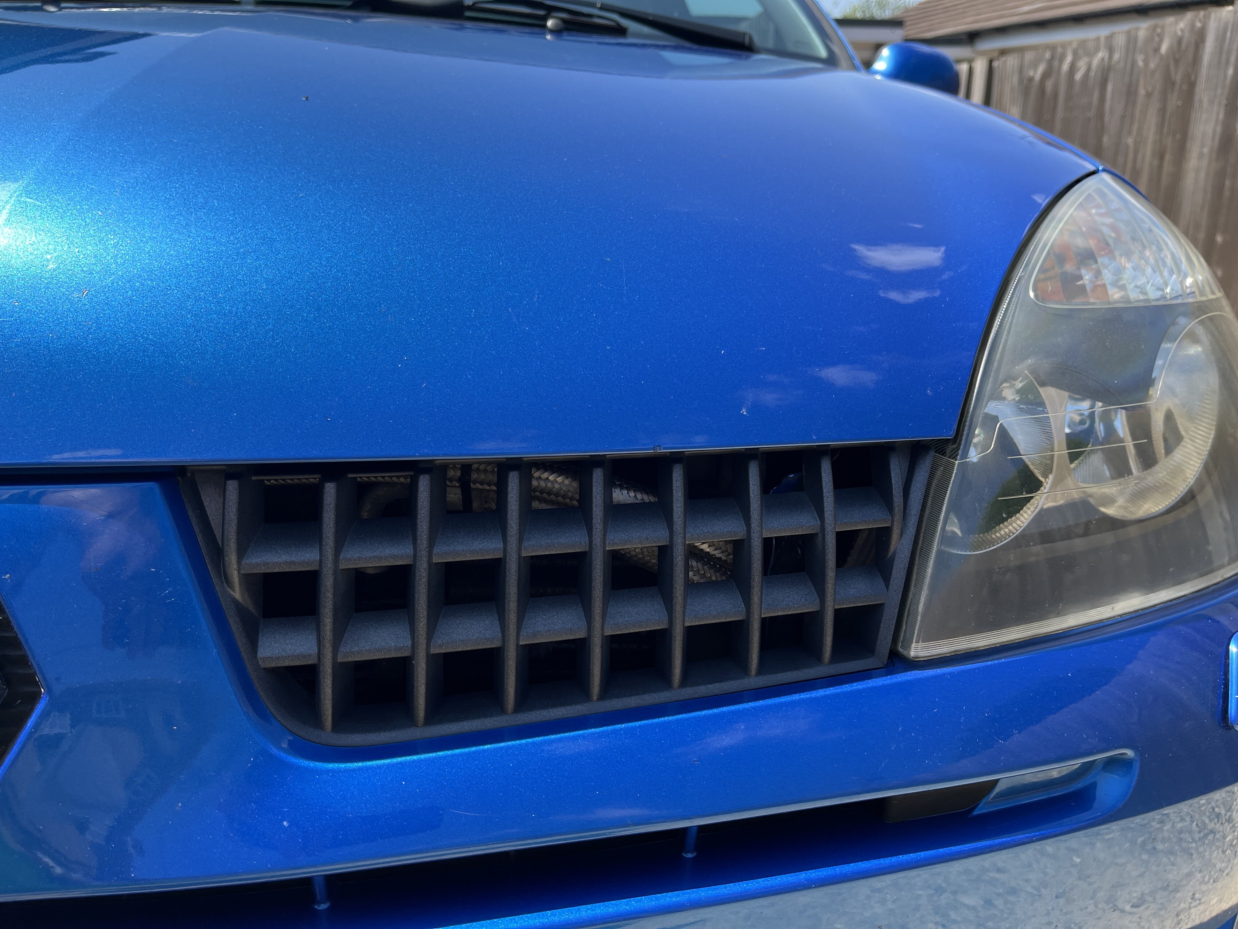

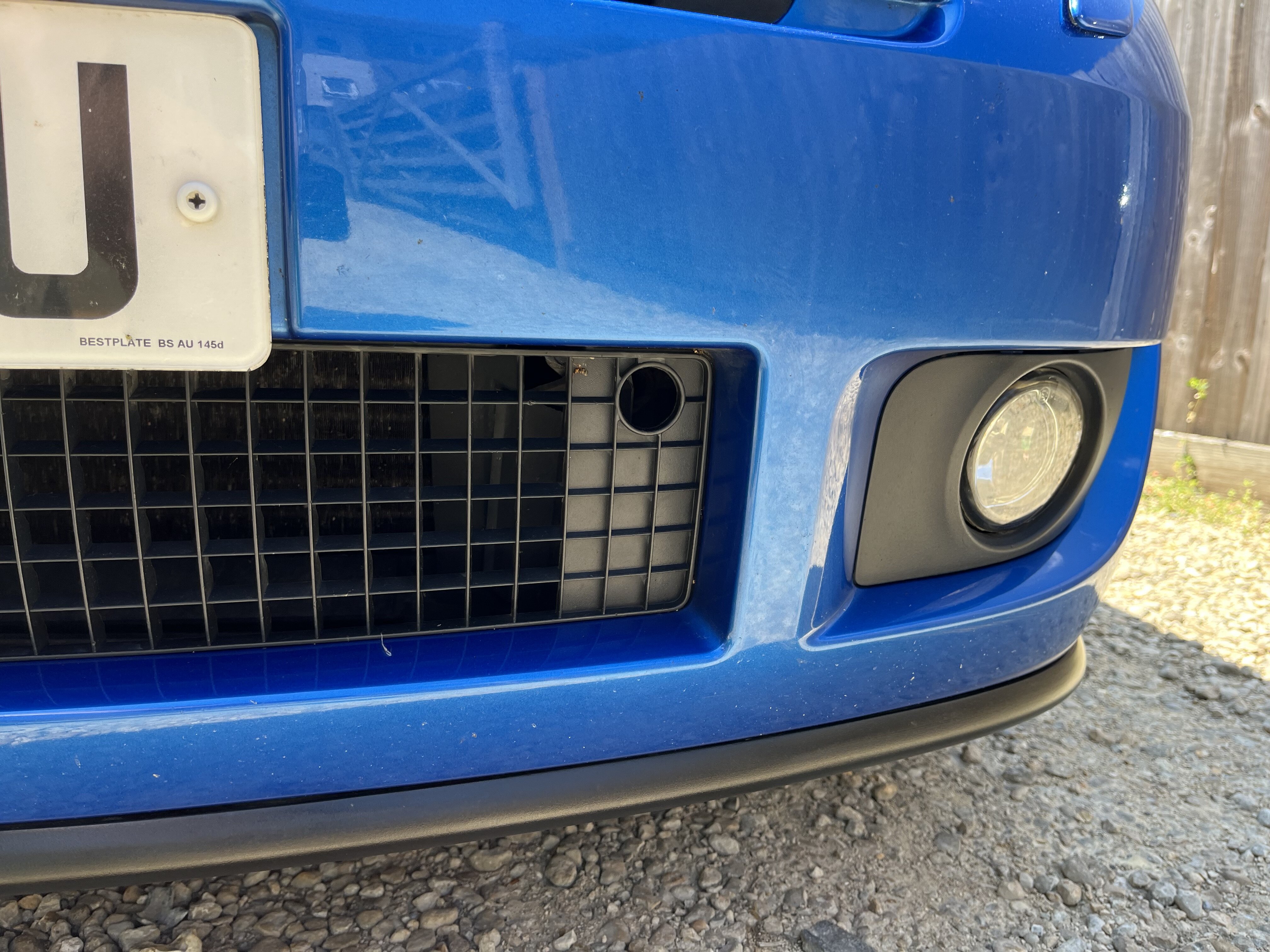

Spent the morning trying to sort 3rd brake light. Sadly it’s a no go and tbh, the previous owner damaged the outer casing so I would be replacing it anyhow.

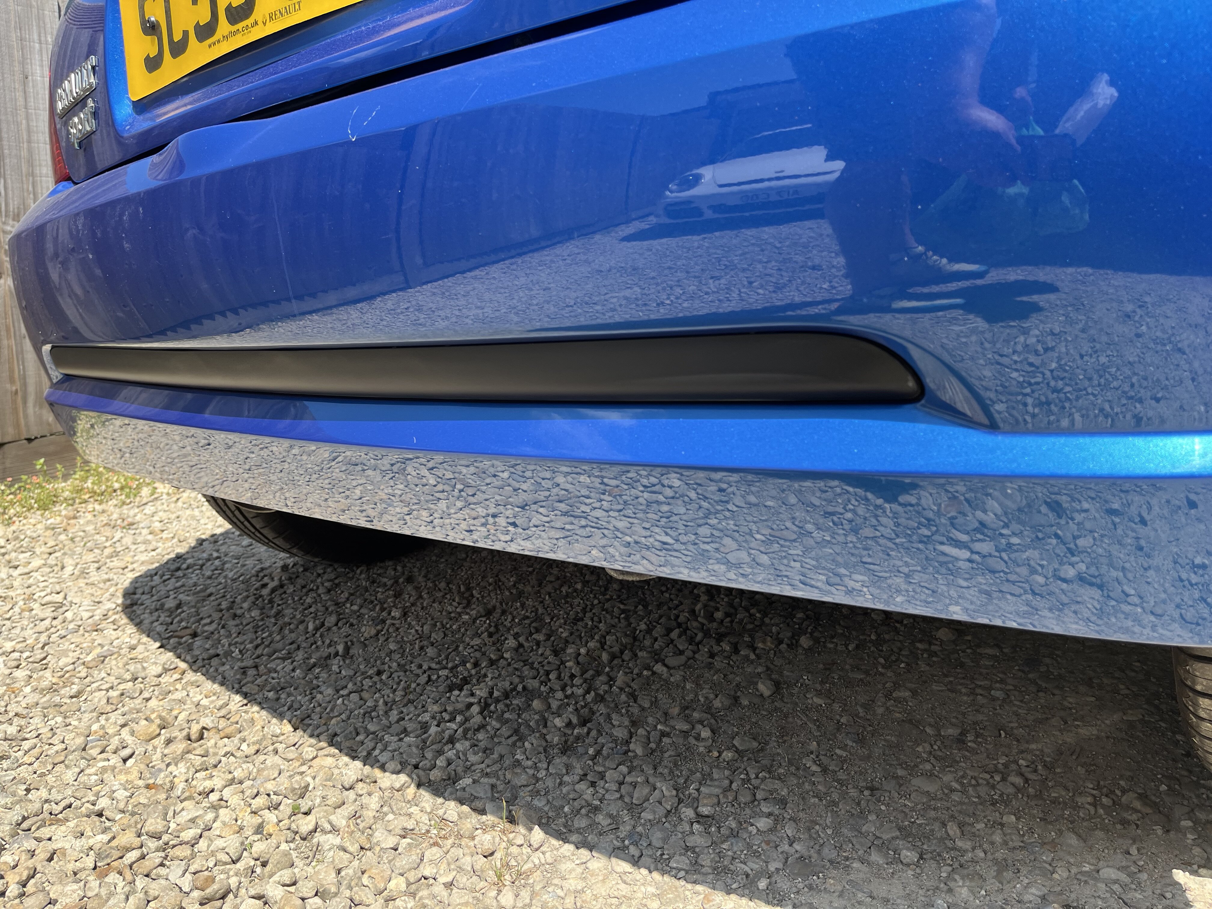

So moved onto cleaning up all the black exterior trim. It’s tedious as f**k. Especially the lower bumper grills.
Cleaned, degreased, panel wipe then applied Gtechniq C4 trim restorer.
No before just after pics.
