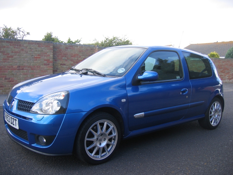

Quick pic from Google,
A (what looks to be standard height 172)

Will compare to that photo when my Mrs gets home with the car.
