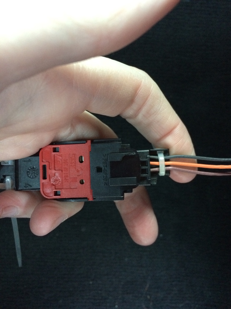

which of these wires do I bridge to turn the airbag light off...
Thanks
Well tried and failed airbag light is still on..... Help....
Anyone near Manchester airport, that could come and help me....
Will pay for your time pleassssse
Those cables are a red herring on a 172 Cup, pretty sure they're for seat airbags which the cup doesn't have.
I spent ages trying to track down my issue, eventually traced it to the squib ring in the steering column, pulled plug from back of column (accessible from top cover without removing wheel) and bridged the wires with a suitable resistor.
Exactly what happened to mine, and did the same fix ;-)
