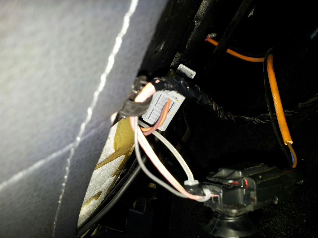

Ok so under my passenger seat i have this.
These are the only wires under the seat

No idea mate! I'd just sack the wires off and plug in the resistors like on that thread I linked!

Yeah. Plug in the resistors to the looms from the car as shown in -J-'s pics and leave the plugs from the seats unplugged.

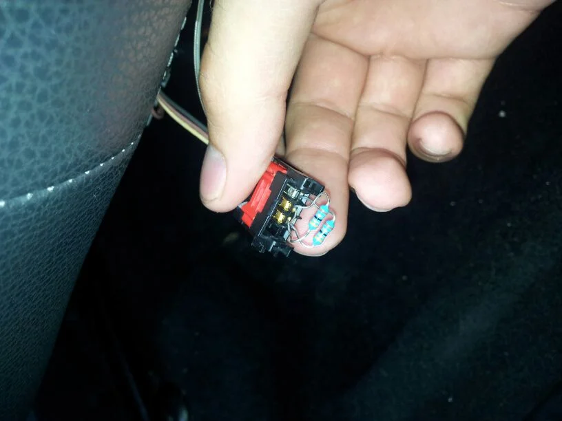

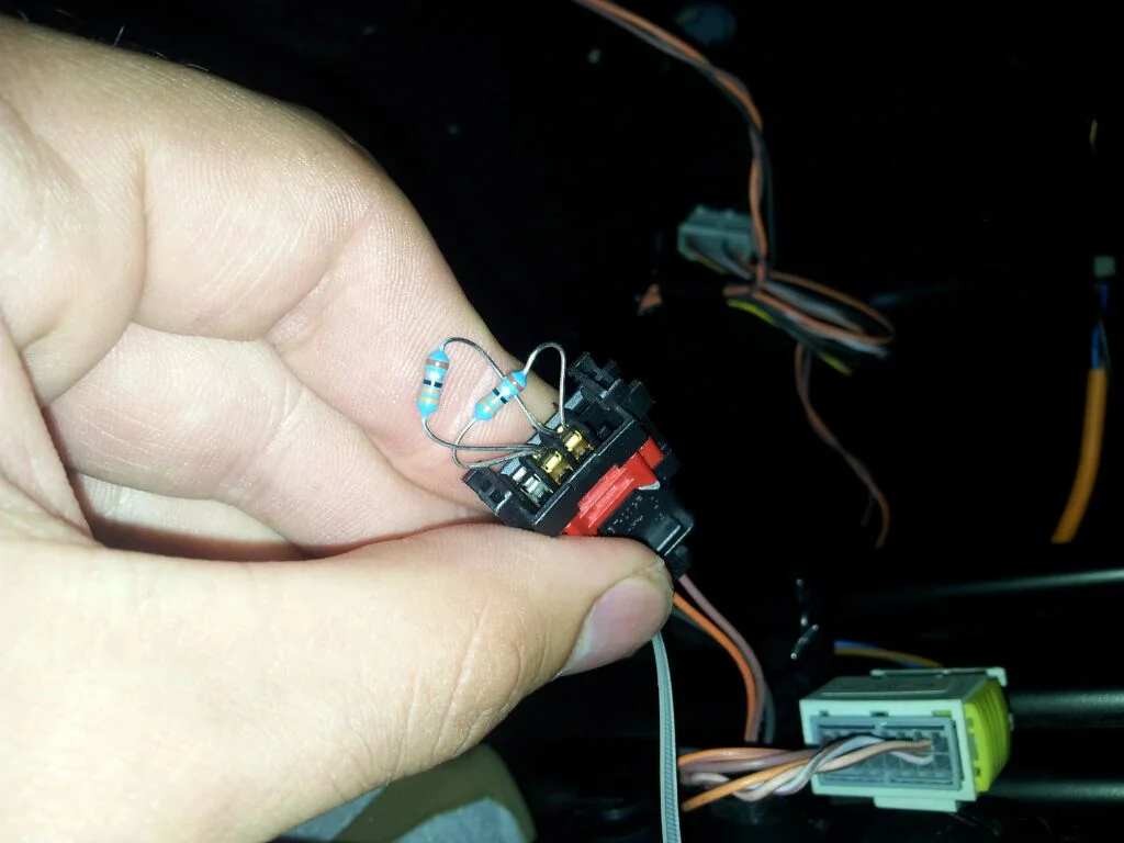

Ok so ive got some resistors and have attched them. But i have no idea if i have attached them in anything approaching the correct way.
Heres some pics, top is passenger side.
now i know i dont need 2 in each black thing i was just trying to eliminate the variables.
please help :)
