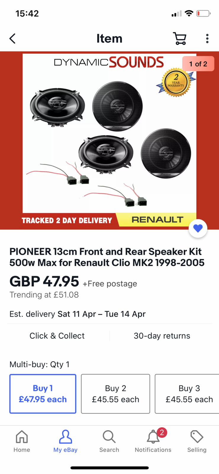

I am not sure mate I saw some pioneers which look good on eBay I figured that any aftermarket will be better than the shite that comes through the standard ones 😂

Thats good to know,as I said above I've never checked, I thought that they would of been the usual coaxial set up...
I presumed upgrading the door speakers and rears would make a difference?
You've still got the same signal coming from the HU tho... Yes, possibly slightly better but it's really not worth it. A 10/13cm paper cone on the door card isn't ever going to be ideal.
Set the LPF to 80 or 100hz and see if it sounds clearer when a bit louder.. Obviously that means there'll be less bass (if that isn't obvious, do some reading on low and high pass filters!) but it'll prove my point.
If your speakers are dead then replace them, btw.
If not.. a sub will be a far better investment. Twas all I ever did in my Clio and it was more than enough !
Once the fronts aren't having to deal with the low end stuff they're never designed to do, they come alive !!
Unless you're going to add an amp to power the new speakers, you won't really get much of an improvement unless the original speakers are goosed.
Most aftermarket speakers aren't as sensetive and require more power to get moving.
Start sound deadening too. If you want new front speakers dont mess around and go 6.5" fitted with mdf rings and with separate tweets.
I have looked into this myself and concluded that the standard speakers are actually good. The best way to get better sounds is to fit an underseat sub. I'm hoping to get a Kenwood one soon.
