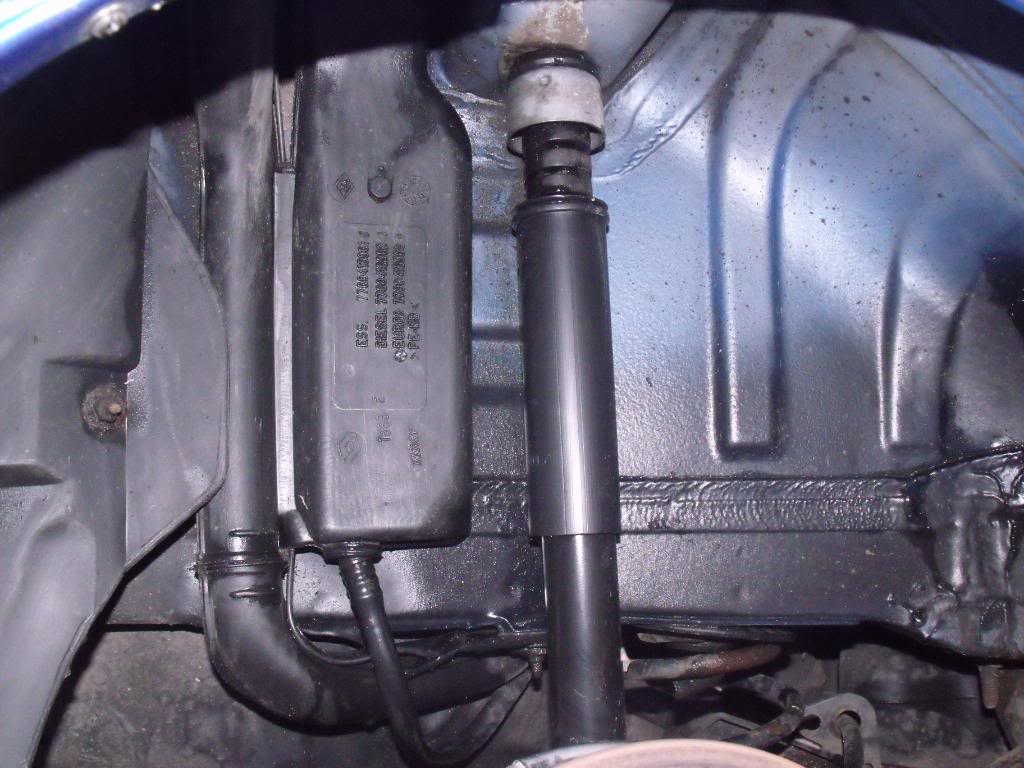

id recently replaced the rear pads and discs and rear shocks (all genuine Renault parts) and the plan is to keep the car as standard as possible.

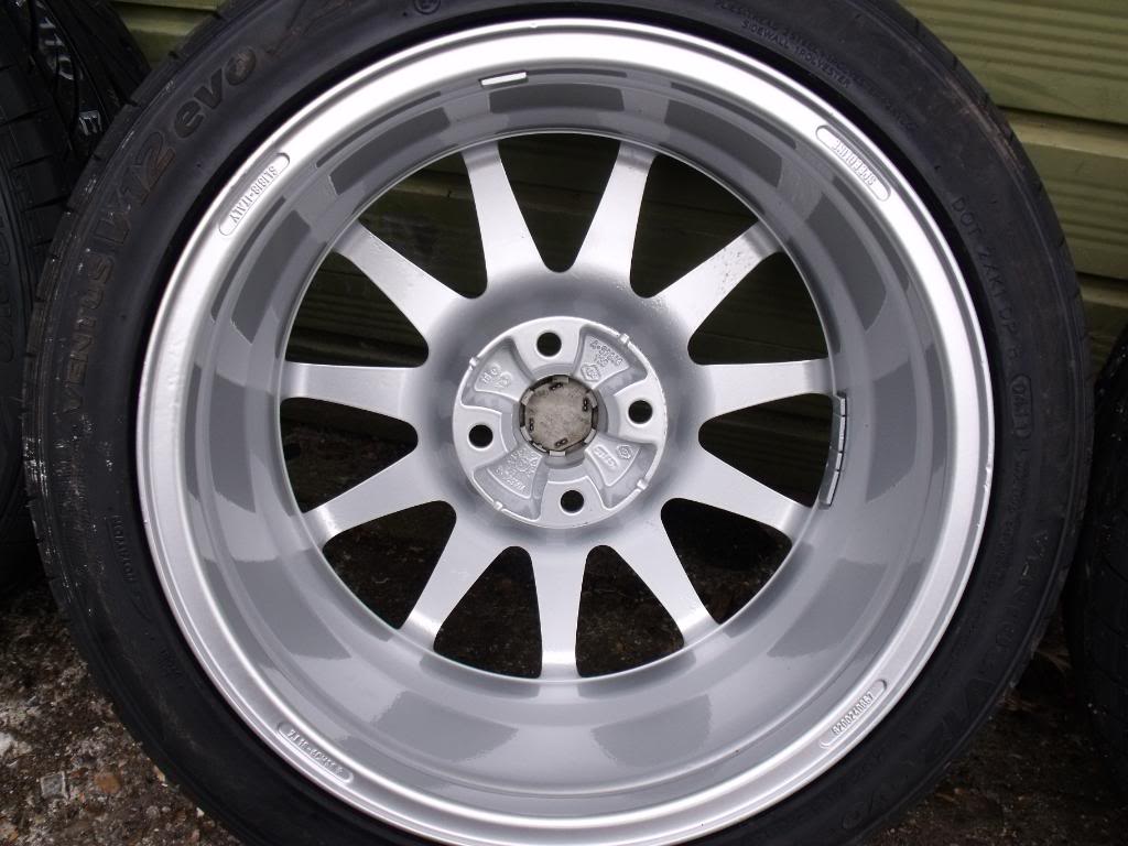

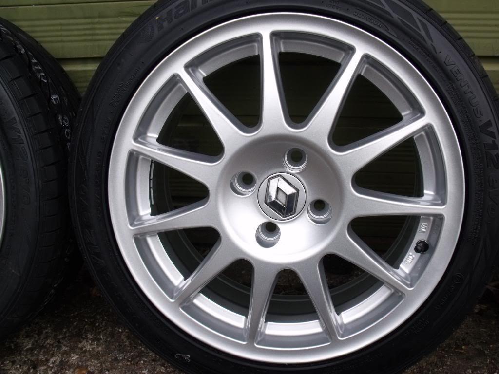

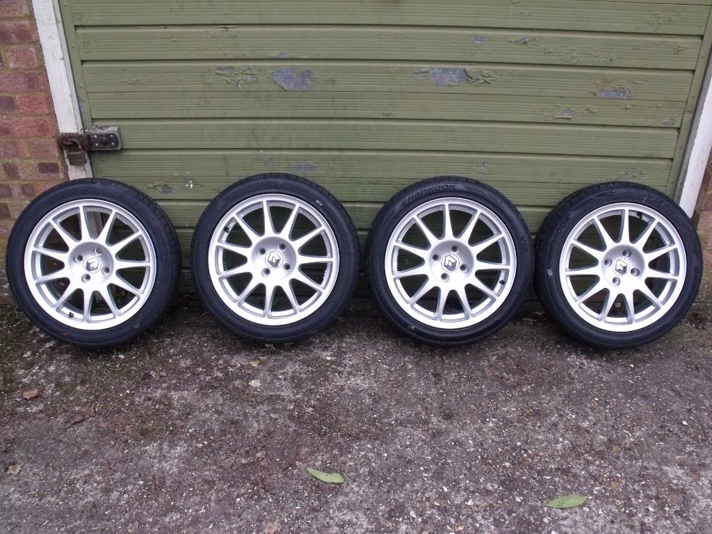

so 1st thing i needed was 2 new rear tyres, but as the fronts on it were some crappy 'Accelera'??!! jobbies and i didnt want 2 more of them on the car i thought i might as well replace all 4. After some research on here and other forums i decided to go for the Hankook V12 Evo's. Seemed to be the better all round tyre and so far i cant fault them. 2nd thing on the list was to get the Turinis refurbed, they werent too bad but wanted them looking spanking again so ordered the tyres and when they arrived sent the whole lot down to Wicked Wheels in guilford....

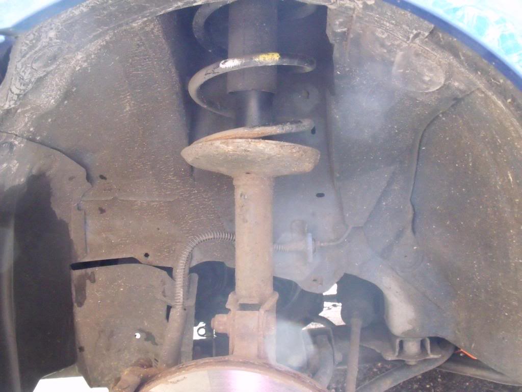

soo in the meantime i took advantage of the car being up on axle stands to give the arches a good clean and paint my calipers
before
after
used Muck Off and then treated arch liners to some AG vinyl and rubber care

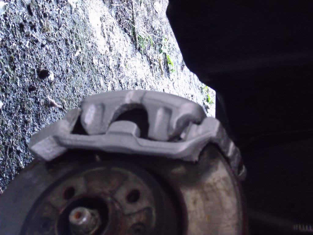

calipers next, decided to go for silver hammerite as looks clean and more 'OE' imo.
good clean 1st with wire brush then paint

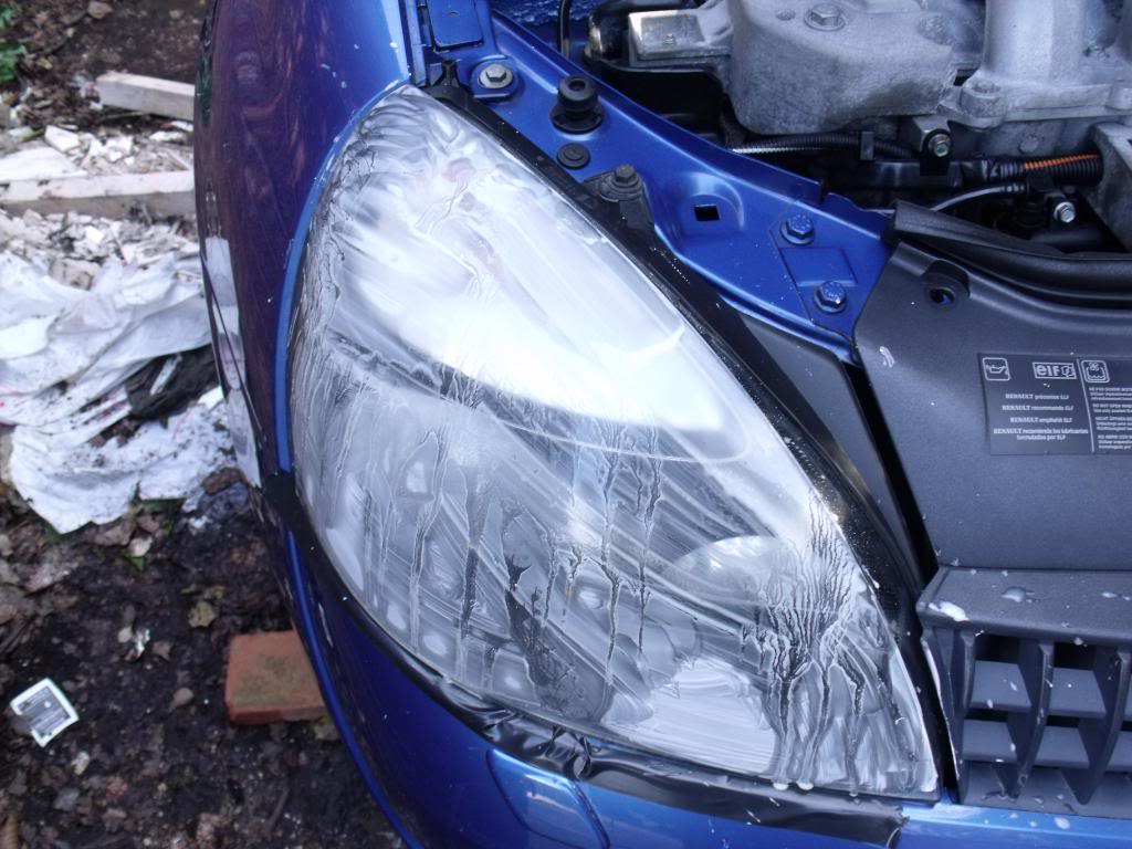

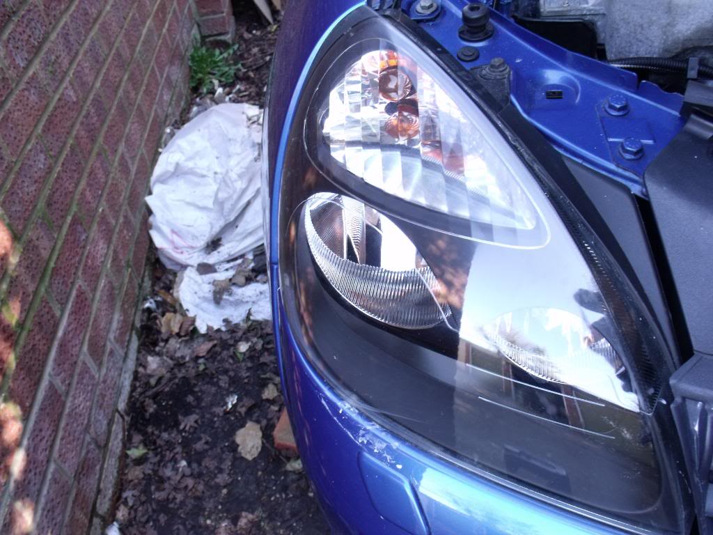

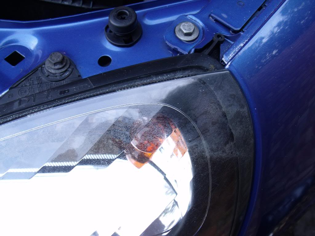

then after a much needed wash, wax and polish i decide to have a go at headlight correction as they were looking a bit scuffed
started with 1200 wet and dry, then 1500 and used Megs scratch X to polish by hand...... nearly killed me! after an hour and a half of polishing 1 light it came out quite well but didnt get time to do the other one, its on the to do list! might need help or someone with a rotary!
Wheels came back from Wicked Wheels, tyres fitted, balanced etc and was really really happy with the result! cheers to mr ******* for sorting that out!:star: (u no who u r!)

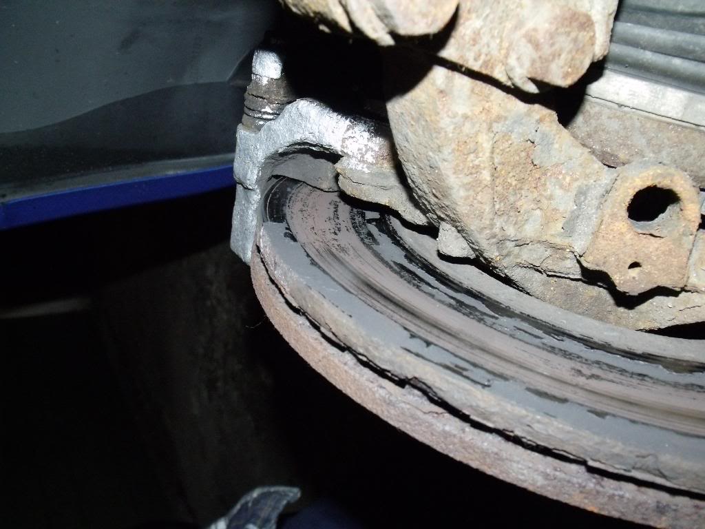

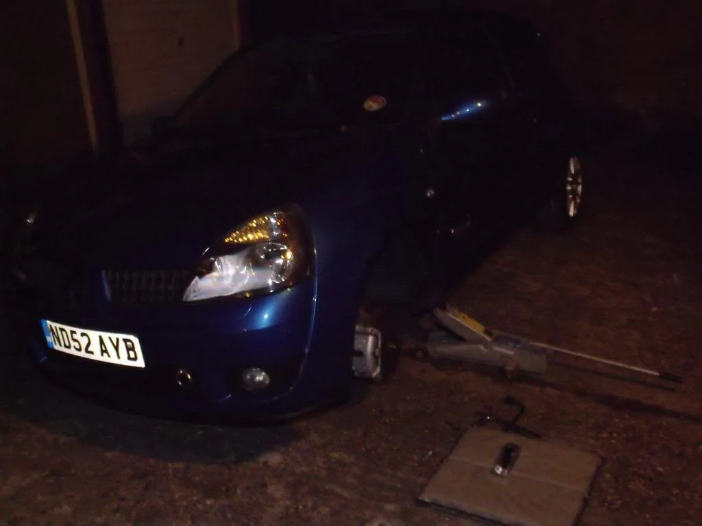

once id got the wheels fitted and with some new locking wheel nuts and new 17mm nuts(cheers nick172cup) just makes it all look nice and fresh:cool: took the car for a quick spin round the block to check everything was ok...... wich it wasnt! kept feeling a pumping sensation under my foot when braking and upon inspection at the side of the road, discovered quite a few fragments of metal on the inside of the alloy! so nursed it home and got it jacked up, 11.30 at night and feezing cold! to discover this was the problem.....
disc looked fine on the front face but the back face was completely shot to bits! next day ordered some new Brembo HC discs which arrived the day after and fitted striaght away.

yeh thats the 1 m8, the pink stuff in the bottle. also used muck off brake cleaner on the calipers/discs before painting, top stuff!
