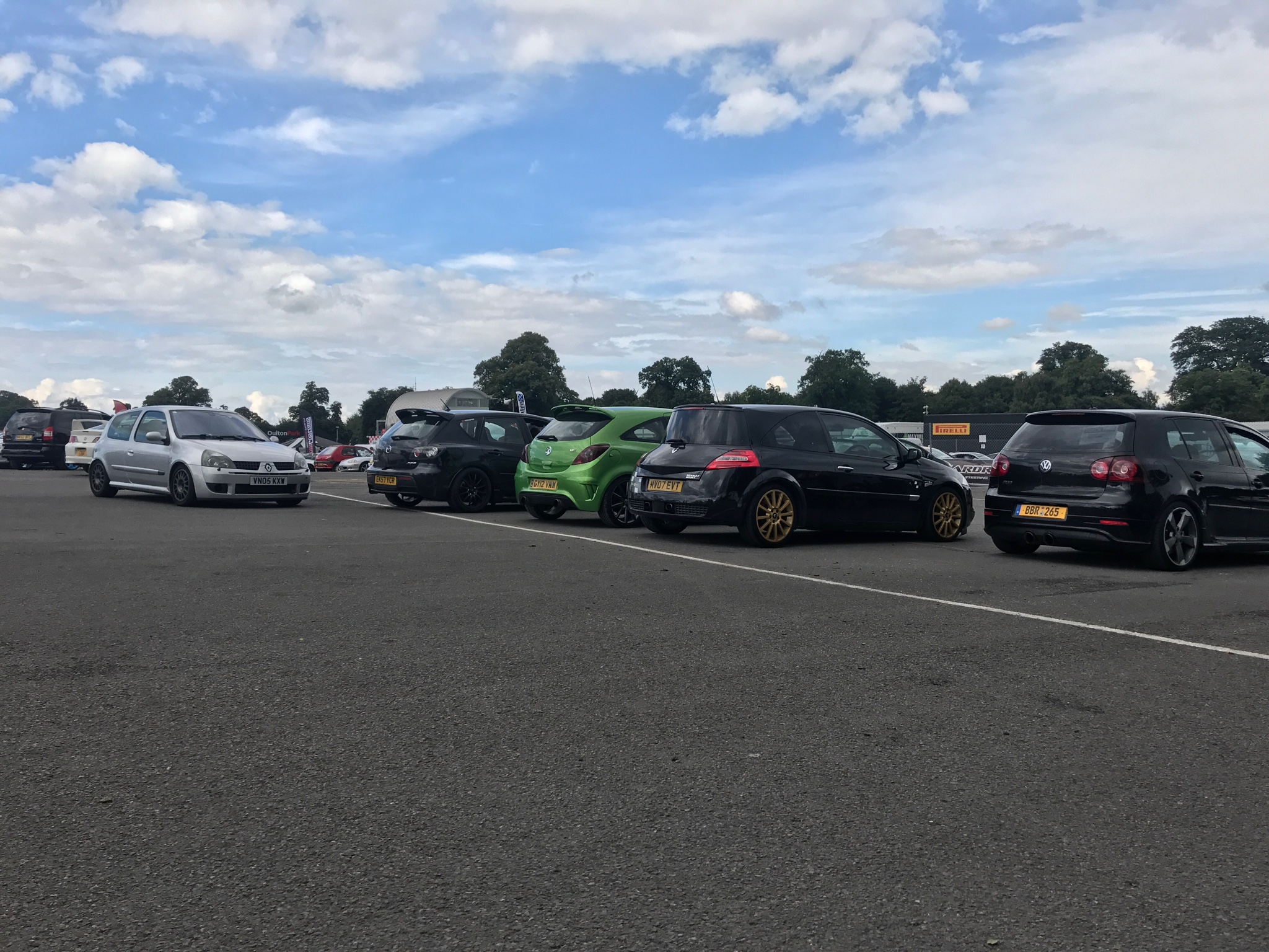

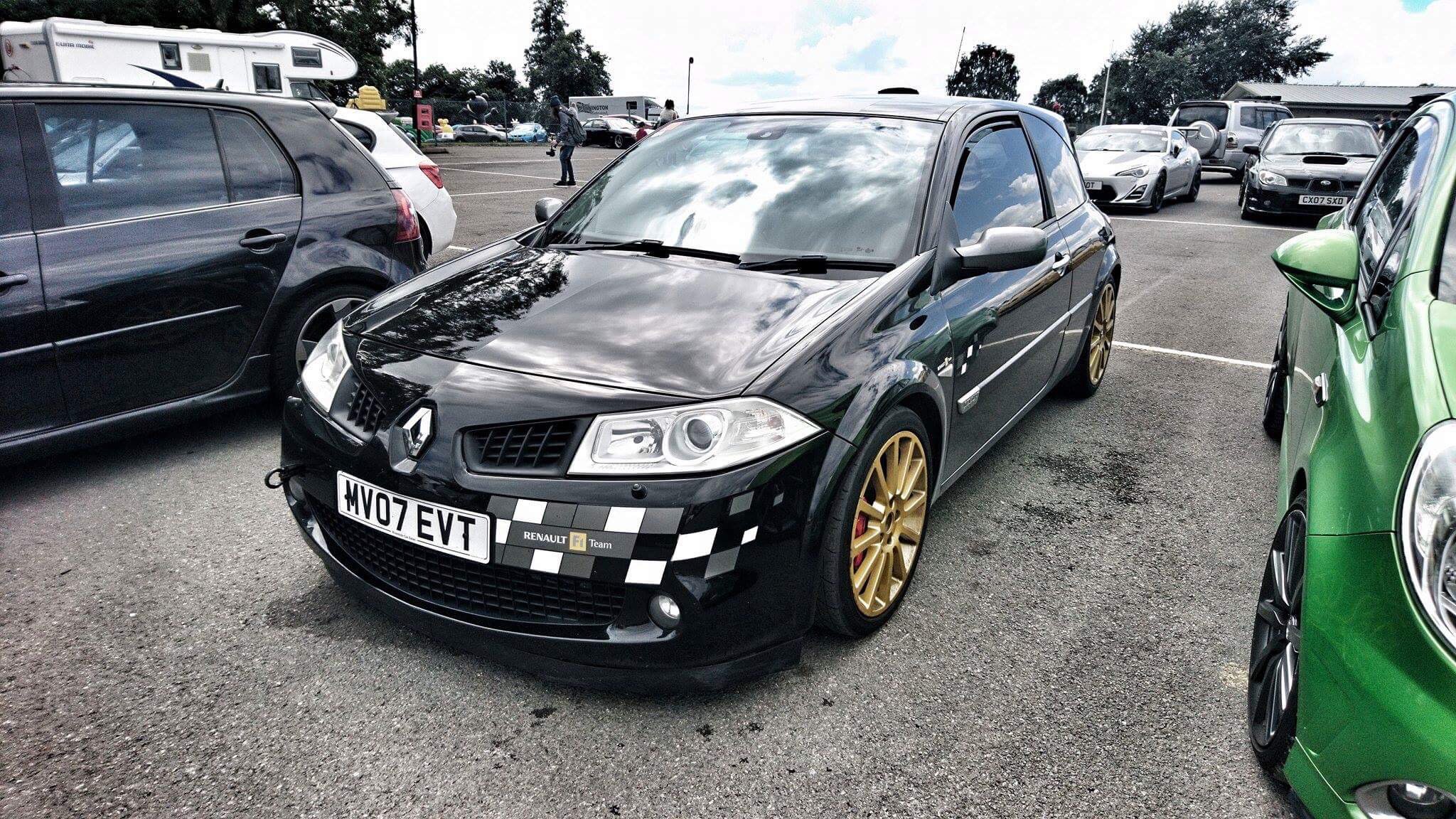

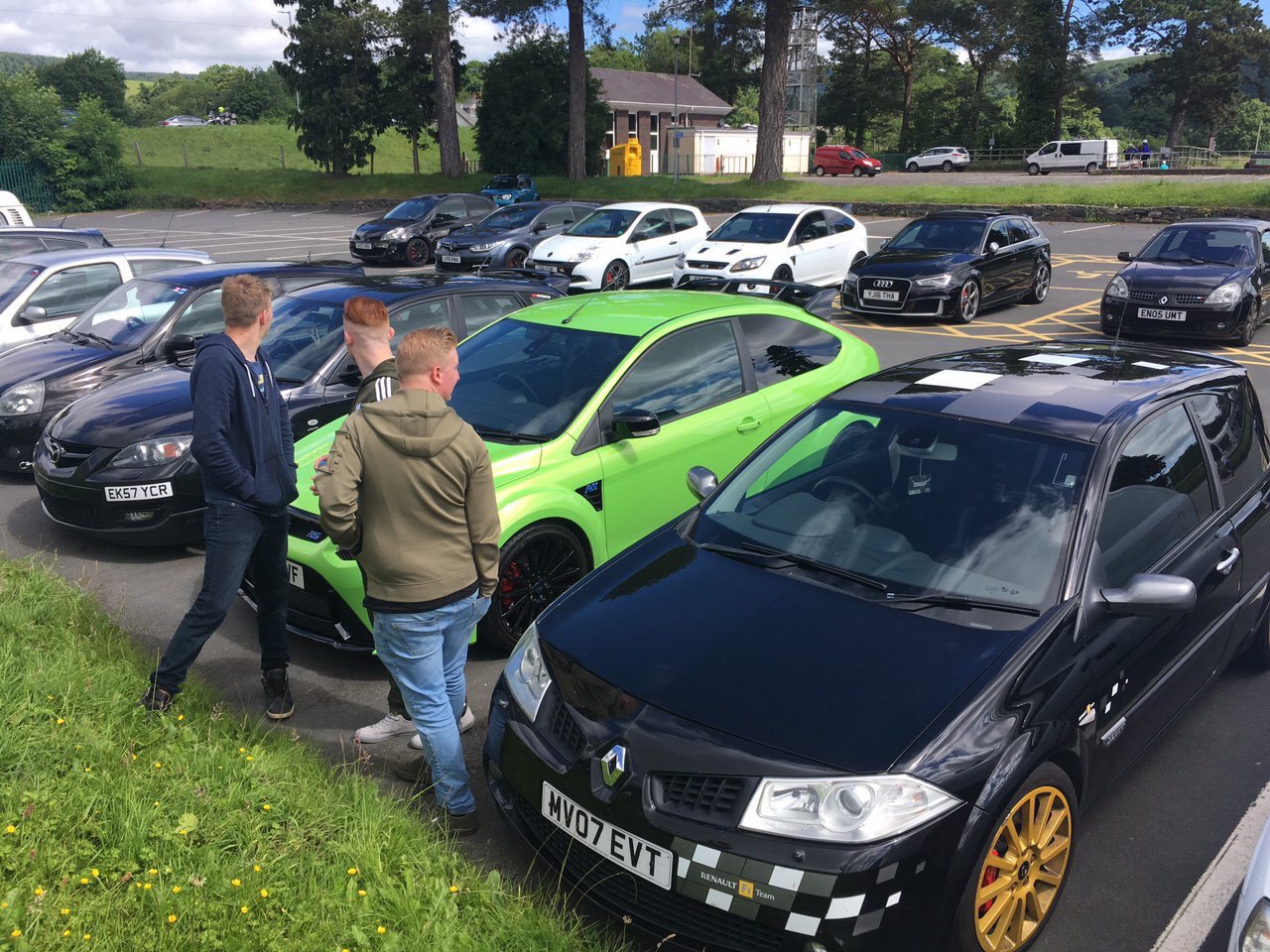

ATE 200 Brake fluid made a difference to the brakes got rid of the fading but the pedal still doesn't feel brilliant so next job is front pads.
Got a good testing at weekend on the drive round the evo triangle and round Snowdonia with the club [emoji106]
Pic stolen off Stockport Lee

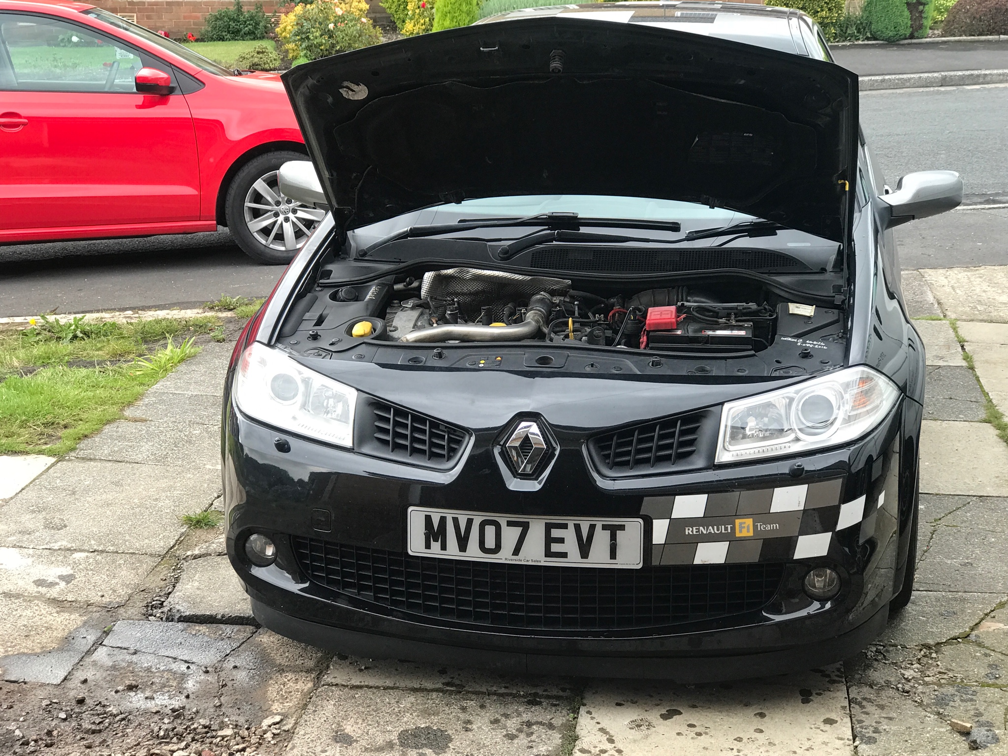

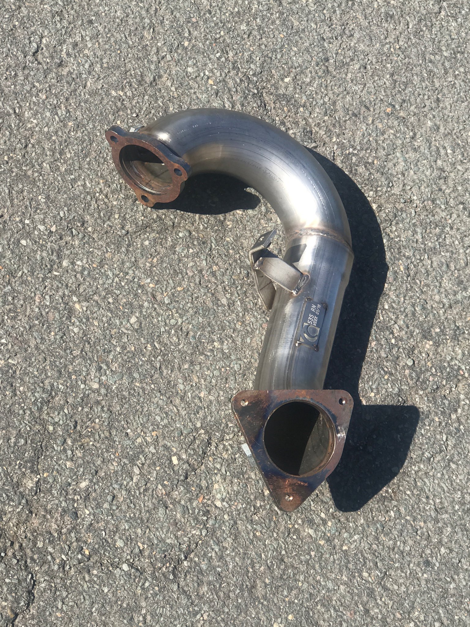

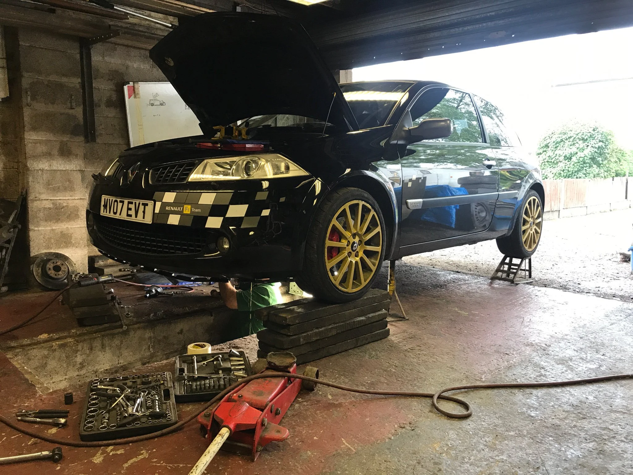

Anyhow being out and about with lots of louder cars made me annoyed with mine so today I've been to a scorpion dealer to pick up an RS240 3" decat pipe. Couldn't be bothered waiting for postage as I want to try and get it fit tomorrow.
Will upload some pics and hopefully a video tomorrow if I get it fit within a day lol..

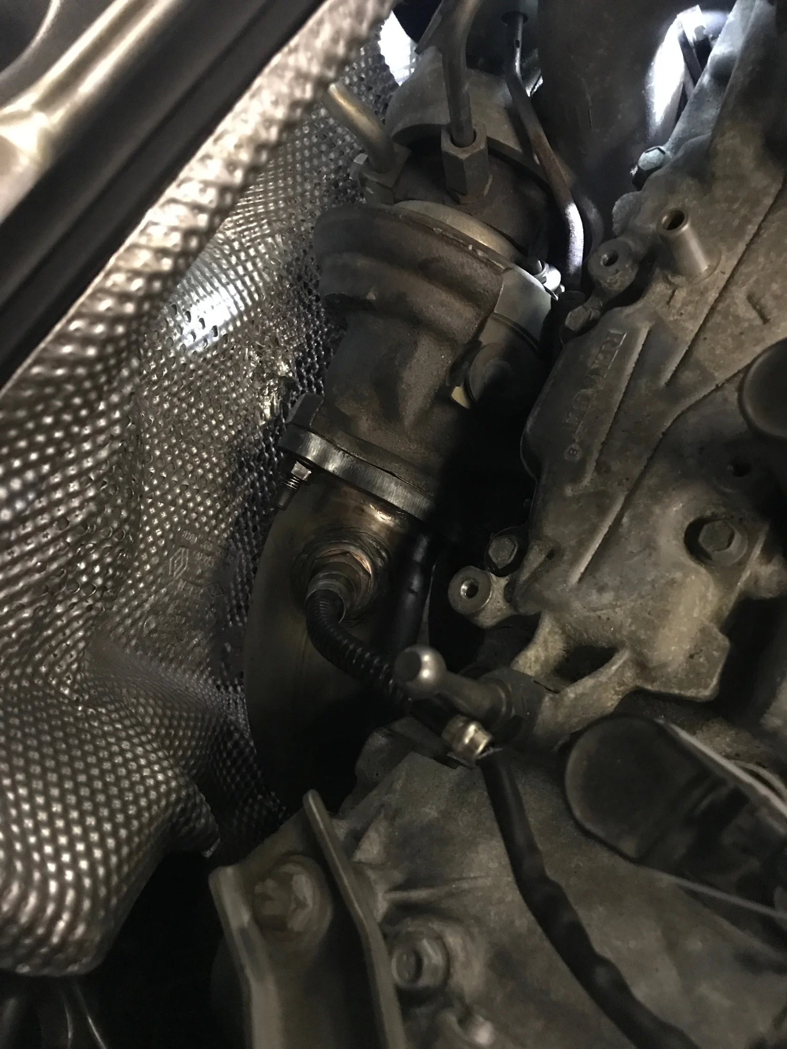

Good luck, worst job I've ever done on a car fitting a decat to my megane.
Worth it though.
Haha I've been told mate I've got all day and a pit and a friend with patience; from reading if I take driveshaft out and pull the engine forward off the mount I should get it out easier. Gives me chance to check my cv joint as it's got a clicking noise ATM. I know it's worth it, just to be double safe I think I'm gunna book it in at RS tuning for a tweek and hopefully some more power, been thinking about getting 630s stuck in too when I'm there so if they have them in stock I'll just decide on the day.

If you don't want the cat anymore, just cut it out. Comes out much easier then.
I was thinking that bud only gunna get weighed in anyhow along with the rest of my collection lol, hoping they'll all pay for the decat [emoji23]

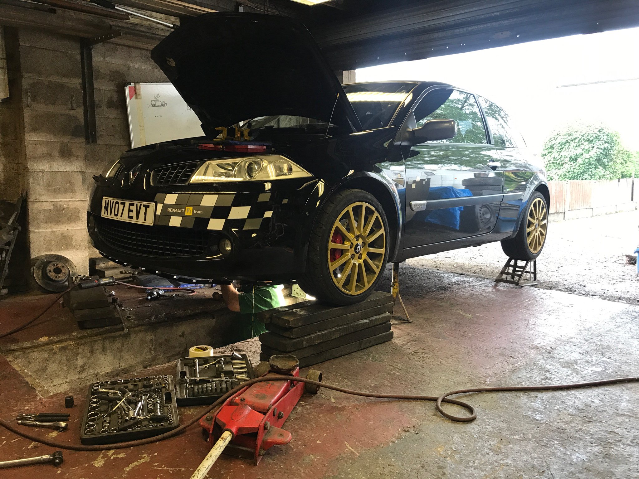

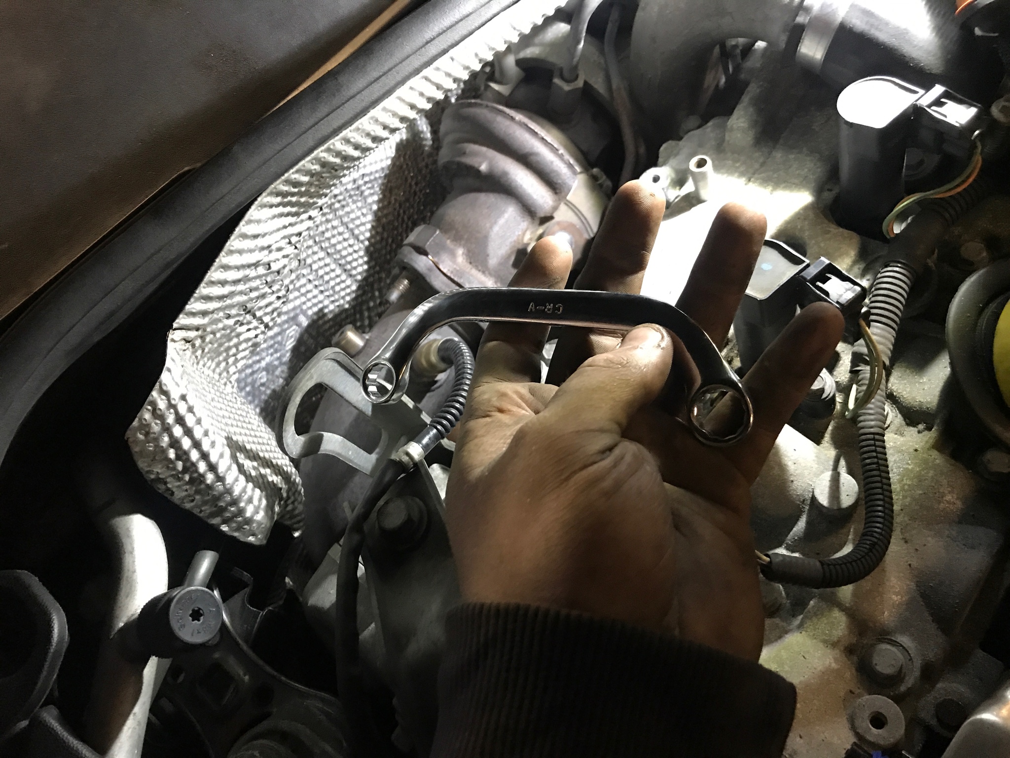

Wow what a shite job lol, 6 hours including driving round for an hour looking for C spanners and a dinner break.
Sounds mad now though, a lot louder than I thought it would be.

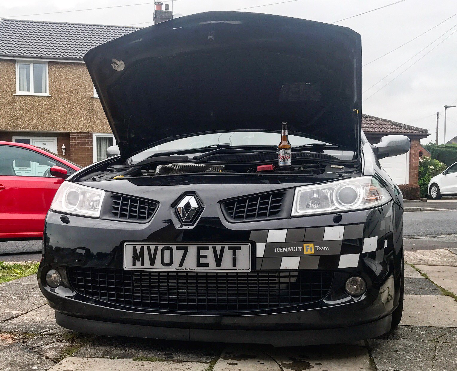

This car is really growing on me now, it's deffo the best car I've owned so far, clio close behind but yeah this is awesome. The noise is ace and the decat has made it a proper asbo lol.

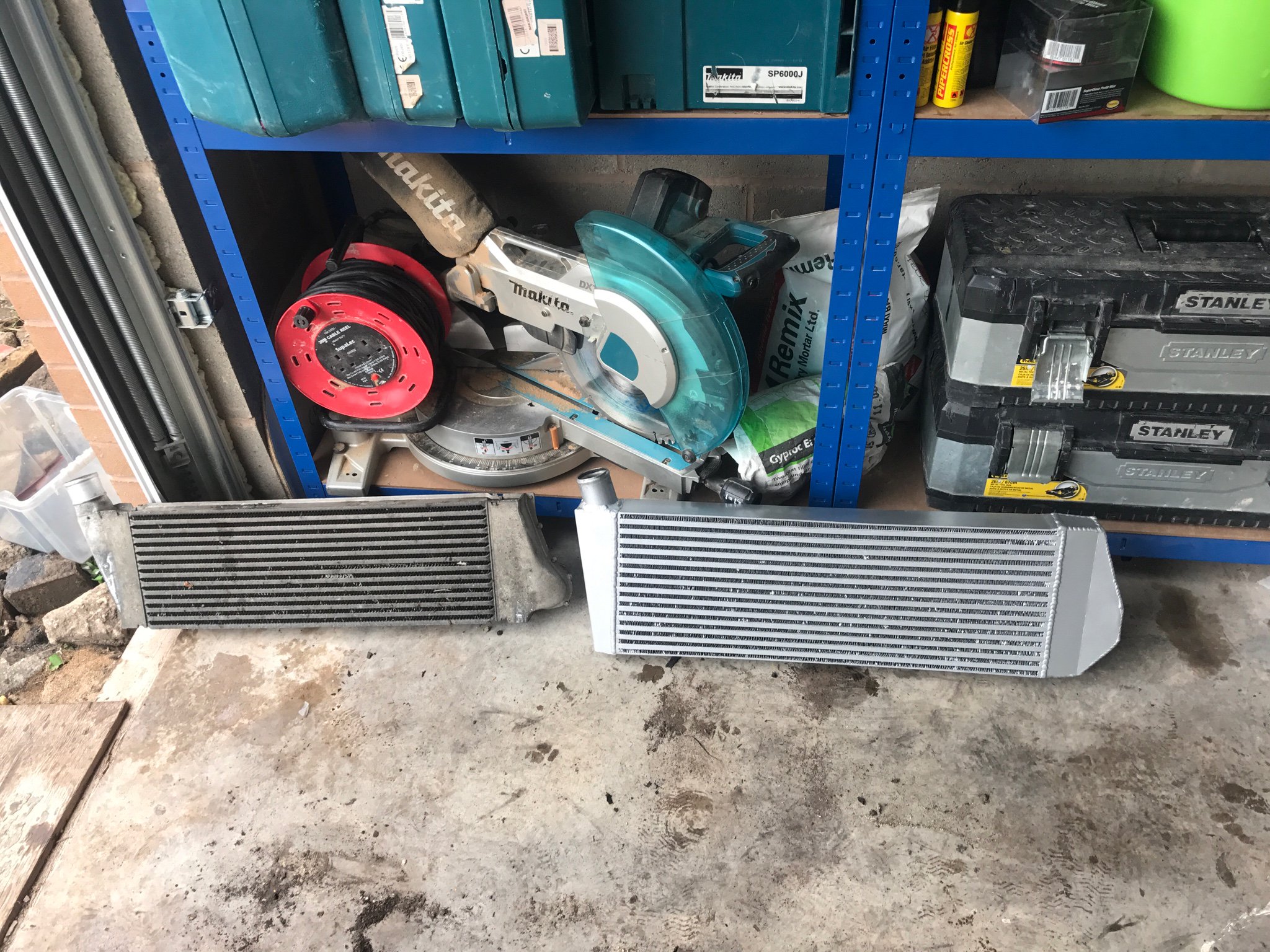

I was meant to have a cheap month this month with it being booked back in RS Tuning next month. But having bought a decat last week I've found a Gpi cooler locally so collected and fit it within an hour, nice easy job unlike the decat
Did a bit of pic whoring..

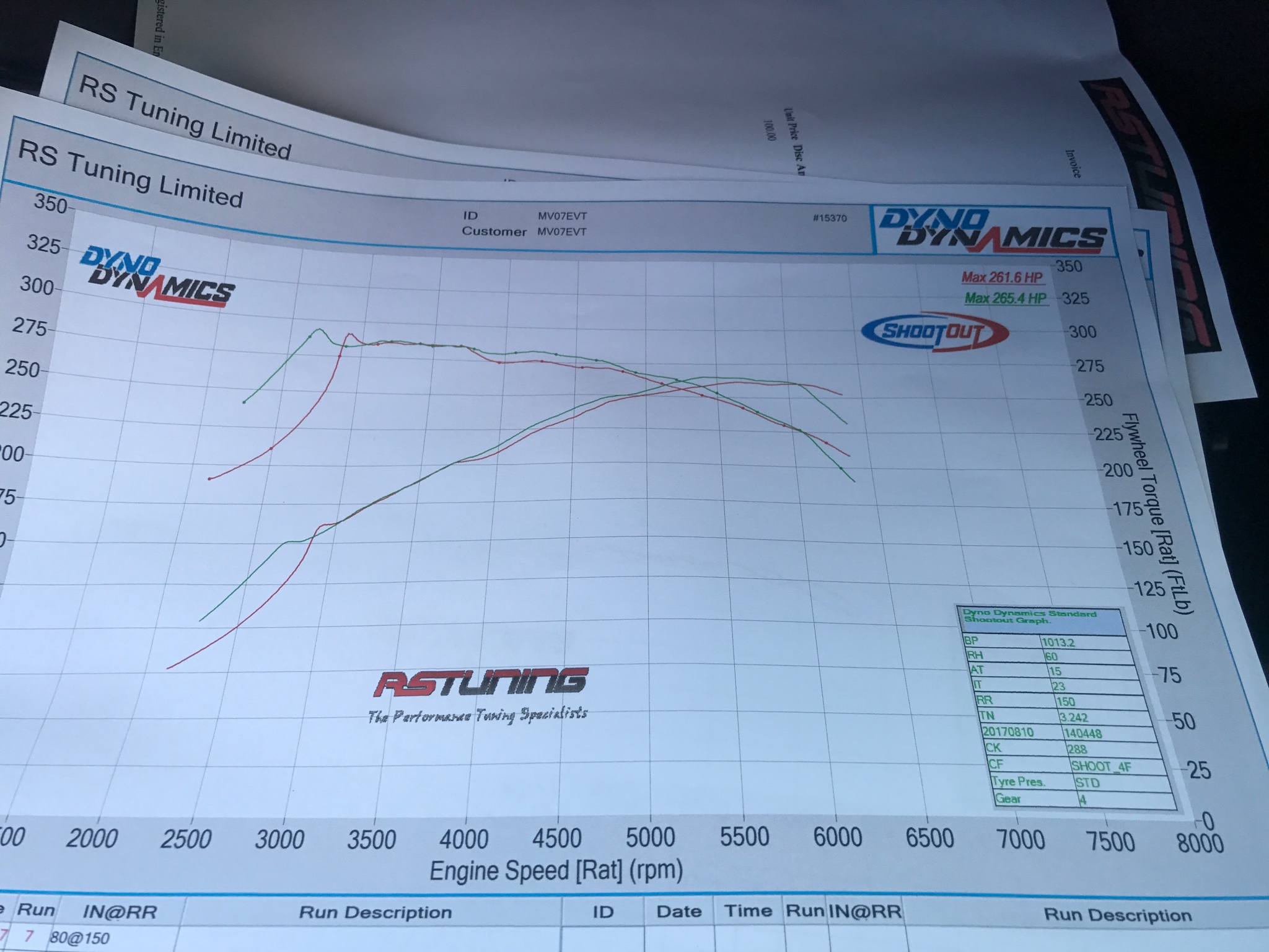

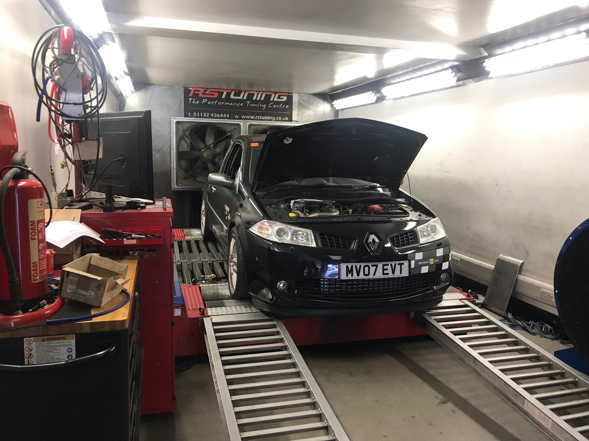

With me fitting the decat and intercooler I booked it in at RSTuning for the map to be tweeked to suit the mods, good job I did really as it was leaning out top end so it's running slightly rich now which I'm happier with as I've heard of a few of these with melted pistons, unfortunately the injectors are maxed now so will have to stick with the power it is till I've done the clutch, SMF, Injectors and fuel pump, overall good result though, gained 4hp and bit more torque too, torque also comes in earlier which has made it feel more responsive so that's another plus..
