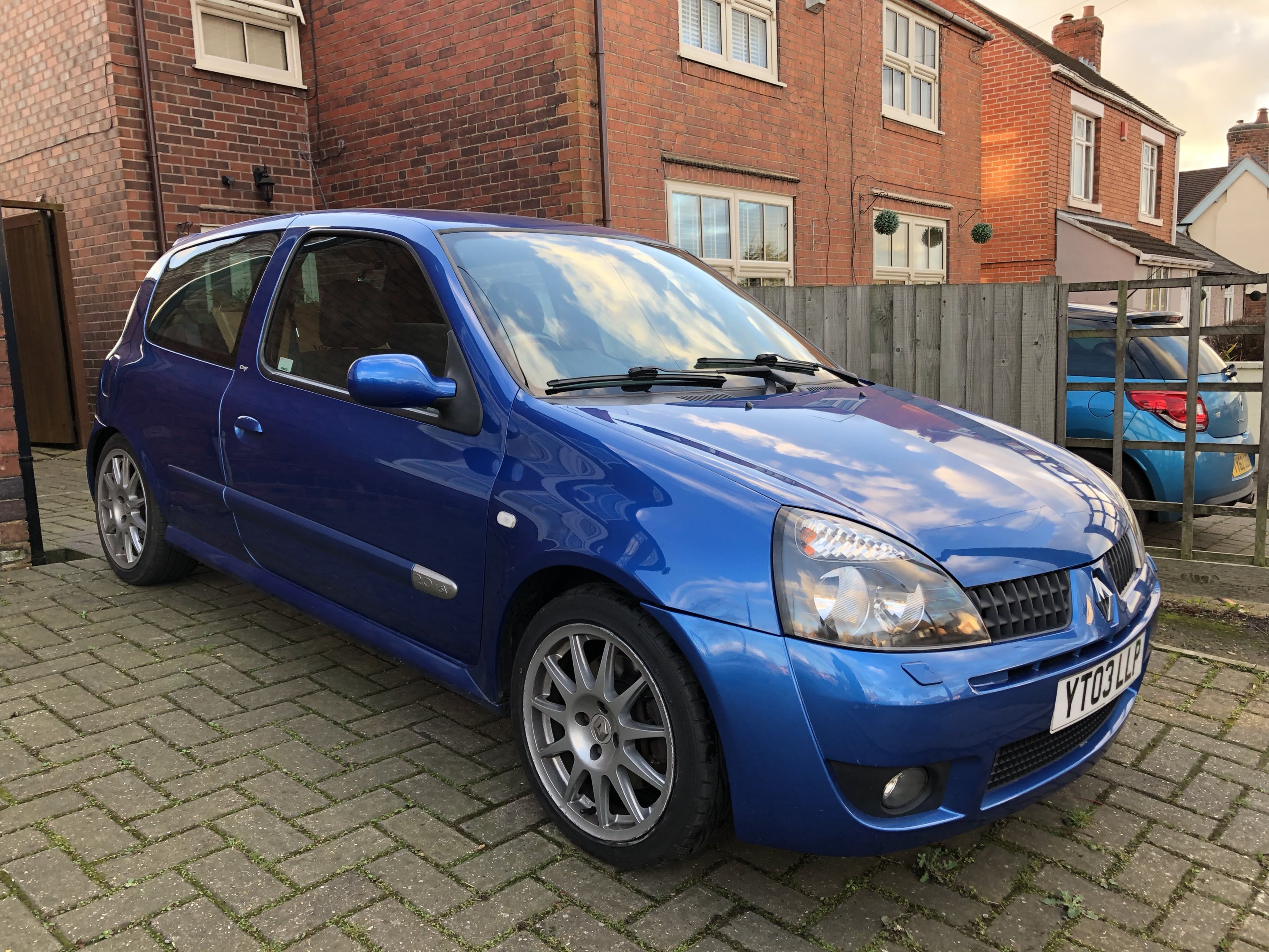

Hey guys,
I’ve just purchased a 2003 standard 172 Cup as a bit of a project. My aim is to do a few track days a year but other than that the car will mainly live in the garage with the odd run out at weekends. My aim is to keep it pretty standard but add a few choice mods for both looks and performance. These things seem pretty hard to come by these days and while I bought it simply for something to tinker about with in the garage while the wife falls asleep on the sofa in front of Eastenders who knows one day I might get a good return on it?!
I’ve just bought a full set of genuine Renault Cup Shocks and I’m going to team them up with some CookSport springs.
Would love your advice as to what spacer/camber bolt set up you’d go for if you were me? Links would be ace too. Also what if any advantages/disadvantages of fitting spacers/camber bolts?!
Thanks
