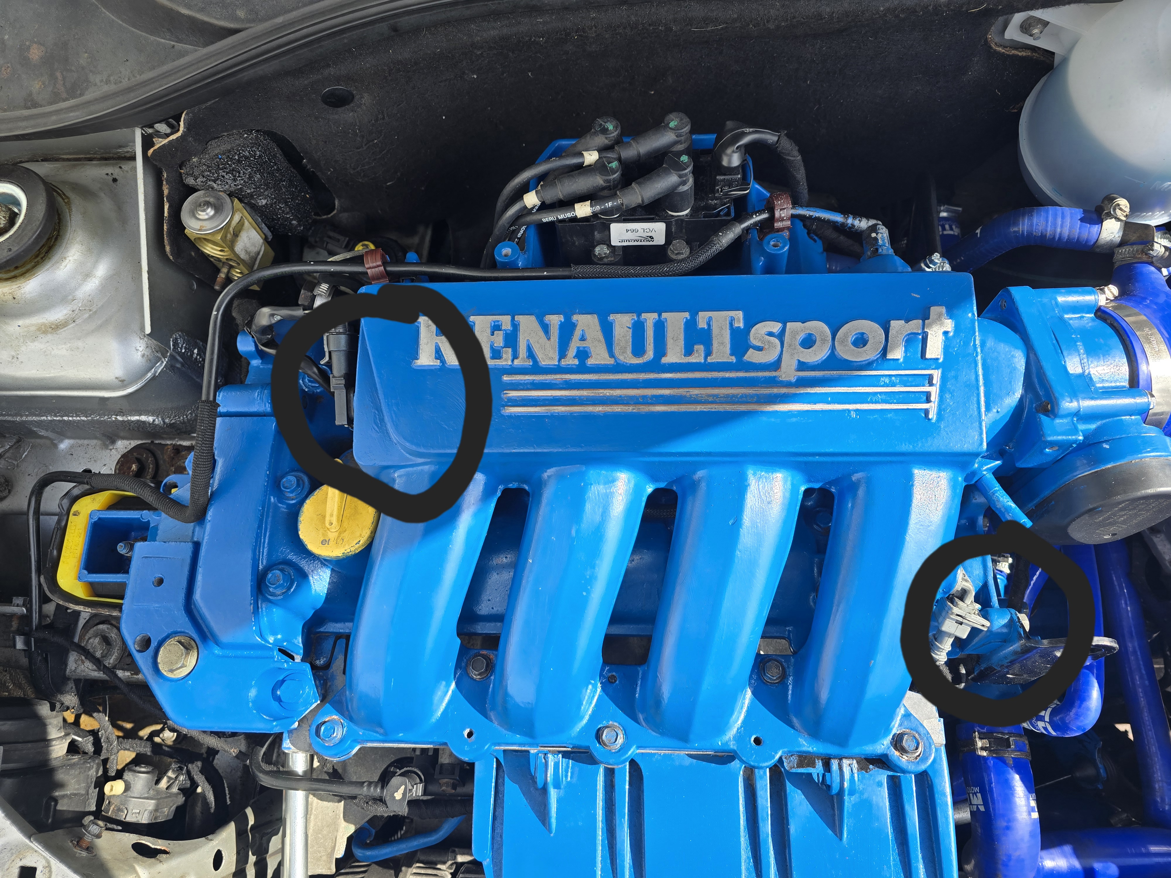

Check these two as boy can give poor running. The left hand side one is particularly problematic and as such a few people have created a work around to make sure it doesn't move when driving. The oil ring generally loses the ability to hold it in especially when cornering. ( clean it up and then either replace the O rings with generic size 13mm and 6mm I believe off top of my head or as a temp fix cable tie it and see if the problems go away)

I dont have high rpm‘s but i will clean those. 2 sensors tomorrow. They feel very loose when i looked at them before. i could wiggle them around. Whats the method of fixating them?

CFAB makes a map sensor holder , but you can either get generic O rings or get the spares from Renault.

Try cable tieing it before you spend money on it. Halfords do an O ring kit , I've had mine years and ocassional comes in handy for stuff like this 😂

Where would you mount the cable tie? Because i cant think of where to put it so it holds the sensor in place. And you still want a video of it running

The cable tie would have to go over and through the first inlet , it will look a mess but it was just to diagnose your issue. I didn't actually go that route , as I said I had some halfords O rings kicking about from a kit from years ago. Mine was mega loose to the point you could move it side to side.

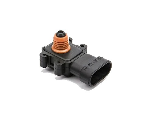

My sensor looks like this to do you think it has the Orings underneath
