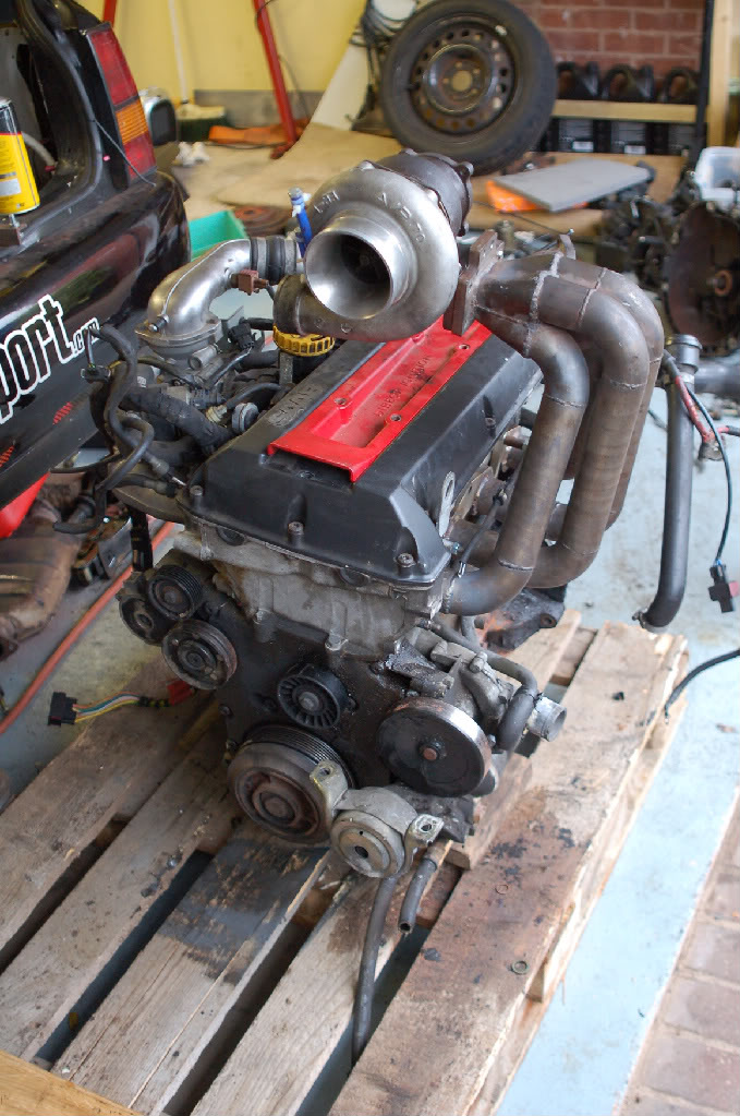

New engine not quite so cool, its a saab turbo now so cant rev it to 8500rpm like the old mega money one, but should make similar power :)
Its this engine now:
Currently trying to ram a supercharge on it as well to spool it sooner but struggling a bit for space :(
Might go back to using nitrous instead though, that works epically well with big turbos!
Wow :O!! That is mega !!!! A super and turbo ccharged nova would literally be ...in one word 'special' haha can understand why yous have trouble with space though haha!!! If only I had a car like this haha
Being mid engines gives me a lot more space than you would normally have in a nova, but the problem is just that the charger needs to be run off the belt, so that limits where it can go.
In that pic above, the alternator is missing from the bottom left, thats where I think I might put the charger, then put the alternator top right, sort of in front of the exhaust manifold.
All looking a bit tight though!
