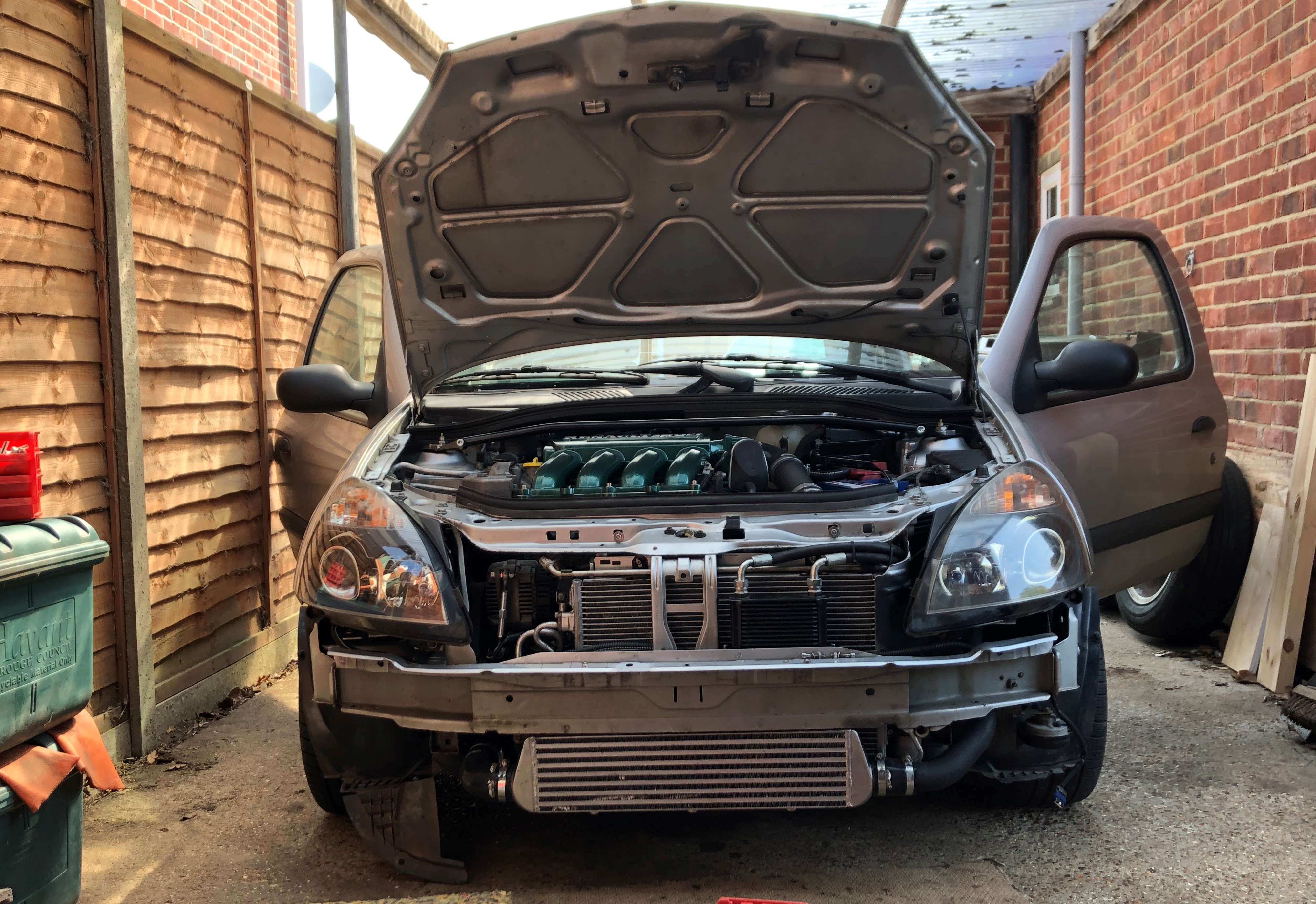

I'm in the process of doing the same to a 2008 Campus. A donor 172 is the best bet, means you have everything required.
I expected certain areas of wiring to be interchangeable (and they are in some instances, depending of the age of donor car vs the car youre building) but my 172 dash loom had different connectors for the door looms etc. So it would definately be more straight forward have a complete donor car. Eliminates these small issues.
As mentioned above, the steering column/rack is different. But provided you car has EPAS, you can retain all the original EPAS kit and run an aftermarket controller (although there are mixed opinions on these, they do work). A dci rack is what you want as it has the same rate as a 172 Cup, but its not essential. Just need to add 172 tie rods and rod ends.

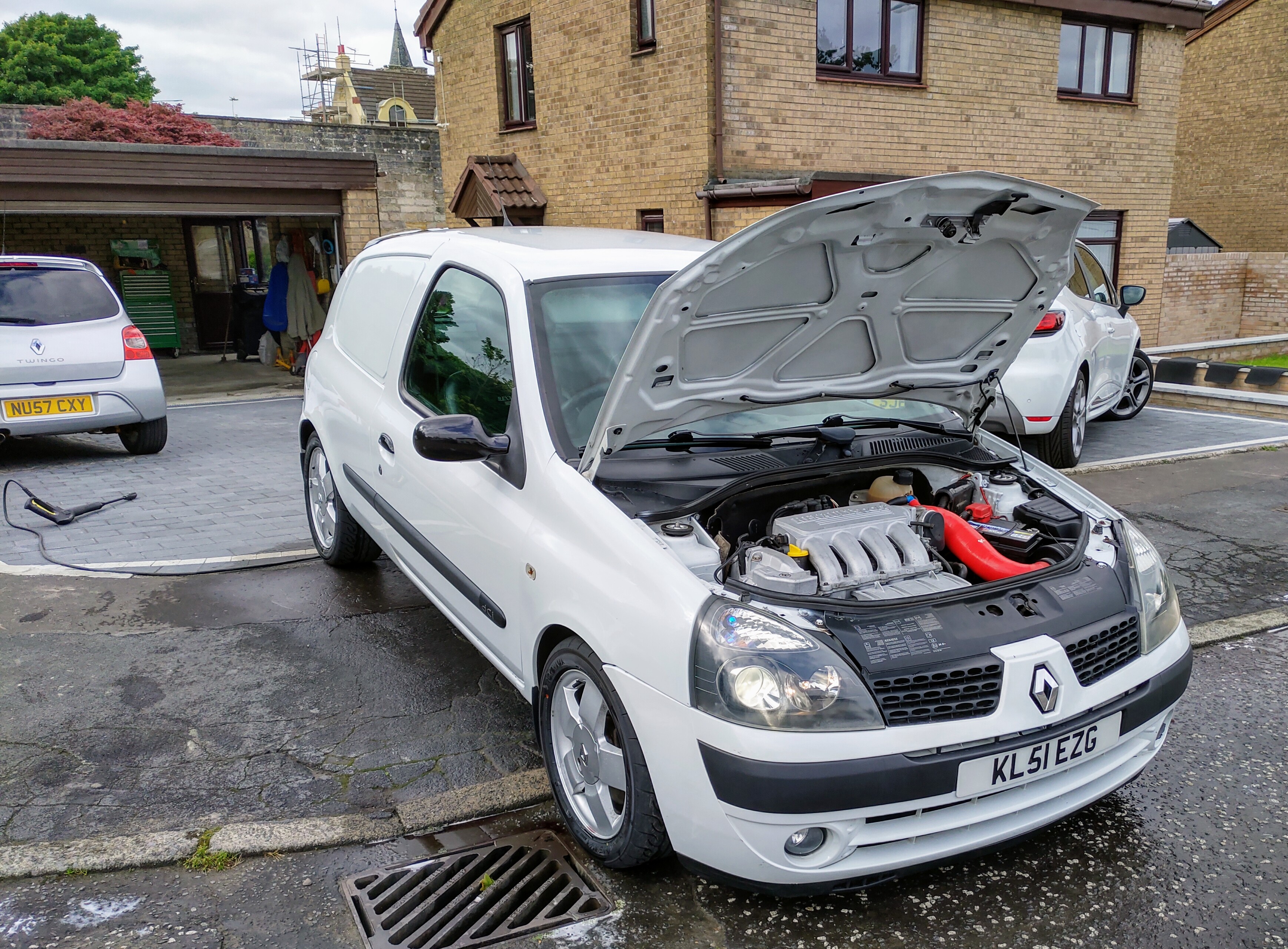

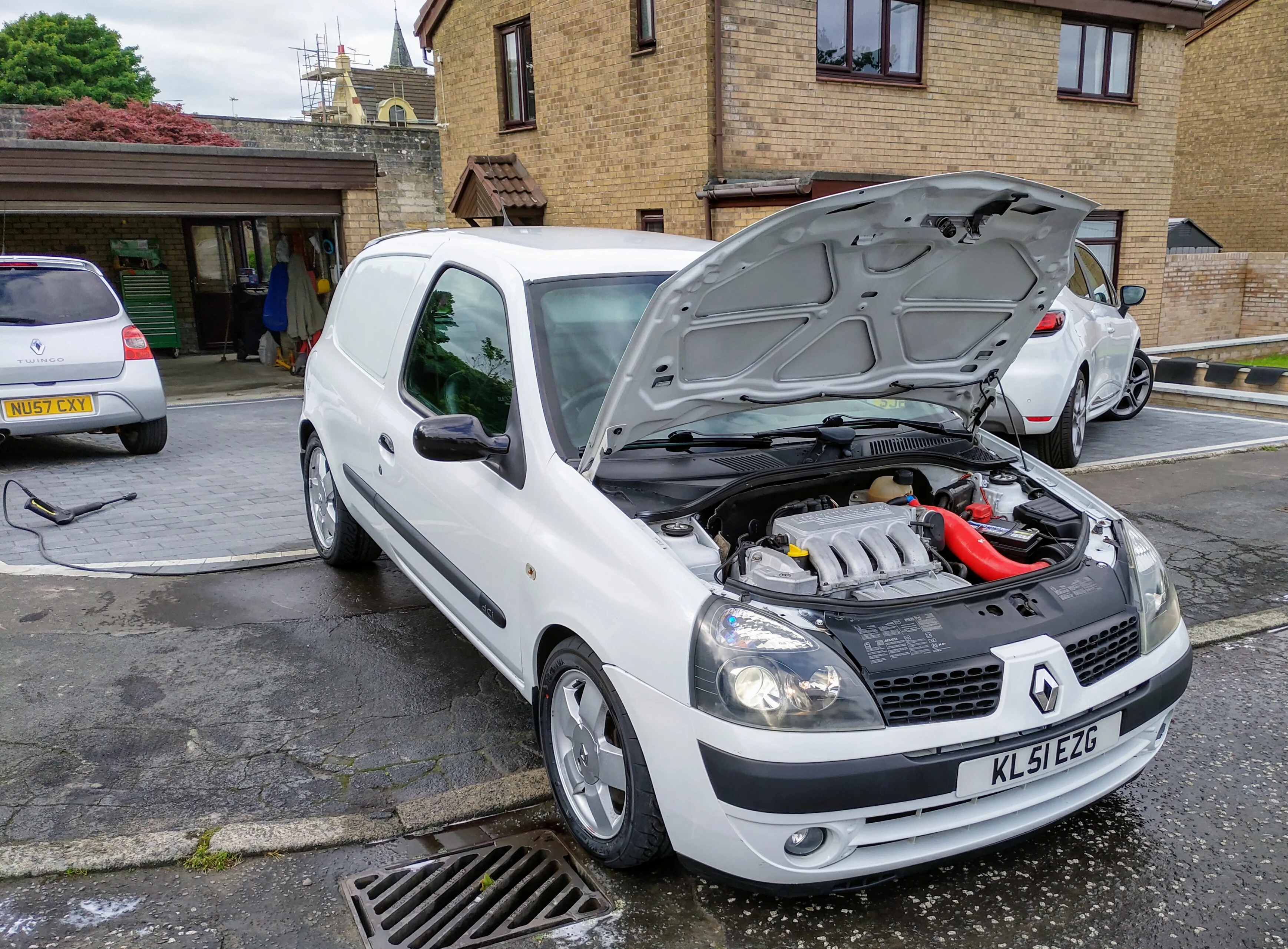

I did it to the 1.5dci van. I did the mod on the sub frame for the extra gearbox mount. I added the wiring to the 182 loom to keep the electric steering rack.
Fitted an engine dynamics turbo kit ect. I had a scrap172 doner car to start, but ended up using 182 looms and ecu/uch,
It was worth every frustrating minute and the hundreds of pounds I spent. So it time and money don't matter do it (y)
As above!
Van £220
Donor 182 £500
