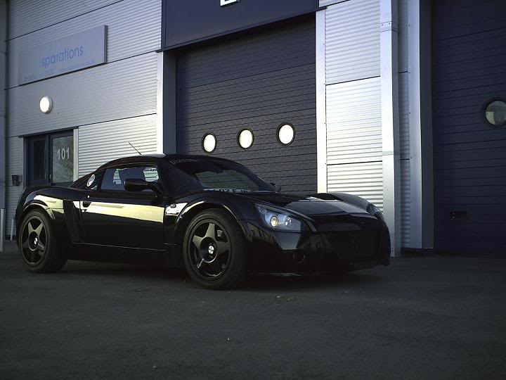

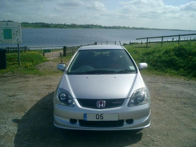

Car  CTR--VX220D
Hi Guys,
As you can see im new on here but have been pointed over from VX220.org by Gary G.
Hi,
I currently have a Civic Type R, and sold my Elise to buy a VX.

Im gutted looking at that, i just sold my LY vx for a clio cup cause im getting a squat, ill be back tho and the cup as far as hot hatches go is the nuts. In answer to your question, i dont no but would be a good idea starting with the cup as it is already partially stripped.

Your VX looks awesome!!
