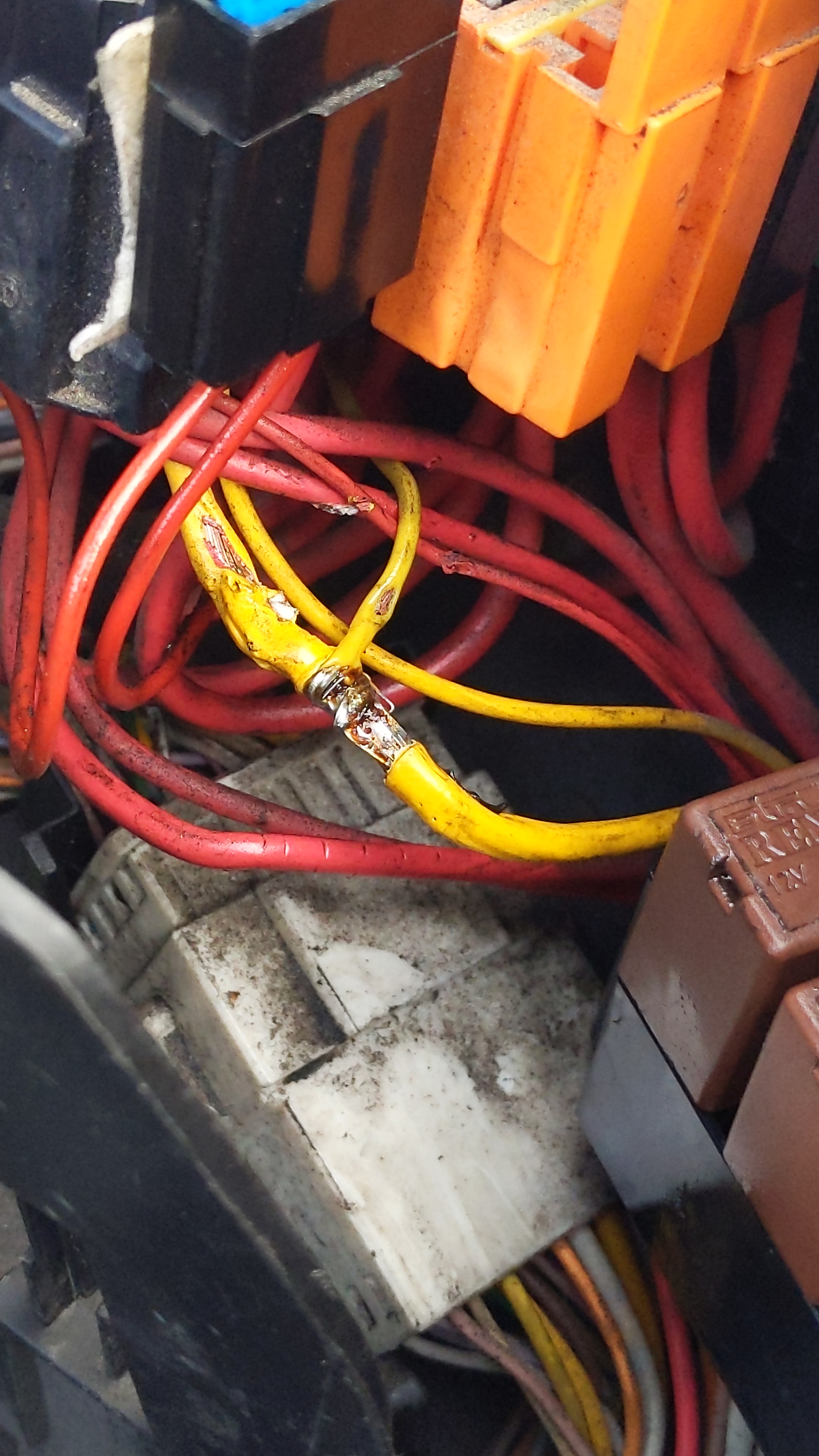

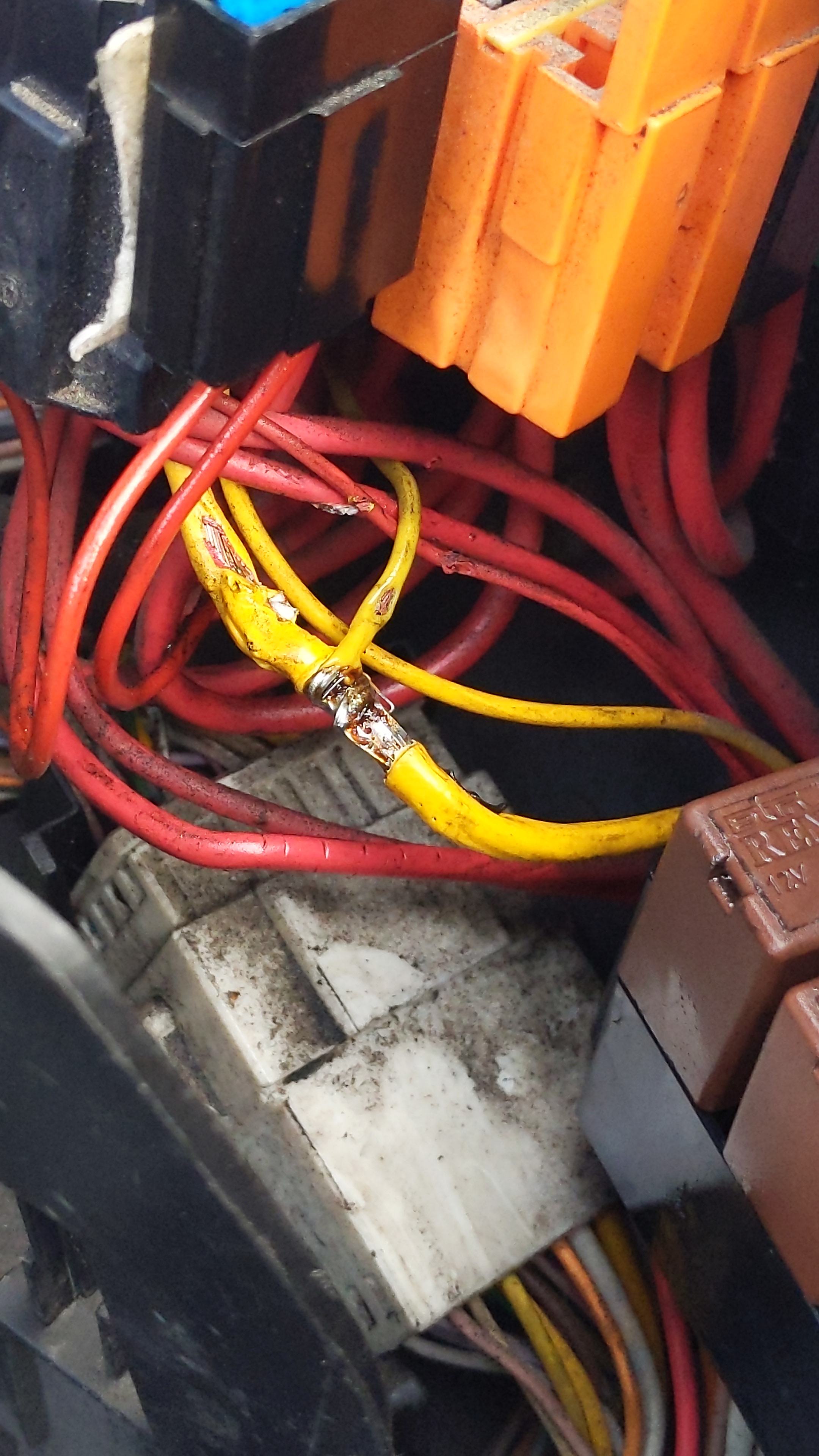

well that doesn't inspire confidence in the rest of the electrics. No bloody idea what that yellow wire is for, but that T join is rough as hell.

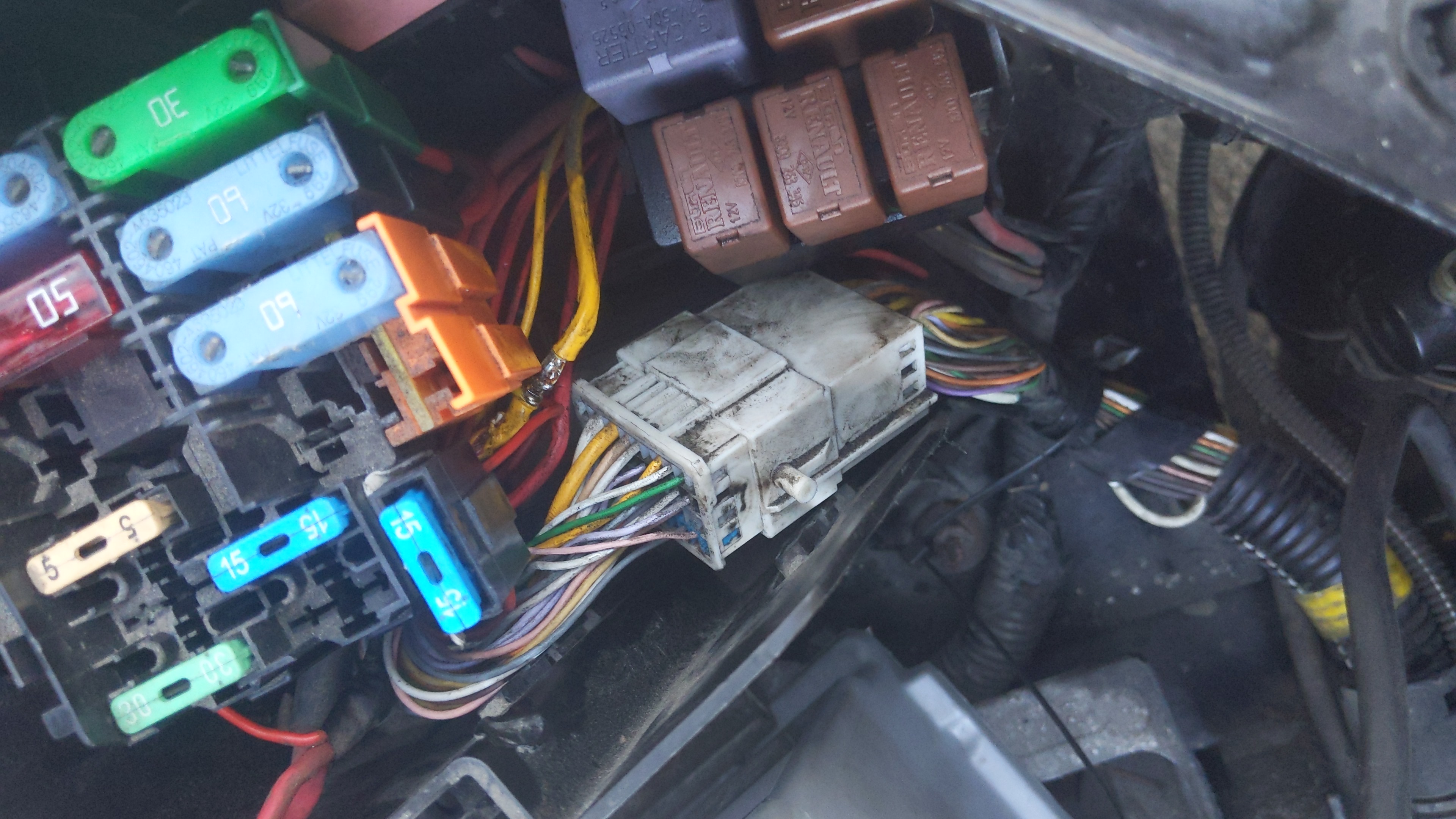

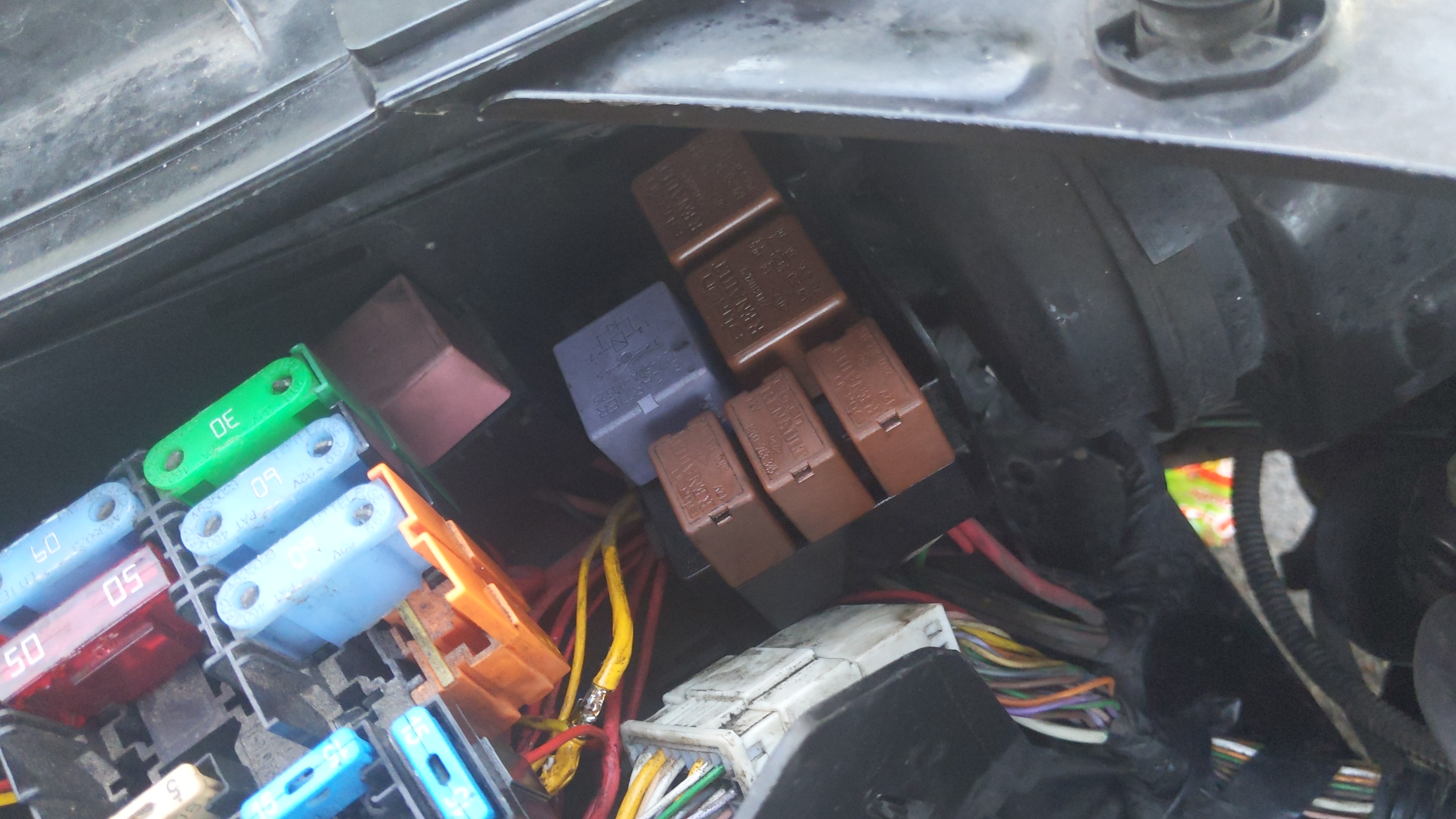

I've tried locking/unlocking many times and combos. I've pulled all the relays and fuses. Checked the white plug, all looks spotless inside the plug.
The lilac coloured relay had a bit of corrosion on one pin. I cleaned it up best I could but it has eaten away slightly so I'll order a new one of those. Doubt it's causing my red light issue though.

View attachment 1550594well that doesn't inspire confidence in the rest of the electrics. No bloody idea what that yellow wire is for, but that T join is rough as hell.
All those red cables are also exposed. That's terrible!

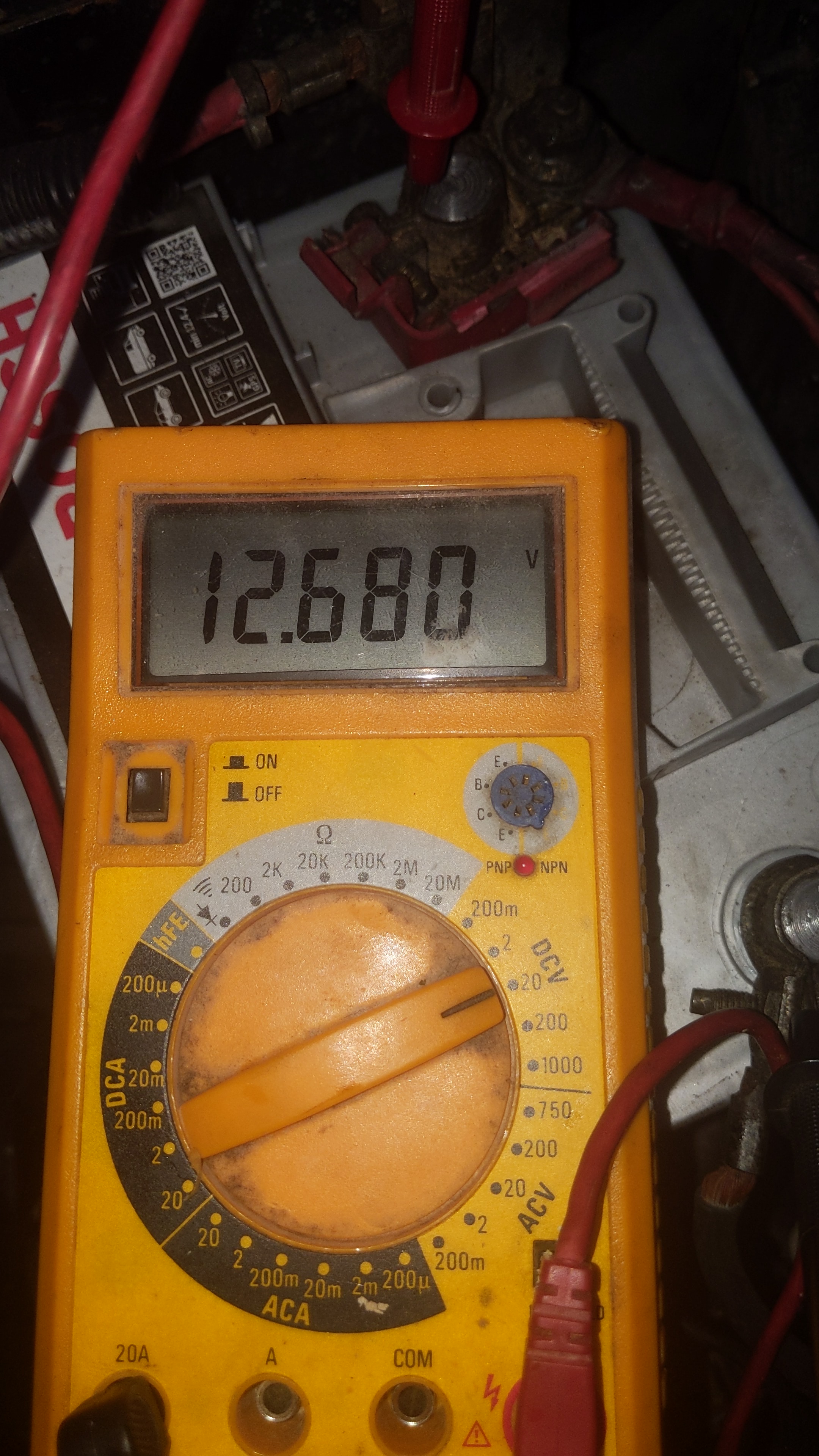

Sounds nuts abs excuse me for questioning it. But have you checked the urgent battery charge? That wiring is a mess and I wouldn’t be surprised if it’s drawing power and flattening the battery.
the voltage looks good.
I just went to start it and the red light went out again then I got a few dash lights flickering.
