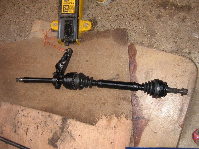

Two piece shaft on the drivers side, unlike the 172 Cup which only has a 1 piece shaft. Stick your head under your car and have a squint.
Ok, so hows that work then? How can they be 'equal length' when the gearbox is located N/S, genuine question btw?
The drivers side shaft is in two parts. Short part that comes out from the box and is connected to rear of engine. From here a shaft similar in length to the passenger item goes down to the wheel.

Couldn't find a Clio example but here's a Vauxhall setup:
Left flange to gearbox, braket to engine and then right side to wheel. Similar goings ons under the bonnet of a 182 from what I can see.
