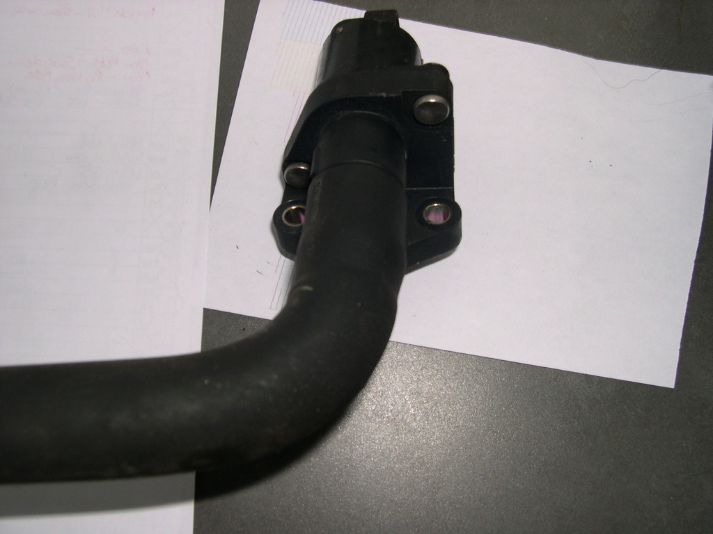

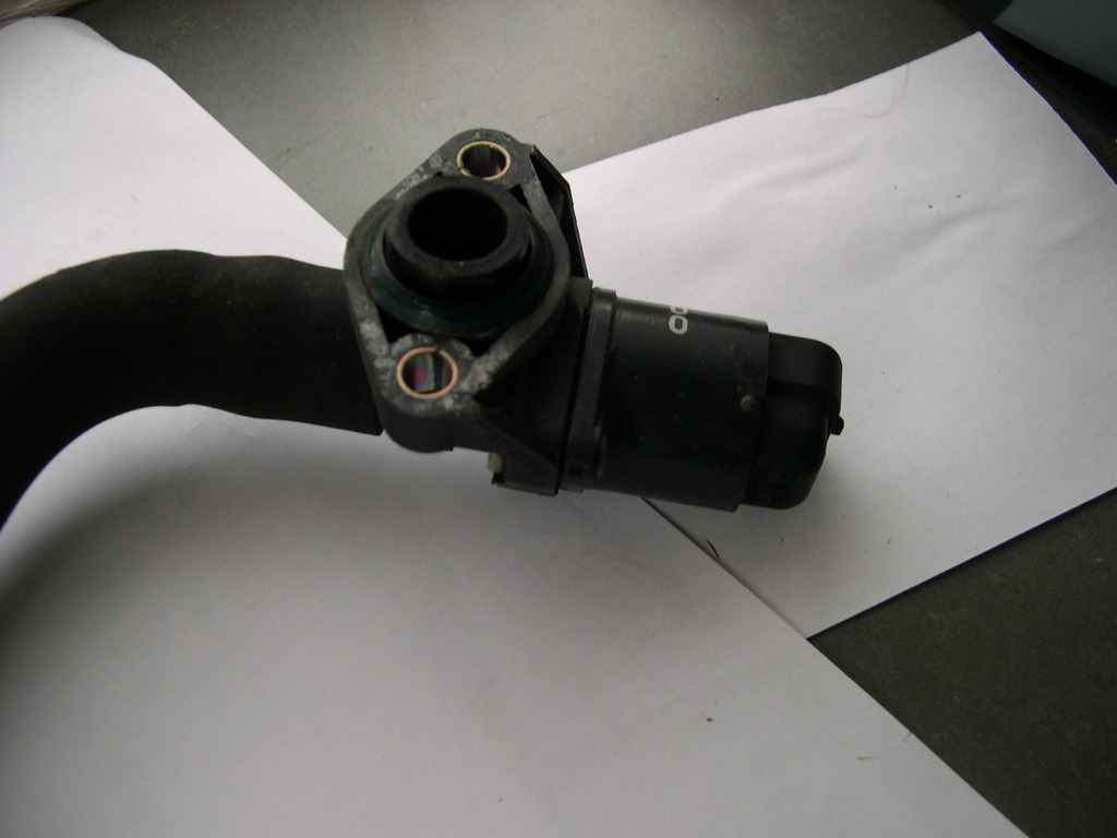

Idle Control Valve .
Take the rubber pipe off and run the engine , rev up the engine using the throttle linkage and spray carb clean into the sucking air passage and this will clean the valve .
These valves get gummed up over time .

Right- found a couple photos on this site confirming where the ICV is. Disconnected the pipe with the ICV on the end. It looked all carbonned up, so gave it a good clean with carb cleaner. Still do the inmlet tract with the engine running?

So- cleaned the ICV, and the car definitely better. However, not cured methinks. When idling at lights its sometimes as high as 1500 rpm or 1250 rpm, then drops and steadies at 1000rpm after about 2-3 seconds. When changing down (the in neutral split second) seems quite low on revs too which is good.
However, it used to idle at 750rpm, now wont get lower than 1000revs, and now and again it oscillates between 1000 and 1250 revs. And the rev counter is sometimes a tiny bit twitchy as well as the sound of the engine
Have got TB gasket on order, so will remove and clean that up real good, rather than squirt and hope with a bit of carb cleaner into the intake and trying to clean the spindle and return spring, then lubed with WD.
