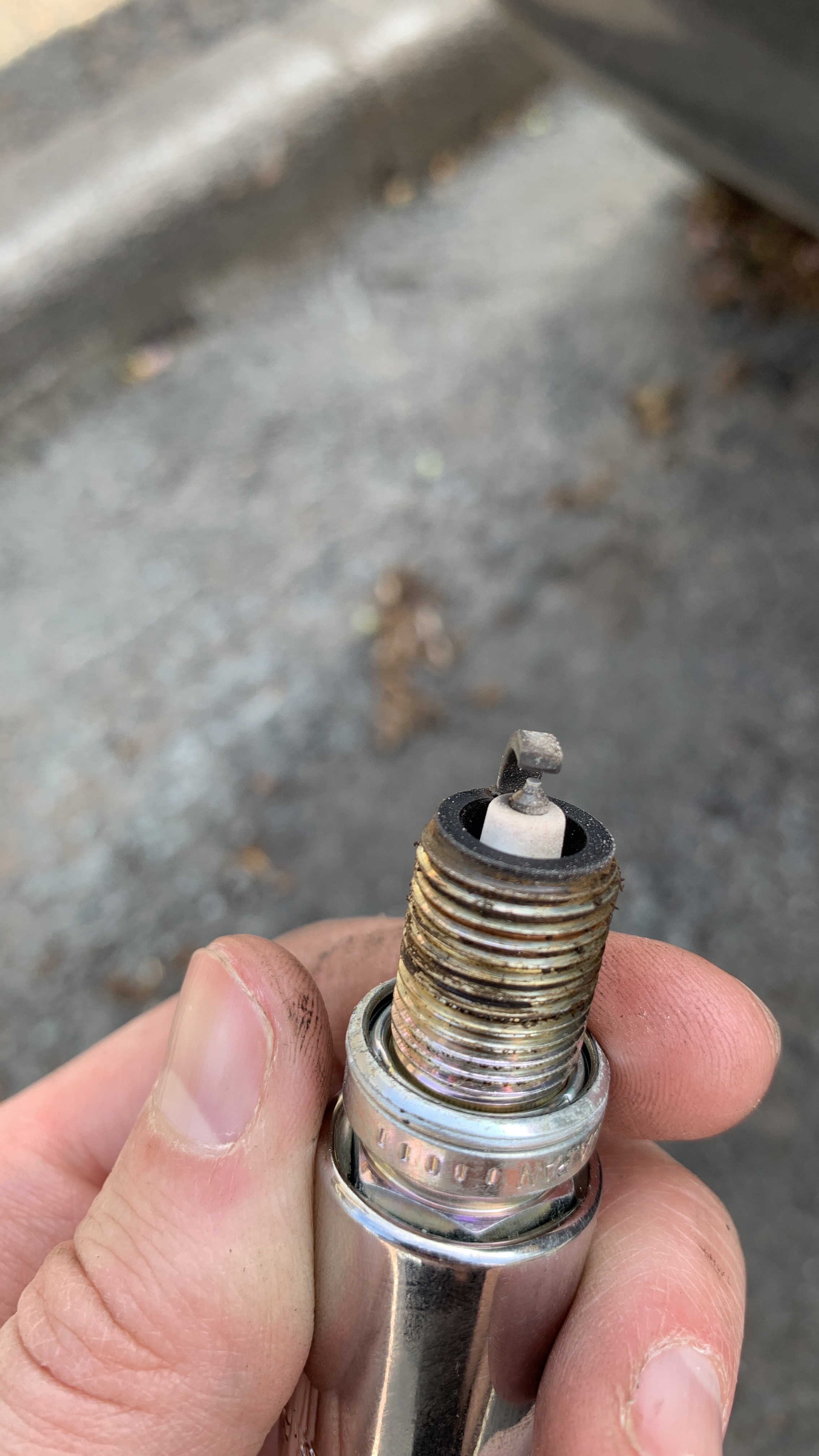

This is a year old plug in mine for reference:

Thanks for the pic of your spark plugs, to be fair mine looked identical! I think it was cylinder 2 that was whiter than the rest, so that's probably the injector that's given up.
