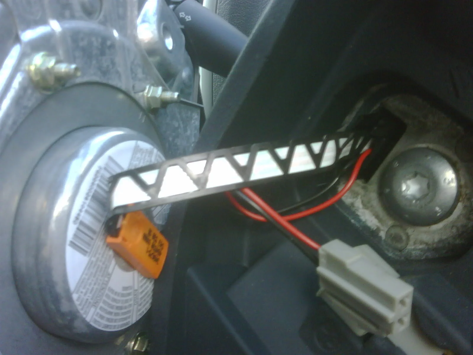

Hiya I'm just swapping the steering wheel over and I'm stuck (read as shitting it lol). Read through the guides and what I can find search wise but I'm still not sure which cable/plug I'm meant to disconnect.
Anyone able to offer me some advice?

The orange plug just pulls out. I used to chopsticks, just in case! (Assume you've left the battery disconnected!)
I thought it might but the guide on here, for ph2, said bout it going up and down and not back. Batteries been disconnected for well over an hour now.
Here goes nothing!
Cheers
Sy
I'm pleased to report I'm not dead, still have two hands and one intact airbag. W00t!
Cheers Warren!
