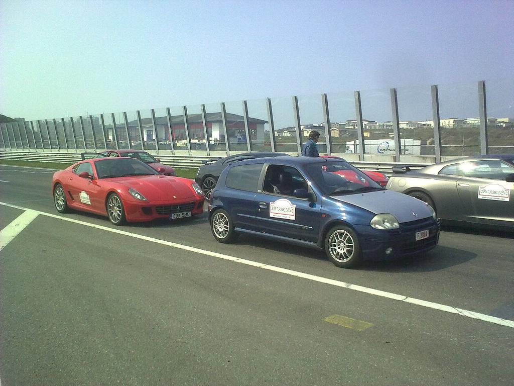

My Clio really did not fit in well with all the expensive cars present. The next cheapest car was a E46 M3 on R888s, driven by an Englishman who at first sight was Hugh Grant, but actually was just some bloke that has been in amateur racing for the past 20 years. He also happened to be one of, if not THE fastest car there today.

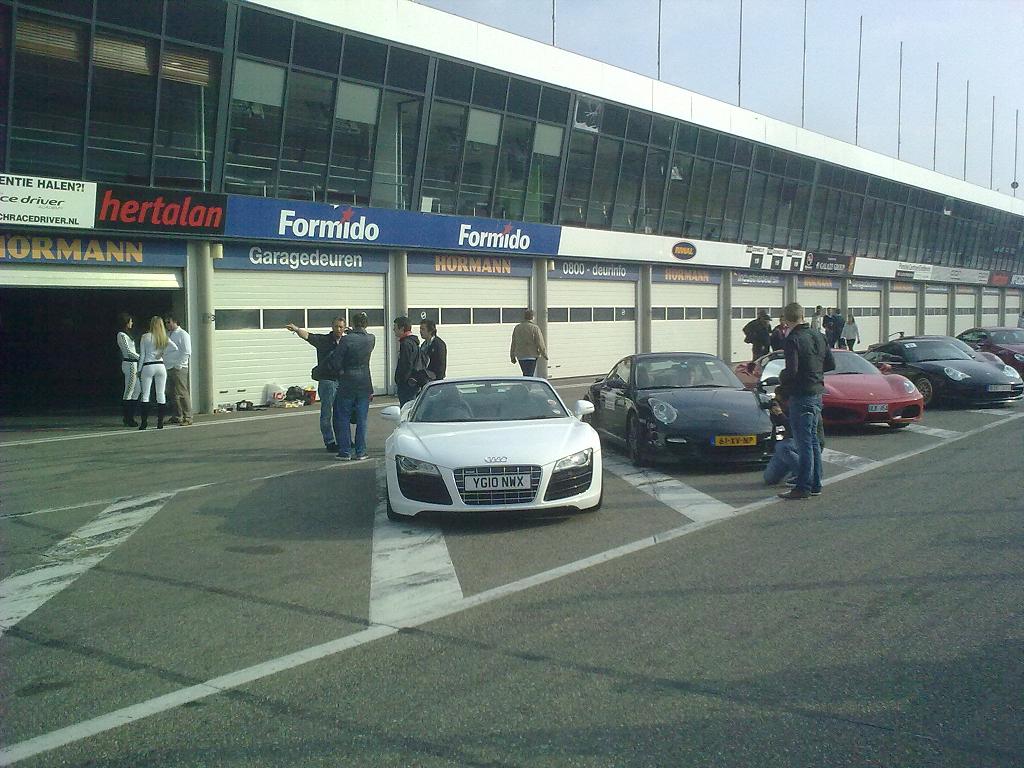

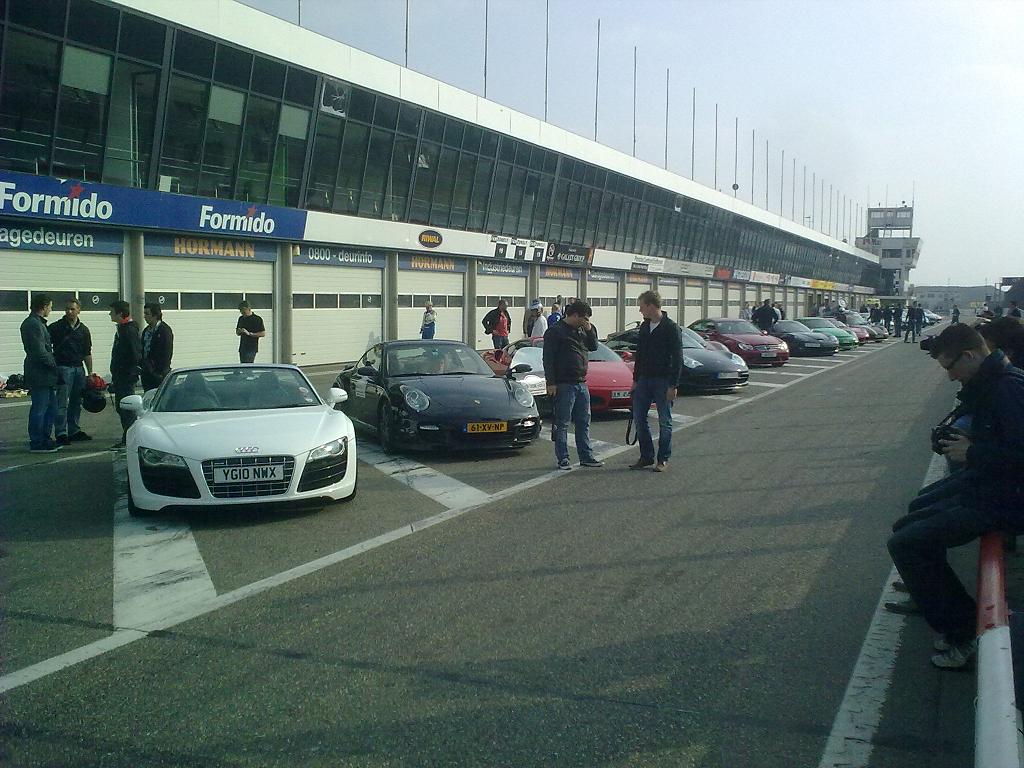

Some nice cars and tail to be seen in the pitlane.

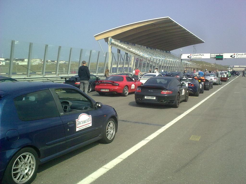

Earlier session when I didn't know the track, some nice cars out there.

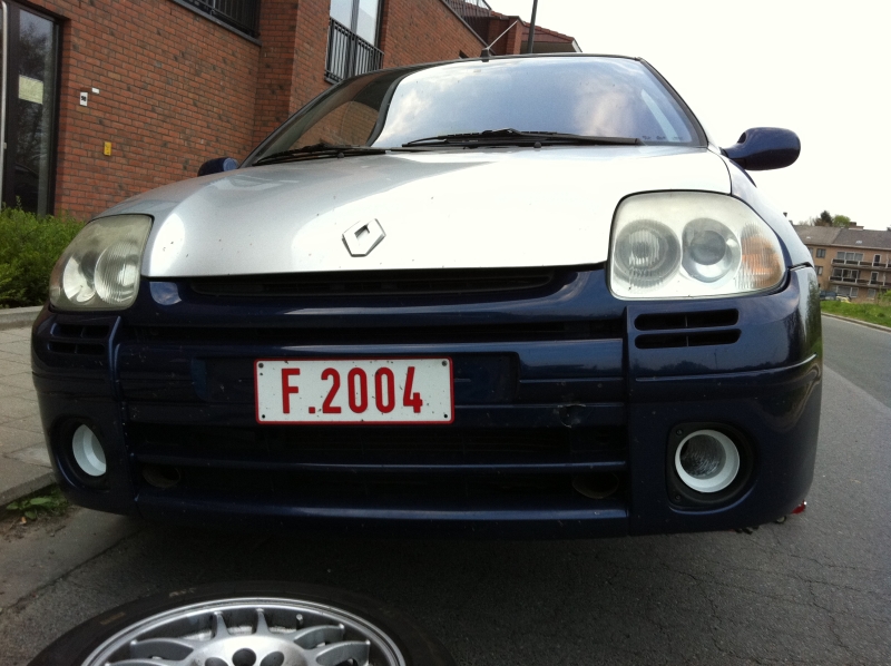

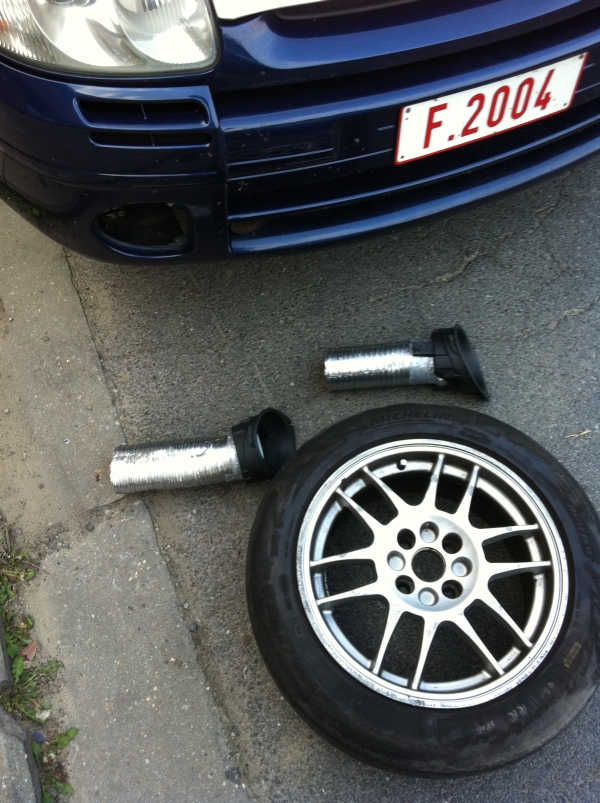

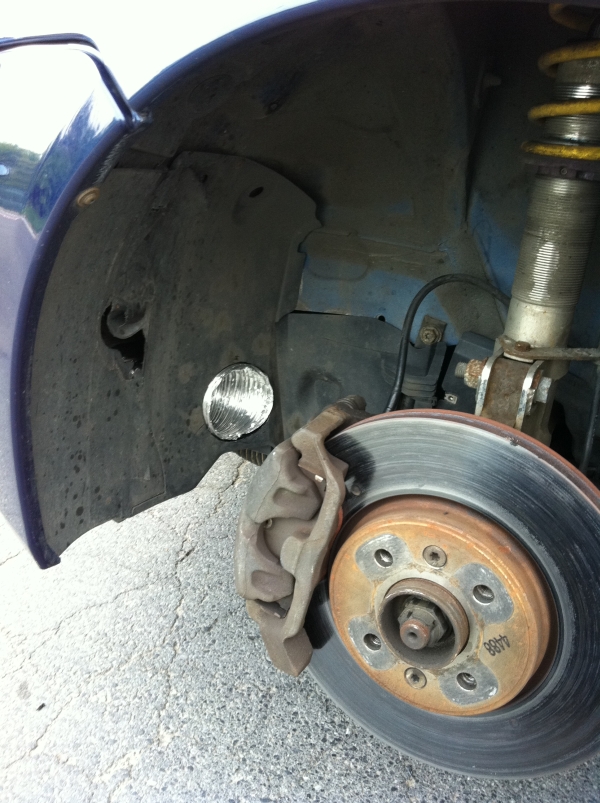

As disk temperature was up to 500 degrees C after 5 to 6 laps, I felt that the Clio was in desperate need of some better brake ducts.
8cm aluminium ducting was fitted onto a 10 to 8cm plastic adaptor piece with duck tape, stuffed inside the original fog light mounts, and then installed after remounting the horn. Might put in a small deflector plate later
The RX7 was probably a cheaper car than the E46 M3 ;)
