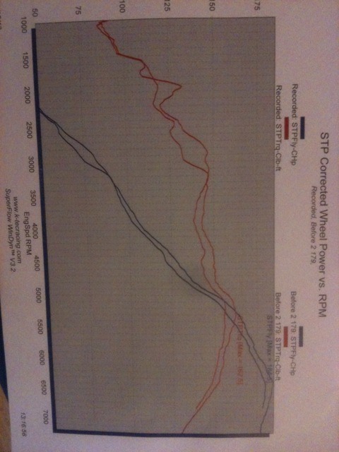

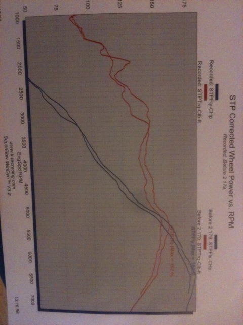

182 not 172 but this is the dyno I got from my remap (already had scorpion exhaust). I think it feels smoother and a bit quicker, mainly at lower revs I notice, it's not a massive difference by any means tho...
