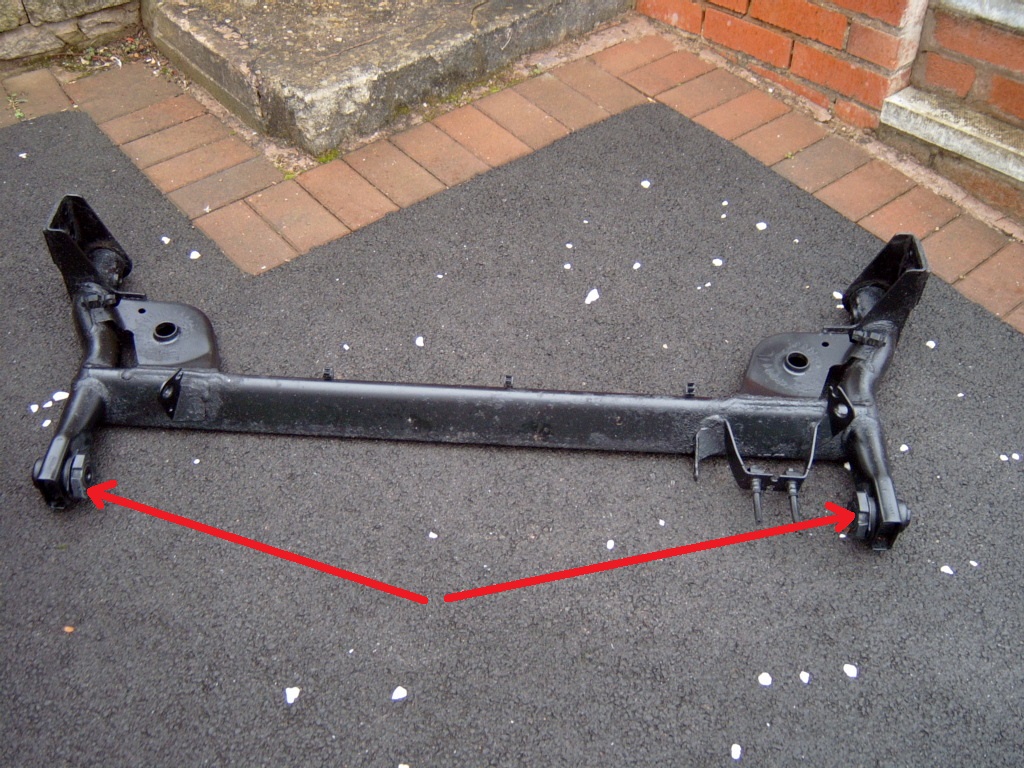

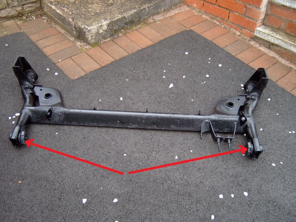

Just a short question if it is available to upgrade rear beam bush to some stiffer compound, maybe poly bushing or bearing setup or some other?
Pics attached to have a view on what I mean :)
Any inputs, photos or helpful links would be appreciated.

As above, Pure Motorsport solid bearing kit. I have it myself, it is an excellent upgrade that doesn't cost that much really so do it. You may also wish to consider the gusset kit for the rear to but its not essential. That is all.
Someone I saw here on board have installed a a spherical bearings. Would it be a solution?
Thanks for an experience shared. I saw on Pure Motorsport page they sell same spherical bearing upgrade kit for a wishbone. Should it be I would interested in too? Or I should go with powerflex poly bushing on a wishbones?
If i was buying top mounts then it would be that kit, your money and your choice mate.
​With the PMS kit you can just buy the bits that wear out if needed.
Renaultsport 'did' offer a teflon bush for the rear beam. Not sure on pricing/availability compared to the pms spherical bearing kit though.
