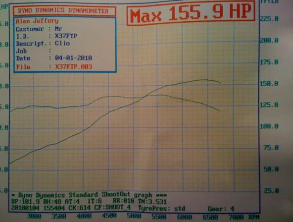

And the result was okay I guess for a ph1 standard 172 with 100k miles.
155bhp with 156 ft.lb torque (1st run) then 164bhp with 155 ft.lb torque (2nd run).
I did ask them to also give their oppinion about the slight misfire at idle which they tested on the gas analyser and the hydrocarbons were really high. However what I am concerned about, is they tested the hydrocarbons after the car had been sat cold for half an hour. Am I right in thinking that they would be high if the car was cold? They told me next step would be a compression test which I find a bit odd as the car drives fine, pulls really well in all gears and has no loss of oil/water or mixing of the two. It also does not drink fuel and other then a cold start issue with what I am 99% sure is the idle control valve, is perfect (other then a lumpy idle that appears to be a very slight misfire but then again it might not). The exhaust at idle has what I can best describe as a very slight pop so when you put your hand near to the backbox you can feel it popping on your hand (but not a backfire or anything like that) and as soon as you accelerate even at low speeds it stops doing it.

Is 164 good? Should they not be 170 standard I've not long had my clio and love it to bits already - its so much fun, but I got worried today and saw pound signs light up in front of me when he said hydrocarbons were so high - but like I said they did check them from relatively cold.
  ITB'd MK1
that's pretty reasonable power and very decent torque for completely bog standard. What type of dyno was it, and you you have a graph you can post up? :)

I do have a graph, but sadly on of the first run as I forgot to pick up the print out of the second run, but it is very smooth with no dodgy flat spots or low points throughout the rev range. I will get it scanned in tomorrow and posted up. :)
The dyno run was carried out locally at Alan Jeffries Engineering Plymouth who have one of the best rolling roads in the country going by reports, check out their website for info www.enginetuner.co.uk not sure of the exact dyno though.

Here is the graph from the first run... I have just noticed that the torque was actually about 140 ft.lb from what I can make out. Apologies, I thought it was higher but having opened my eyes this time, its less but still a good graph I would say....

So do you guys also think the hydrocarbons advice was wrongly given? At cold would they be very high?
Obviously the 2nd graph was slightly higher bhp wise, torque was about the same.

Seems low to me. Had mine dynoed at 170-176bhp on a few seperate occasions with just a cat back zorst and the removal of the accoustic valve.
TimR26
South Central- West Berks
It's not low, yours could be a tad high. So many variables though so, whatever the reading, as long as the car feels good thats all that matters.

100k miles and lets say average from them 2 runs you have 160 bhp and the graph looks very good too. I would be over the moon with that as I have never heard of a standard 172 getting 172 bhp unless you go on optimistic ones.
  Ph1
Your BHP might be about average but your torque figure is well above average. Sure stock 172's are mid 130's to mid 140's area typically so looks healthy by those figures imo

I will also add that one cylinder is also down on compression slightly so perhaps it will increase in bhp once its been fixed? (Exhaust vavle burnt out).
Car pulls really strongly in all gears, the exhaust valve must be a small problem with it as it only affects the car at idle and on emissions. :)
