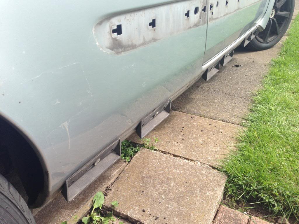

172 side skirts on a non-sport
i have bought a knackered 172 to put the kit on my 1.4 and wanted to know how to fix the skirts to my car,i will bolt it at the bottom but how to i secure it at the top,will i need the attach these to my car?
i dont really want to drill holes in my car so is there another way,thanks
Yes you will need to use those to attatch it. The holes will be covered when you rivet the clips on.
The only alternative is to use a strong adhesive like Tiger Seal, however that will leave permanent marks on your car where it has been and also isn't as strong as the sideskirt clips and will eventually need redoing.
