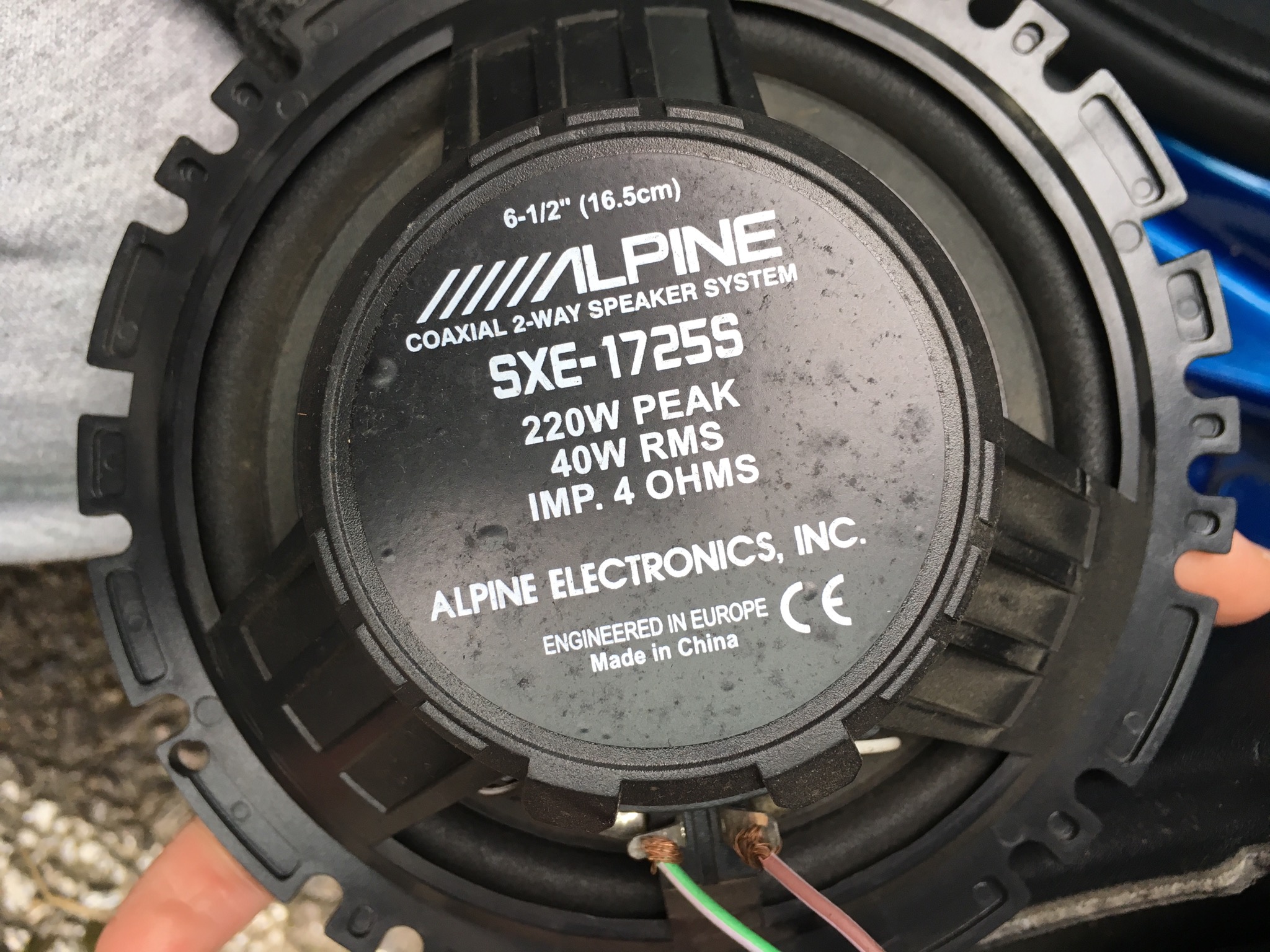

So went out this morning to finish off the wiring.
The person who owned the cup before me fitted 16.5cm speakers in the front and not wired properly as you can see,prob bit of a reason why it doesnt sound to right,being 16.5cm wont sit in the whole properly,so will be ordering some 13cm ones soon to fit.
Also the rear speaker wires are a different colour to what it says on the above post.
Purple kind of colour and looks like a yellow for the other.

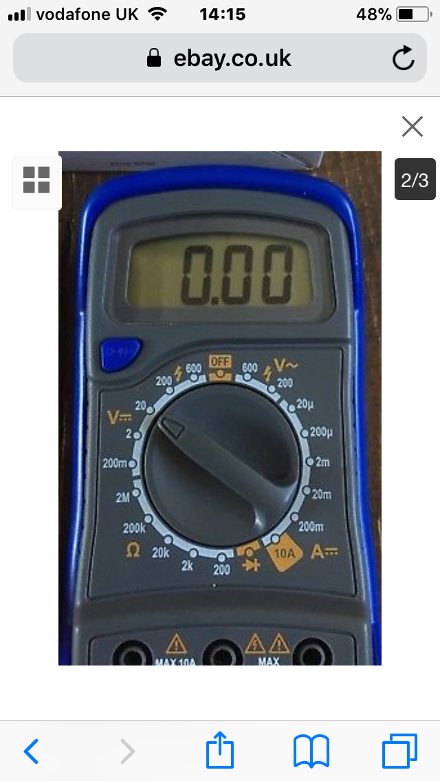

To be honest i dont know how to use the multimeter on how to check polarity,what setting to have it on??
Put it on volts (20), then turn on the radio. Put a multimeter probe on each wire. If it reads a positive number you have the polarity correct, if it's negative it's the other way round. Wire up to the speaker accordingly.
I'm guessing the meter will have AC and DC settings. If so, make sure it's on DC (the straight line symbol not the wavey one).
Edit: Actually, are speakers AC?

Yeah that's right. It just means it reads upto 20v so it keeps the decimal in the right place. As if you were measuring 0.1v with it set to 600v it would read as 0, even though there would be a voltage.
