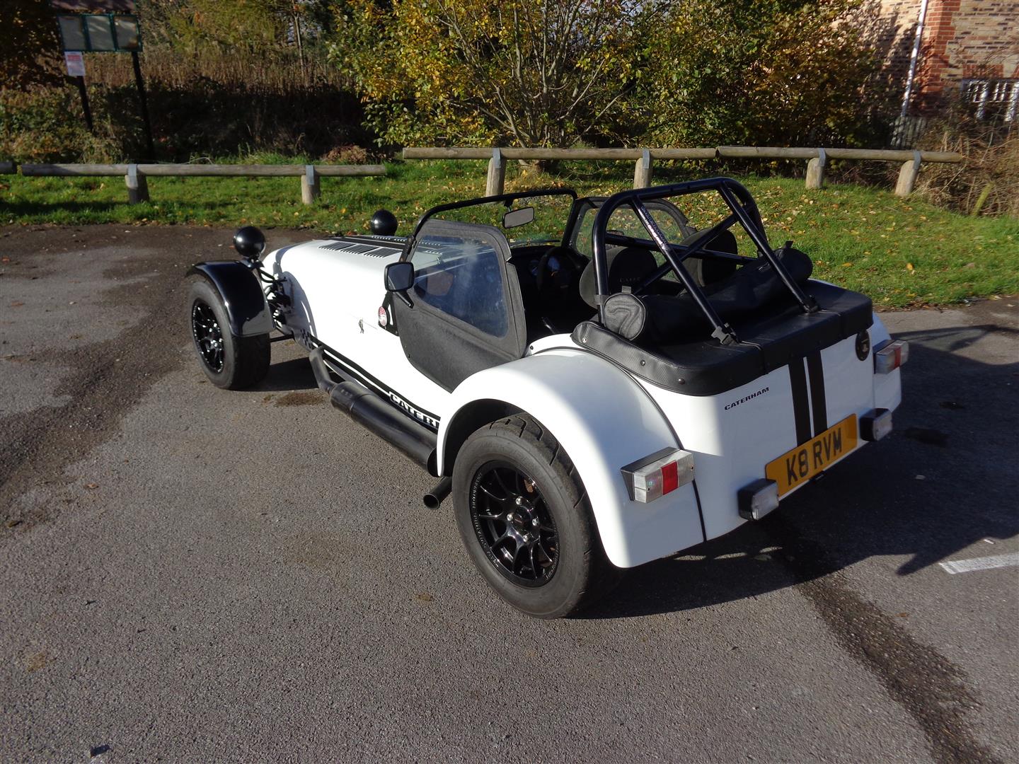

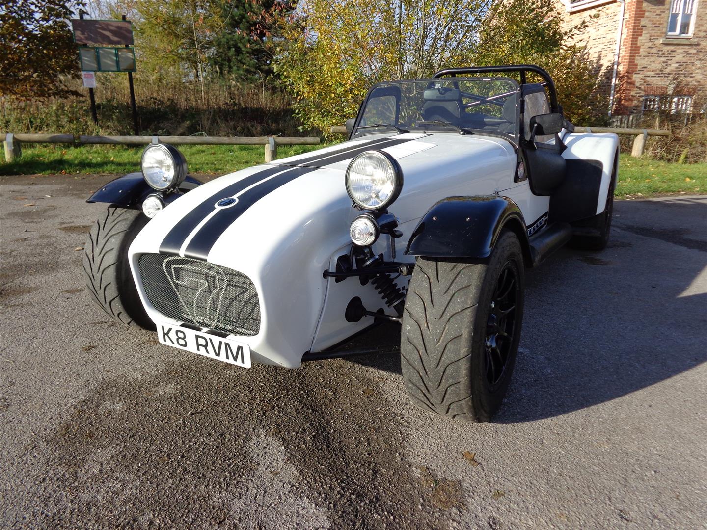

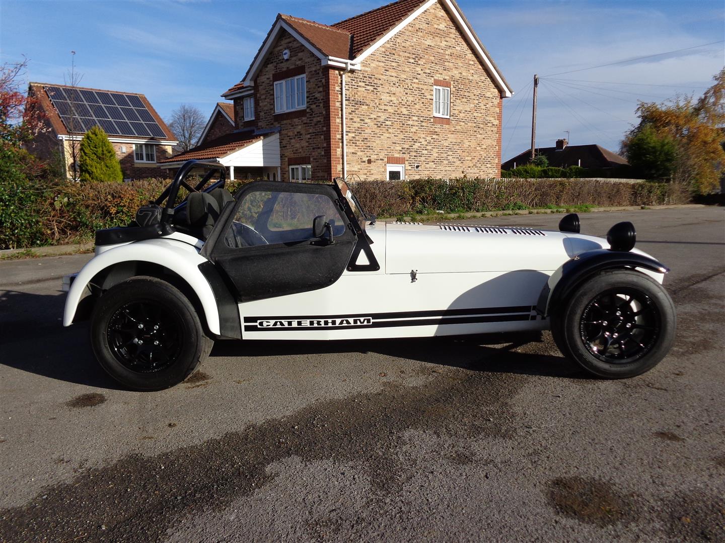

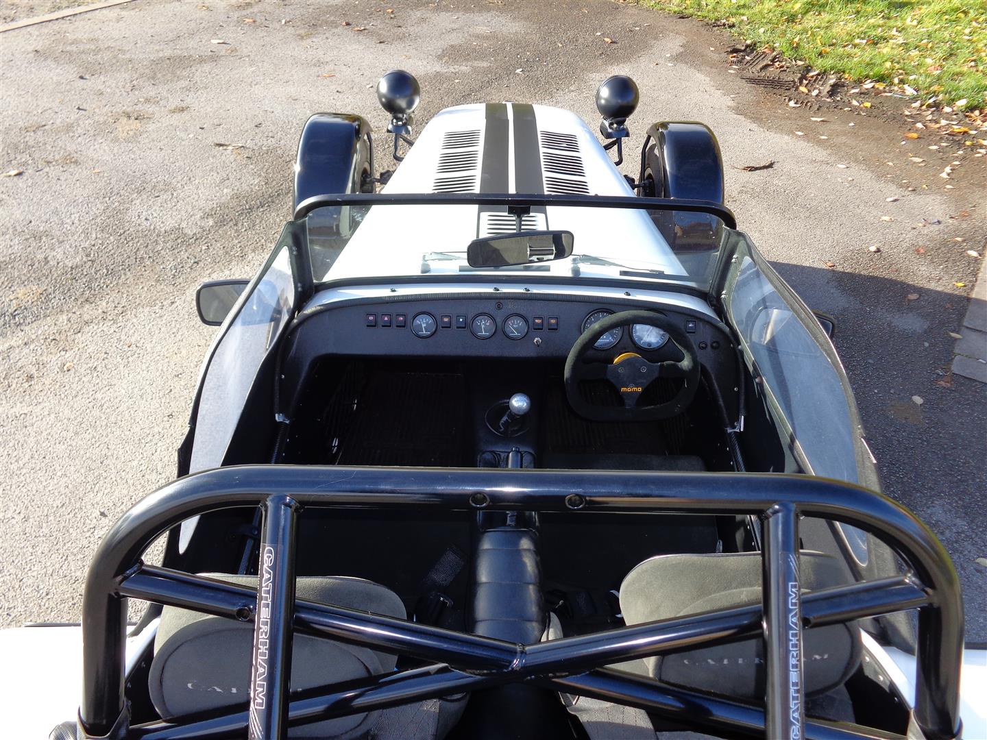

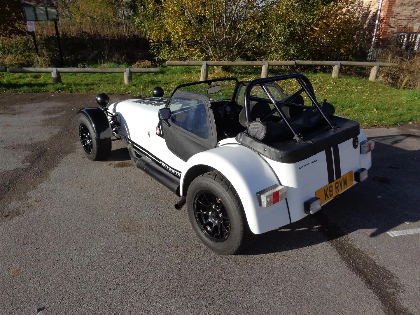

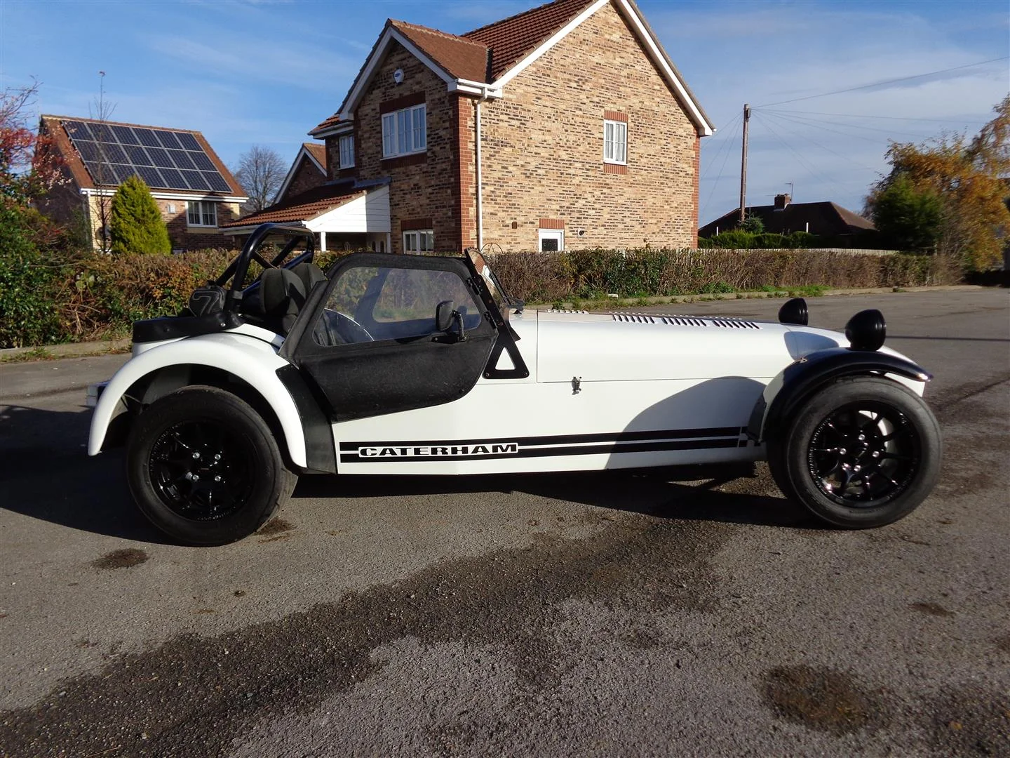

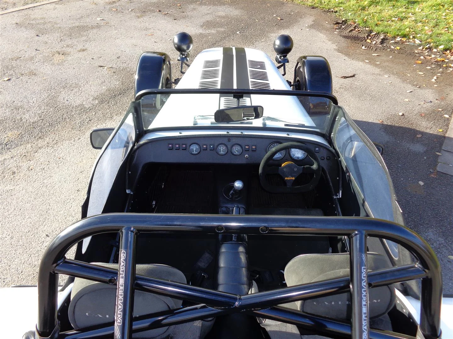

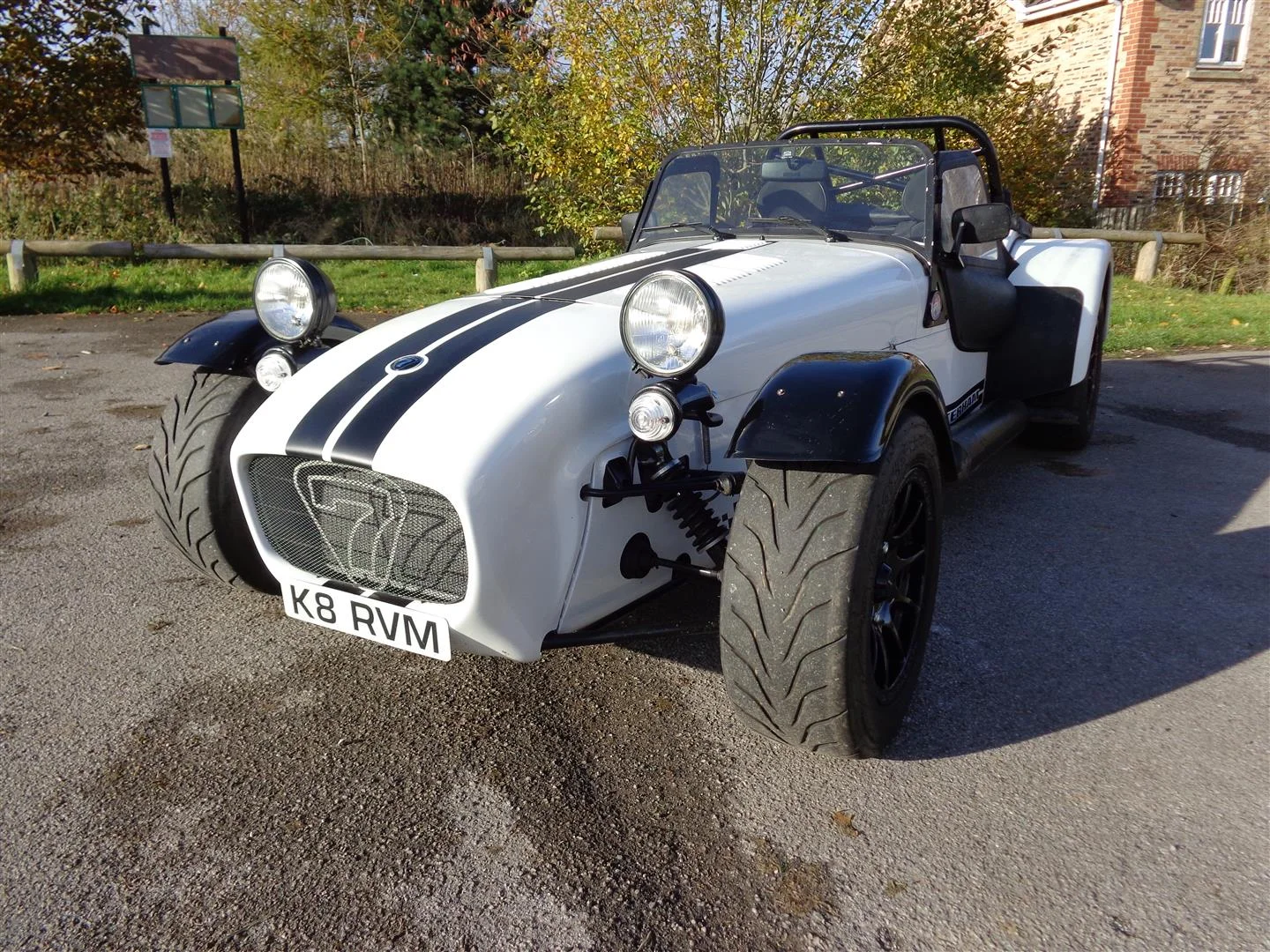

Usual thing, I'm new to this forum after buying my first Clio. Firstly like to say thank to all the people I've bought bits off so far, everything's been bang on! Little bit about me and the reason for buying the clio. Always been into cars, work in the trade and around a year ago a Caterham Roadsport 160 kseries came into work as a PX, I loved it that much i ended up buying it, changed loads of things on it, went from black to pearl white, wheels and tyres, momo wheel with rapfix quick release, FIA roll bar and full clear lenses! Although it started with a good spec, 4 pots, LSD, bilstein suspension and loads more. Took it on track at cadwell and had the best time ever! First time on track, had a few twitchy bum moments but thoroughly enjoyed it.

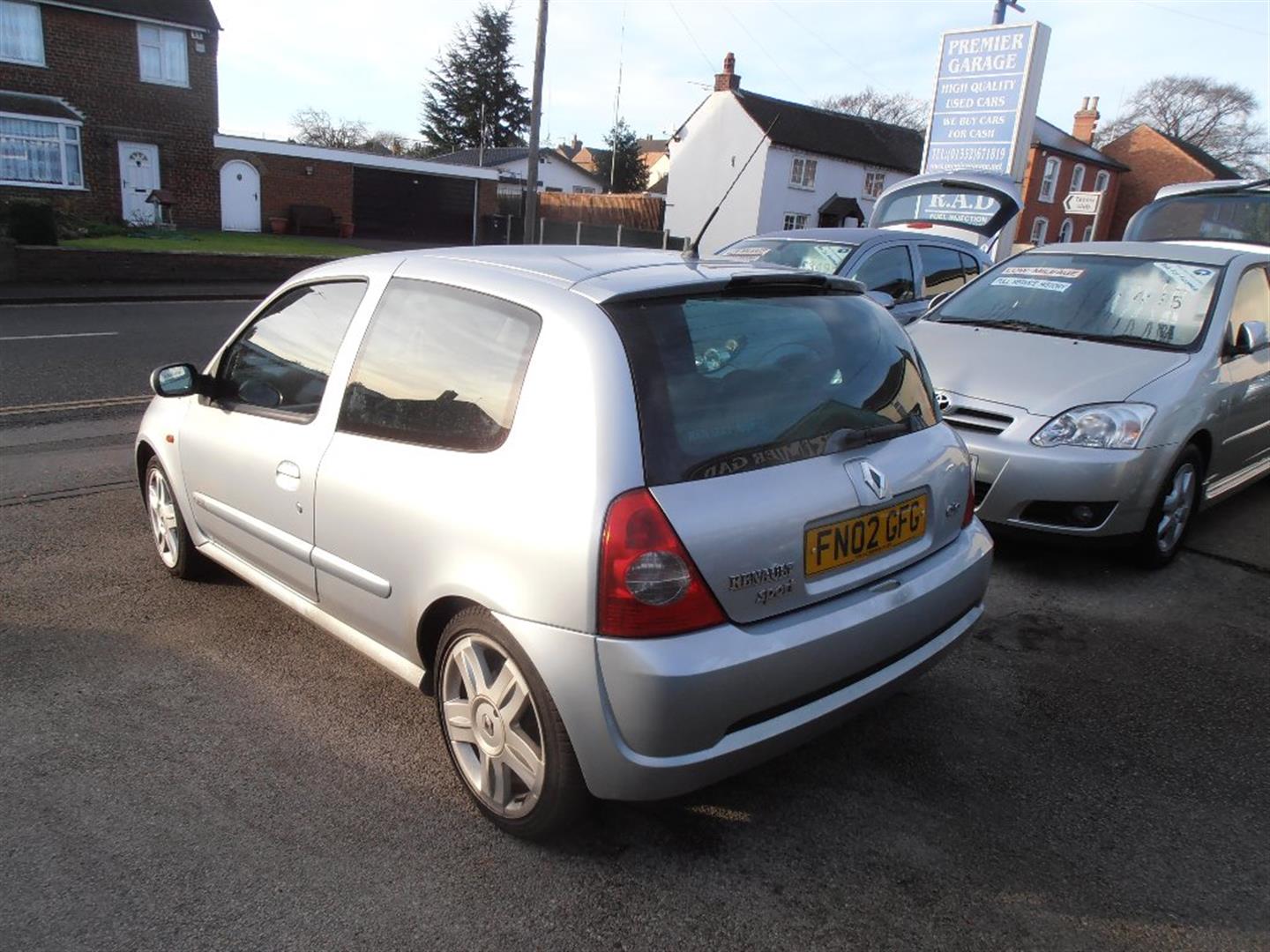

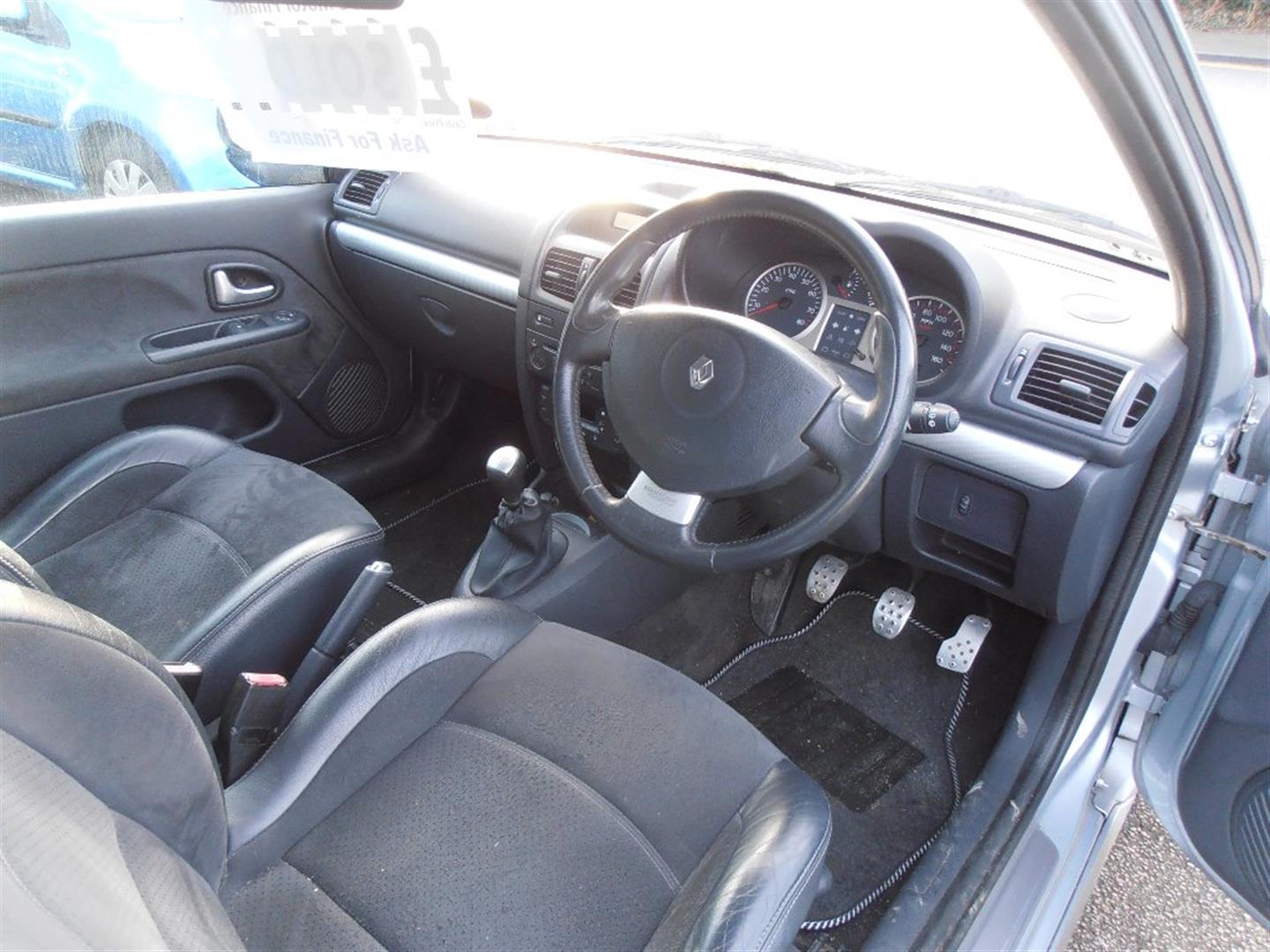

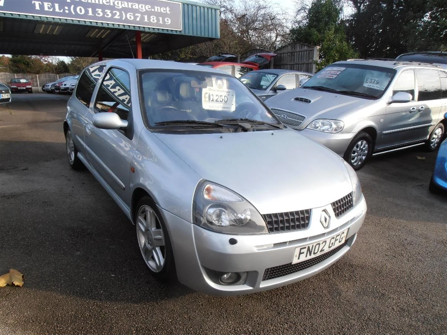

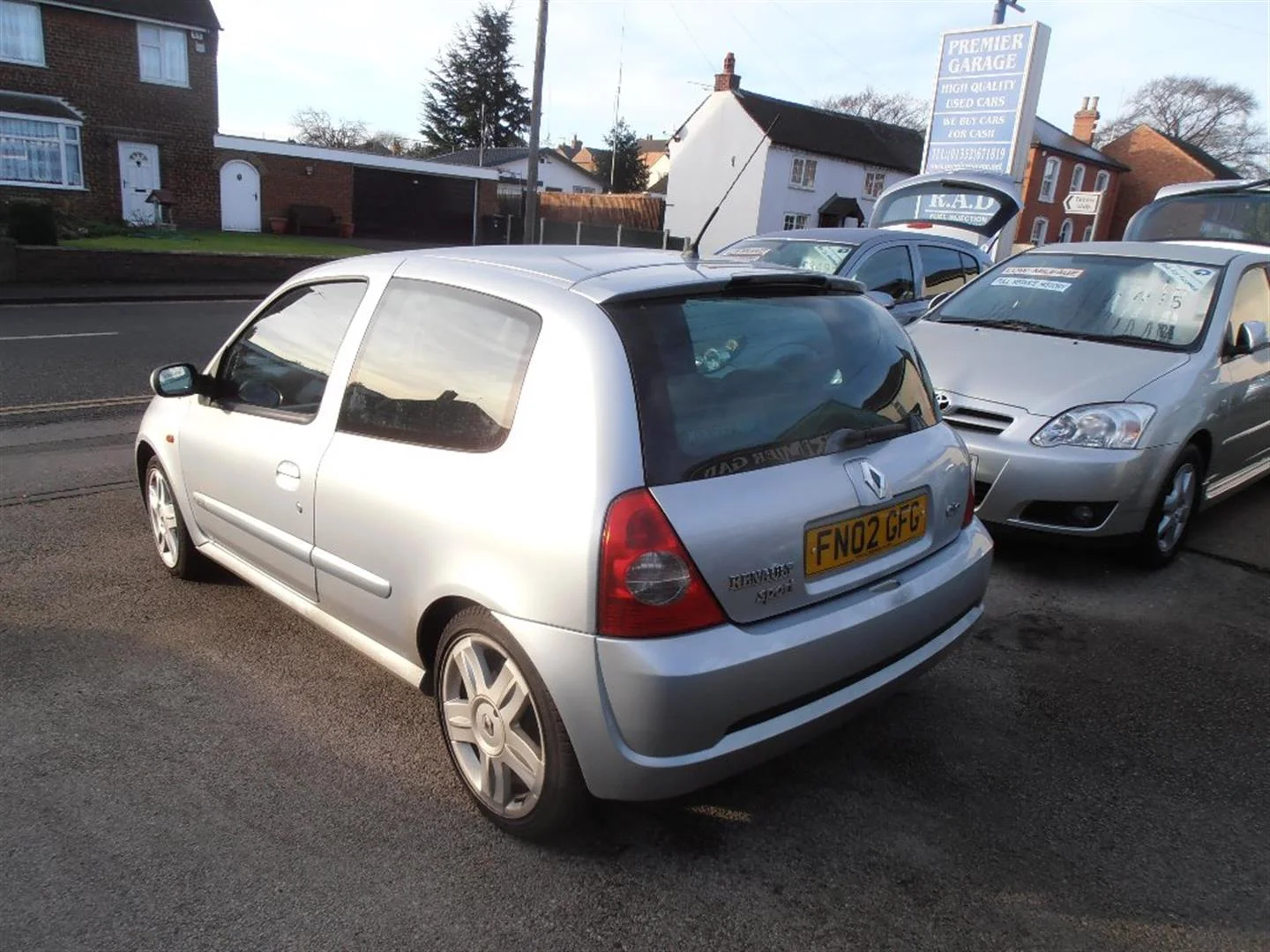

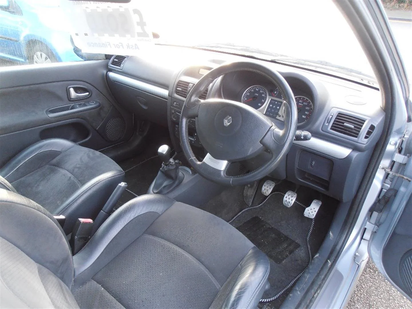

And this is it, 2002 172 with 65,000 miles on the clock. It came with no service history but for what i paid for it i was more than happy. I knew id be changing the belts and giving it a full over so i wasn't bothered.

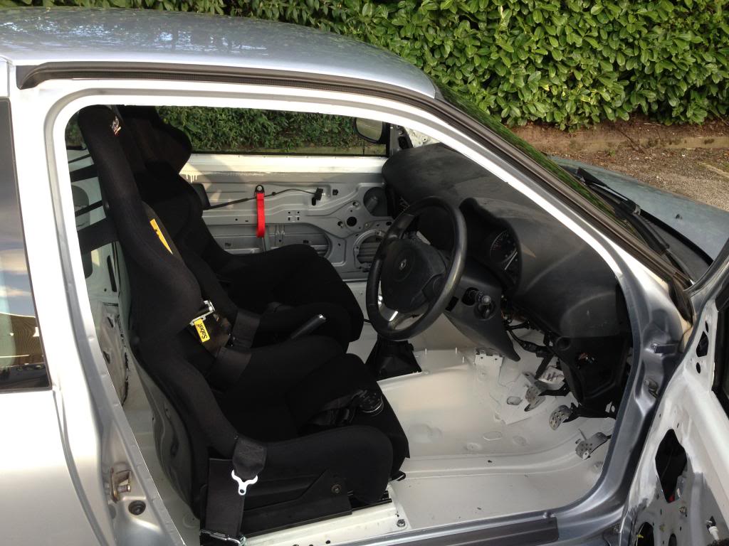

Thing ive already done:
stripped the car
removed sound deadening
fitted some team dynamic pro race 1.2's in black
fitted corbeau revenge seat
fitted short shifter kit
removed fog lights and wiring
removed xenon headlight washers and fitted carbon blanks
silvertec bulbs front and rear, clear side repeaters, white side light bulbs
fitted door straps
painted top and bottom grill gloss black
purchased coilovers
purchased rear strut brace
purchased 182 boot floor (no weight reason behind just prefer the look)
purchased some material for door cards
purchased sablet 6pt harnesses

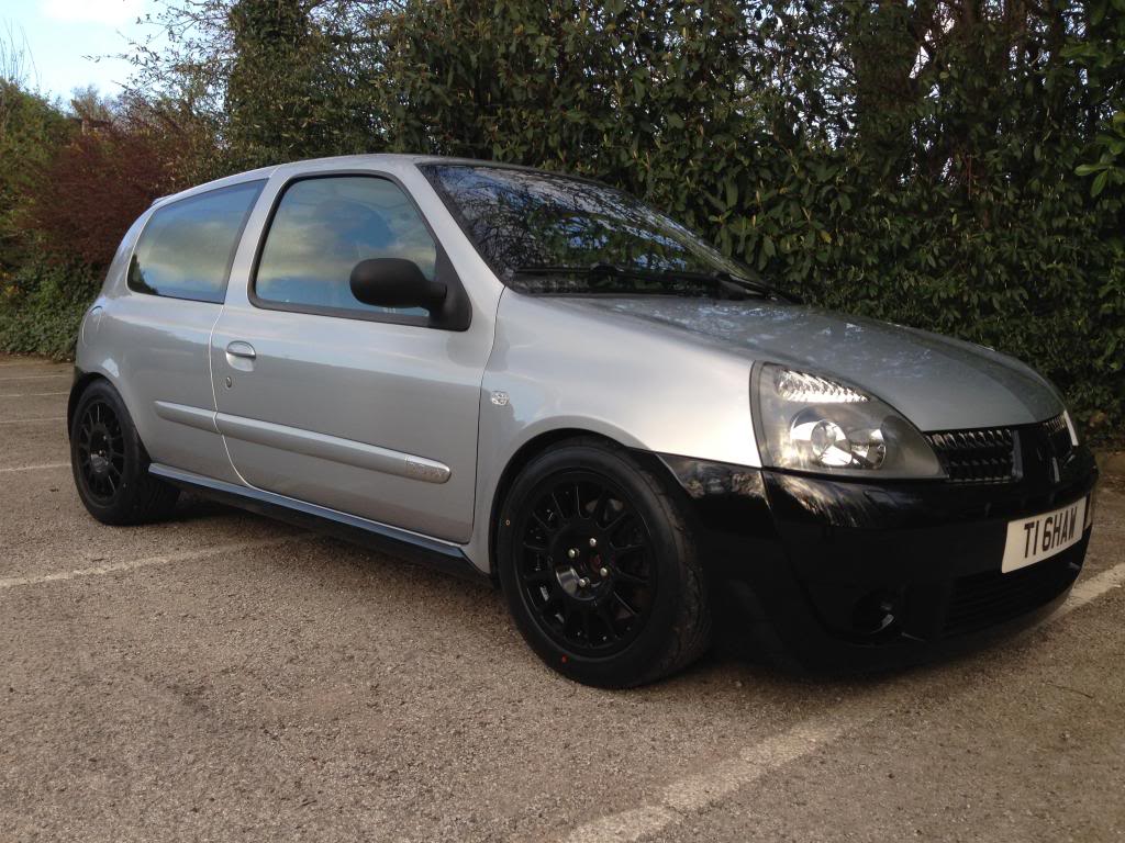

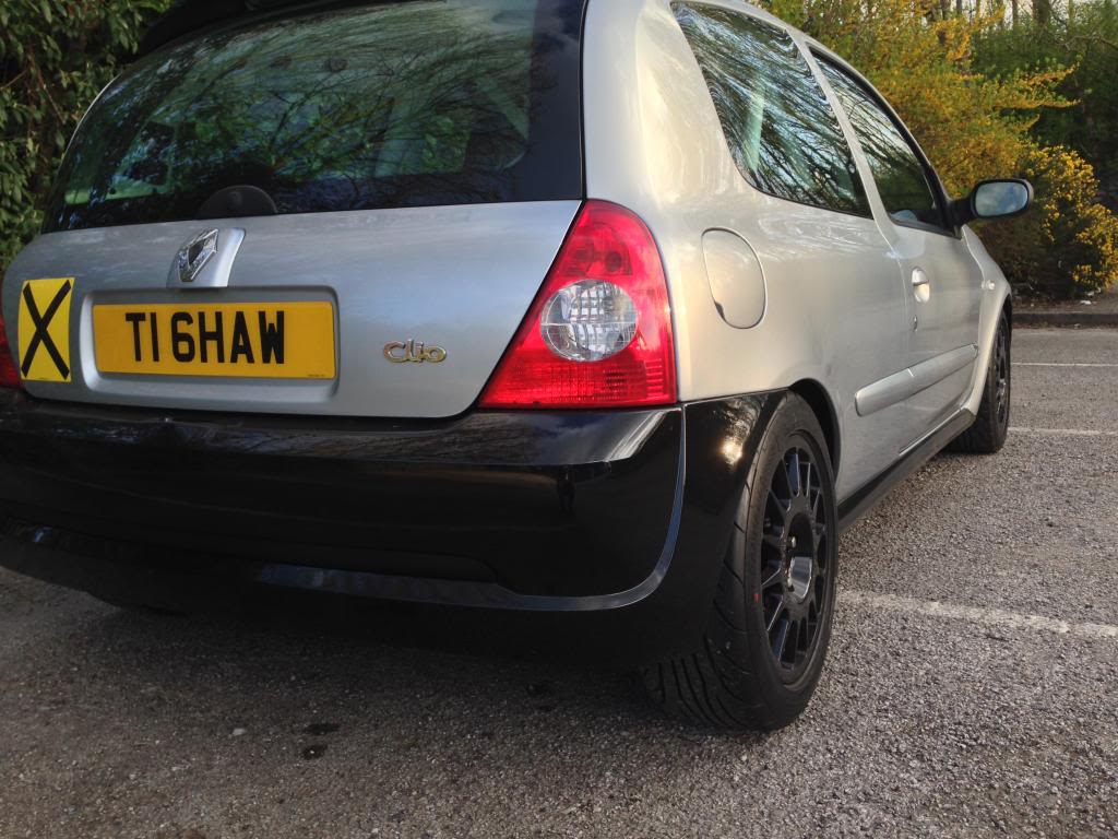

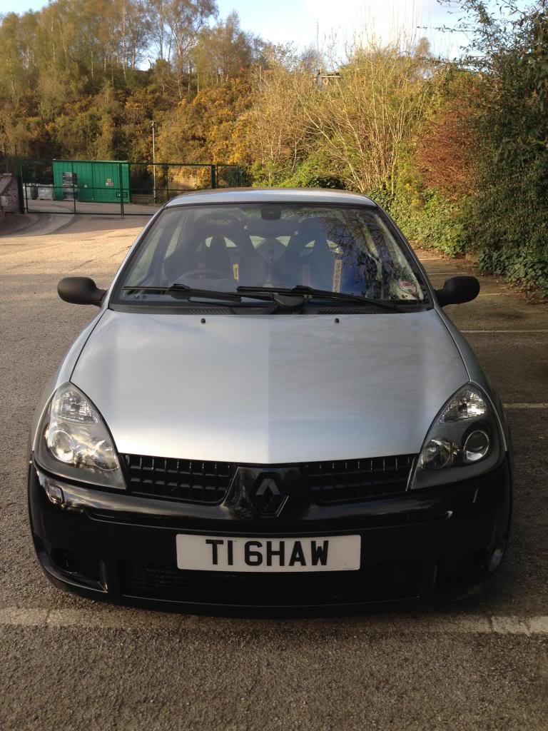

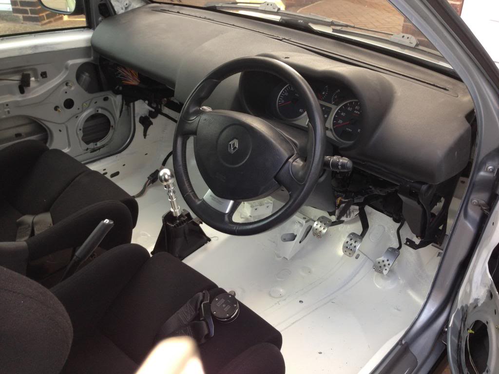

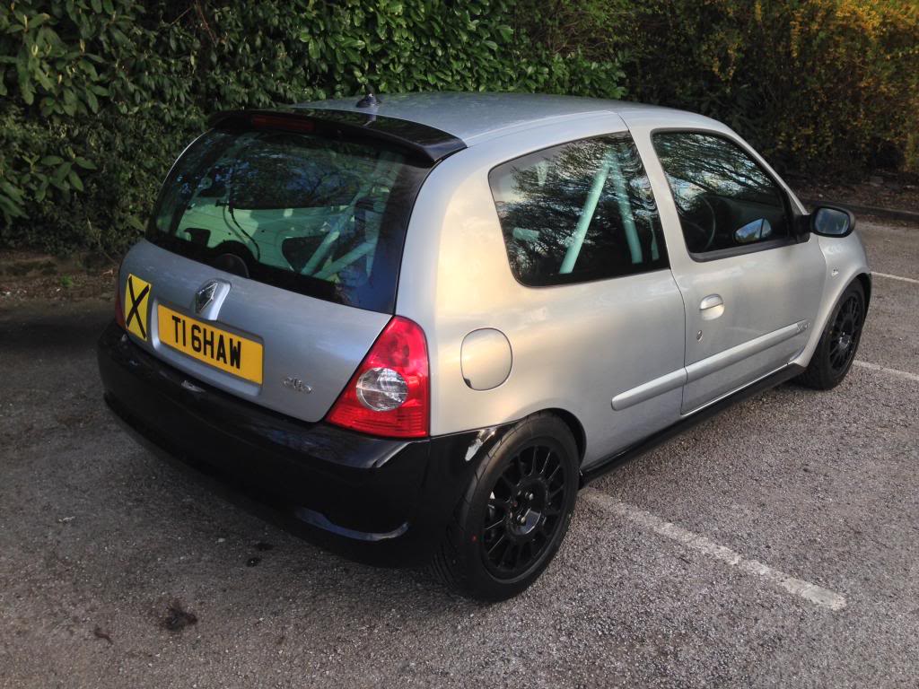

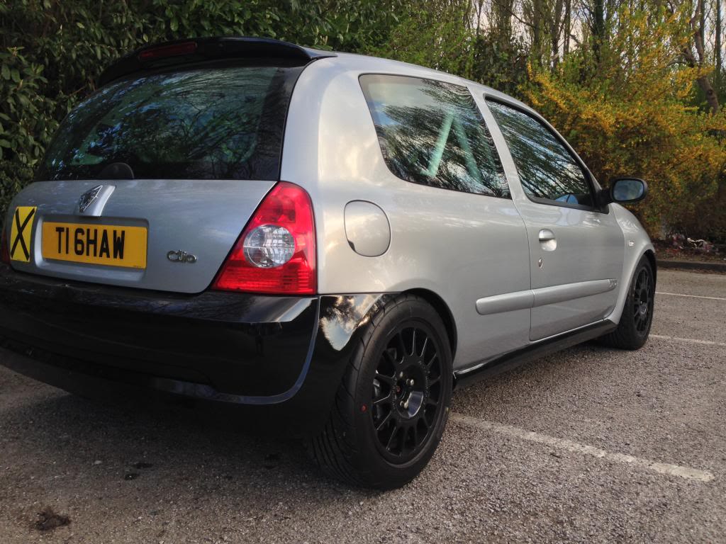

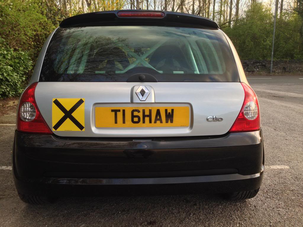

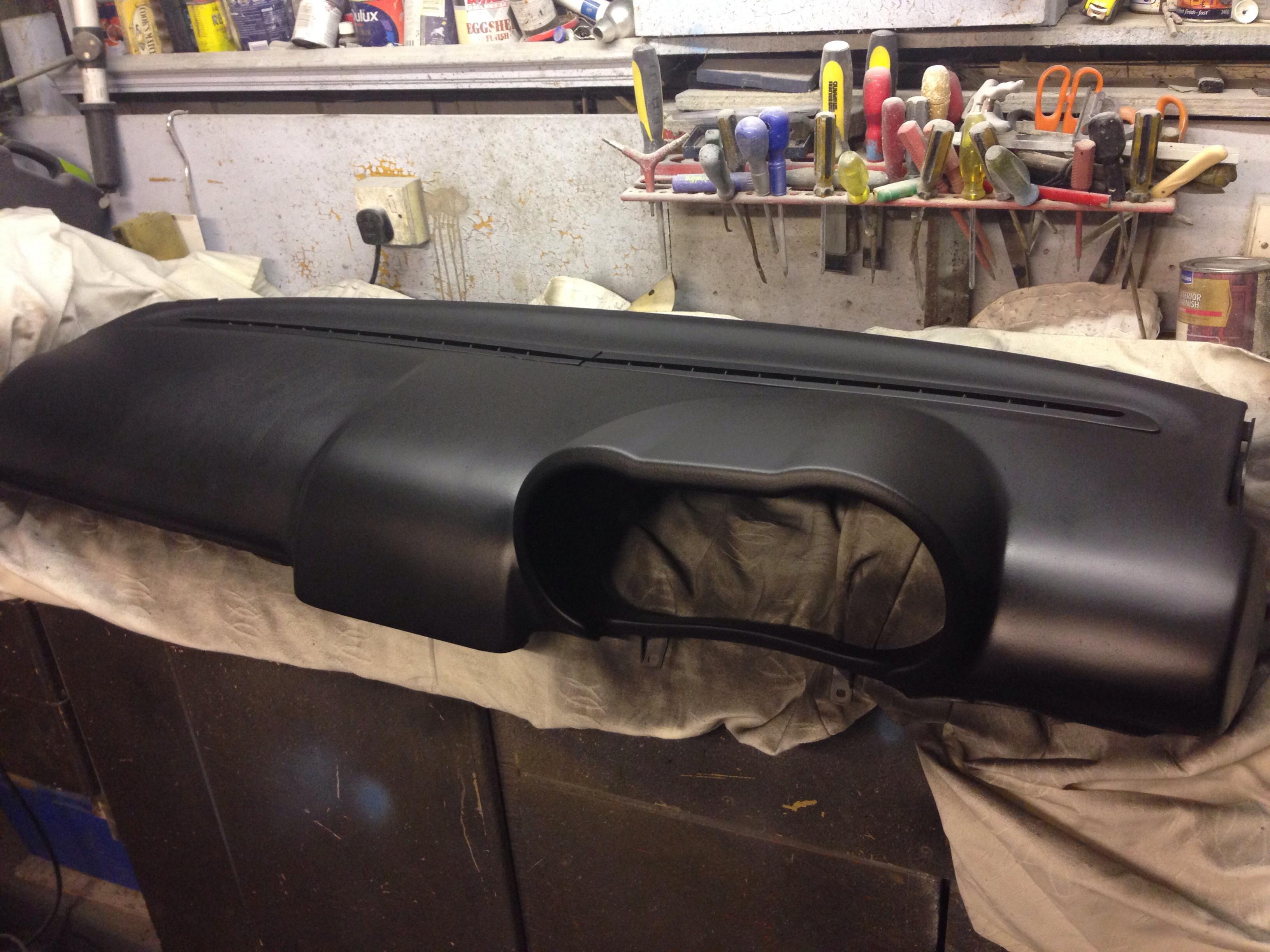

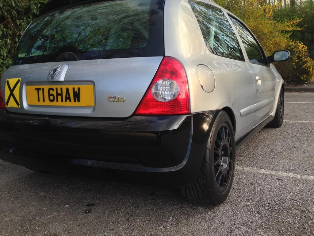

Just a few pictures to show how the cars getting on, fog light surrounds are getting painted. Had the suspension set up and camber sorted, gone for -1.5 on the fronts and 0 toe. Rear beam was pretty even so I've left that how it is. Took a few badges off, pulled some of the lauqer off so I've put the novice sticker on, why not! Private plates been fitted and also the rear strut brace. All the dash is out, doing something a but different, progress pics on that are below too, good and bad comments welcome, I know the plates illegal!
Cheers mate. The 182 boot floor will be going in this weekend fingers crossed along with the dash were slightly changing too. Still need to sort wiring out though, keep putting it off!

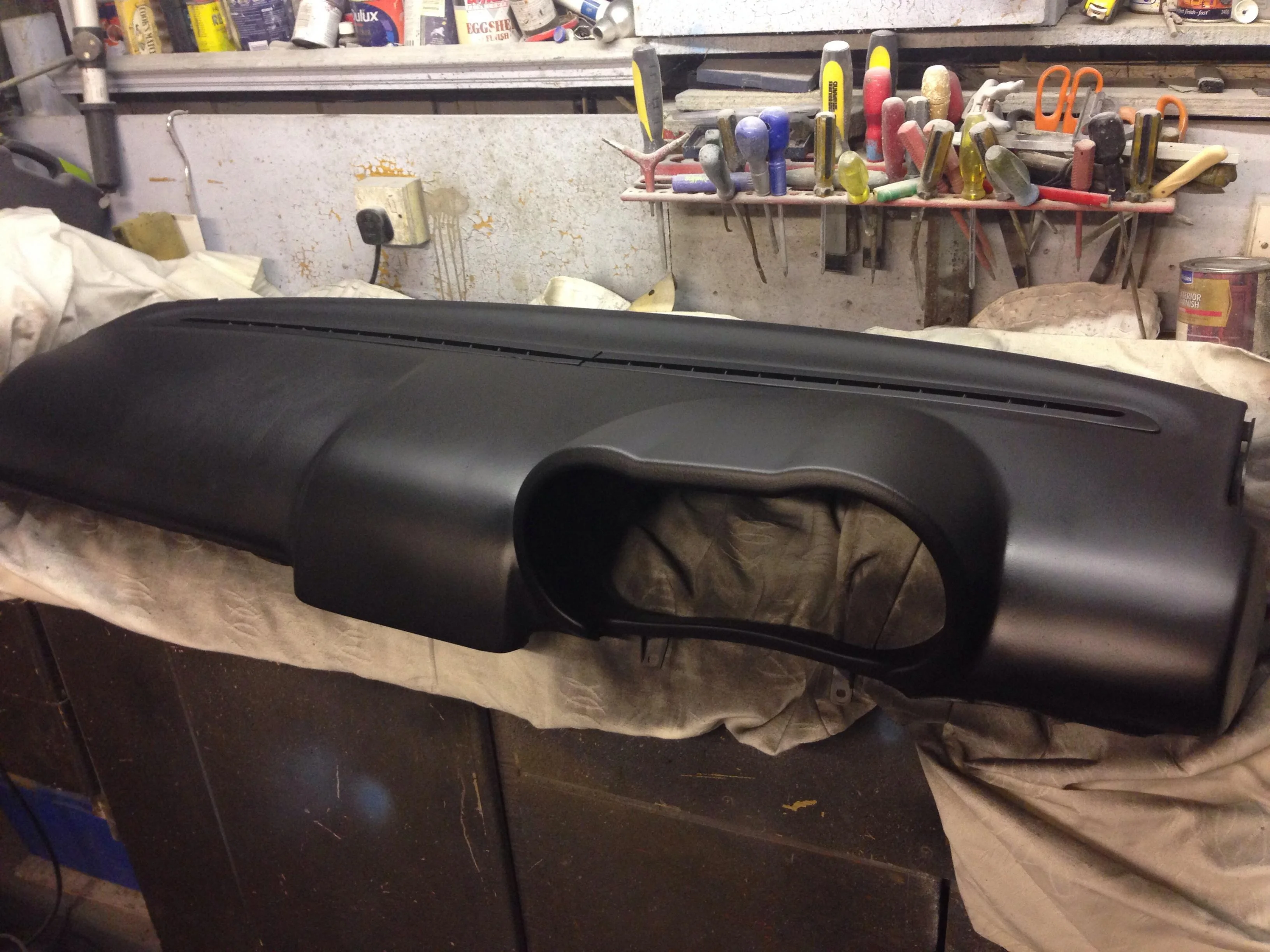

Picture of the nearly completed dash, only gave it a quick dusting of texture paint to see what it looks like, may get it flocked at a later date but for now it will be fine..

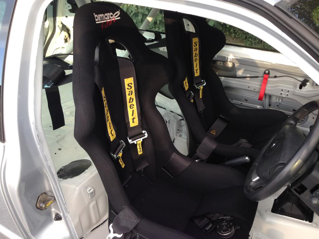

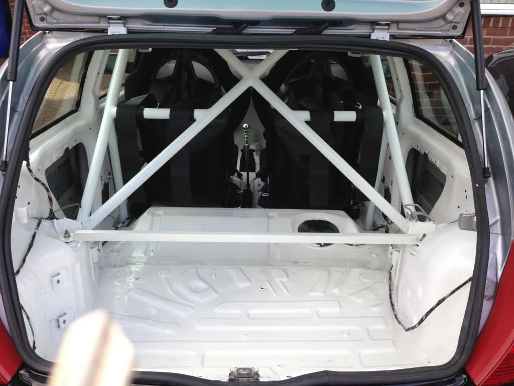

Been a long time since ive updated this thread, been busy both at work and with the clio. The dash is in, not 100% happy with it, it will be getting flocked in the near future, but for now its fine. Sourced a ph1 indicator stalk for when i change the wheel. Got half cage off ebay for 188 delivered which i didnt think was bad, so thats in. Fitted the futuras with the sabelt harnesses. Also picked up a cup spoiler so that was on the list to paint and fit. Painted little bits like the wing mirrors and nearly completed the interior with hammerite. 182 boot floor is in and really happy with it. Also fitted a ktec stealth which is a massive improvement over the previous exhaust..

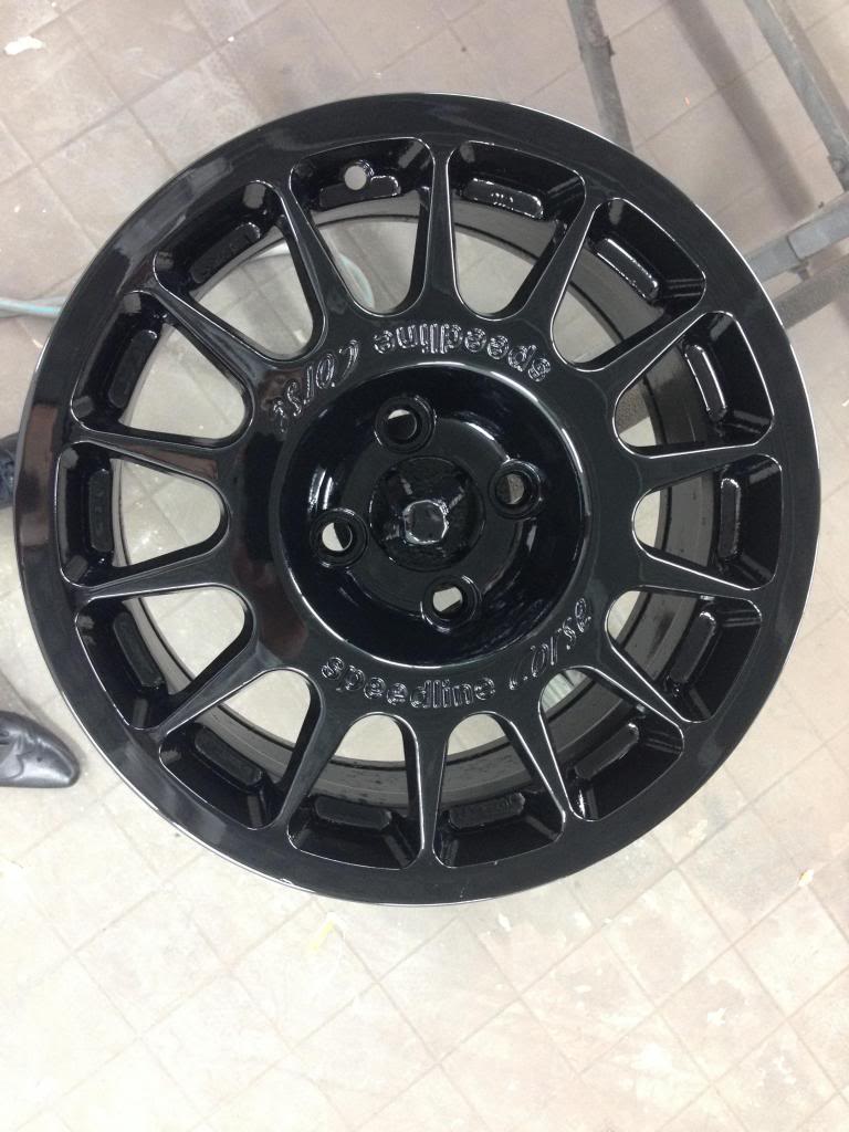

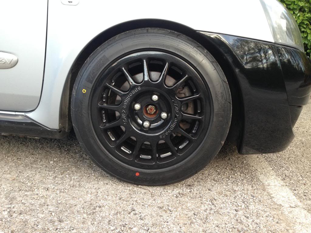

I managed to get hold of some euro spec 2118's. They were in desperate need of a refurb so i set about rubbing them down in my garage ready for paint. They arent perfect but for a track slaag im more than happy with them. Fitted 25mm spacers on the front and 15mm on the rears, whats peoples thoughts...too much on the front?
As for the tyres i thought id try the nankangs (ns2r's) so far im really happy with them to say they cost £65 a corner. While the wheels were in i wanted a few more bits painting, here's the outcome..
