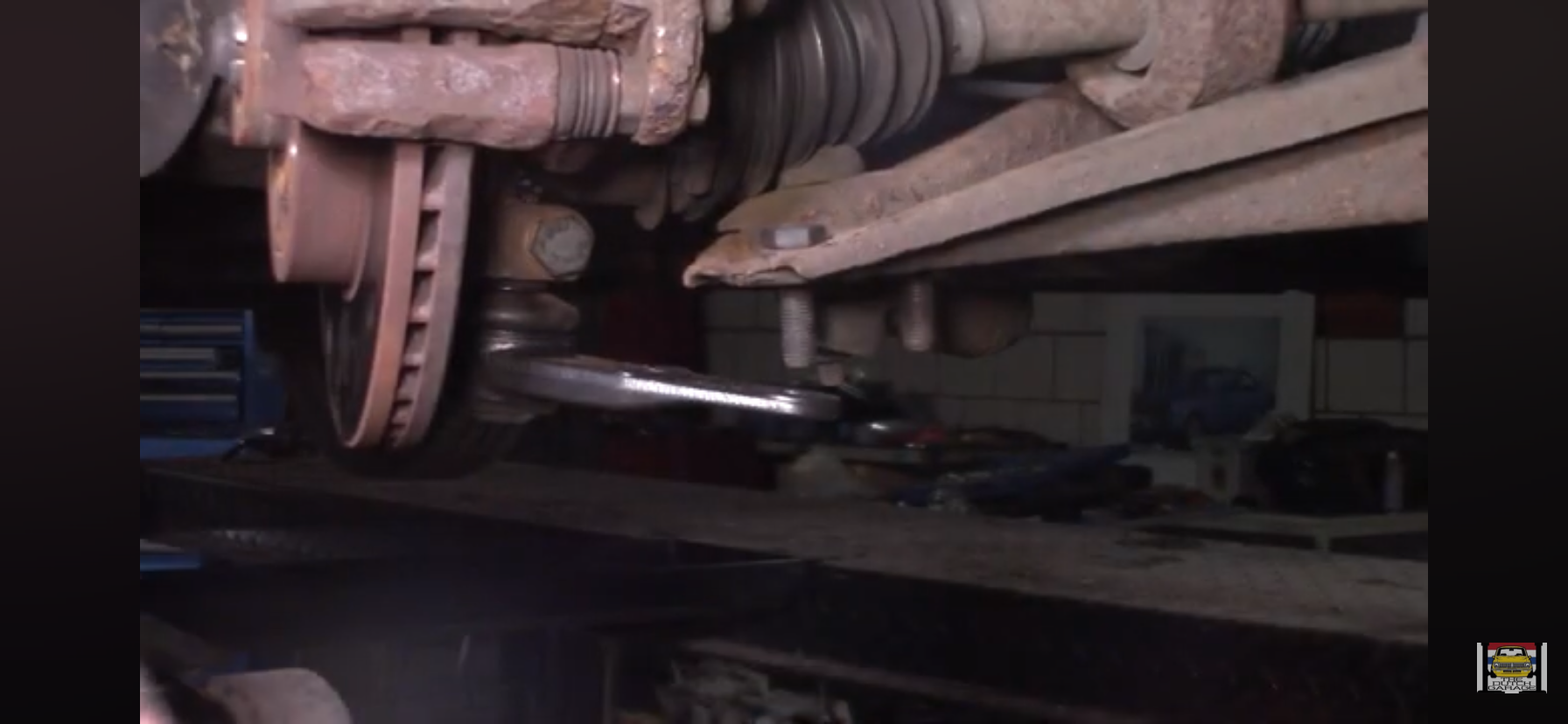

lee M4RSH
This is where I’m at.
Not my picture but looks exactly the same from a vid I have watched on YouTube but he skips past getting it in line 😒
How am I getting that to where it needs to be to get the nuts on the bottom of the lower arm?
Jamie86
  RS175,595,205gti,172
Get a jack under there and a long screwdriver to lever it across to get one bolt started.
