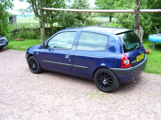

Here are the actual wheels on my old 1.2.
those tyres look fat! lol

They are fat! lol
195/50/R15 to be precise - They should be more comfortable and should be able to cope with the poor surfaces like on the 1.2. And about the 15's on the continent, You learn something every day! :approve:
