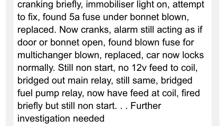

Here is a summary from the AA guy of what he did

I have a problem with feed to coil pack too, but I have no warning lights and no blown fuses, no alarm or immobiliser issues, just seems to be intermittent no feed to coil pack.
