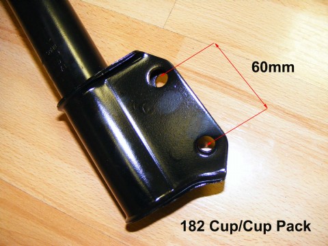

Does anyone have an image of which part I am meant to measure for 60mm on hub spacing so I can send to the seller before I make the journey?

Perfect thanks for such a quick help guys I take it that is the back end of the shock?
Thanks so much!
You're fitting Ktek coilovers anyway, so does it matter so much if the car has the cup pack fitted?
All you need is a set of cup hubs and you're sorted.
Yes, driveshafts and spoiler:
The series requires the eligible car to be the 182 CUP variant, however a 182 sport can be used provided the CUP options are fitted, pertaining to the Front suspension Hubs, flanges, and drive-shafts and rear wing. Other ‘CUP’ requirements on trim and accessories are not perceived as relavent and thus do not need to be evident.
