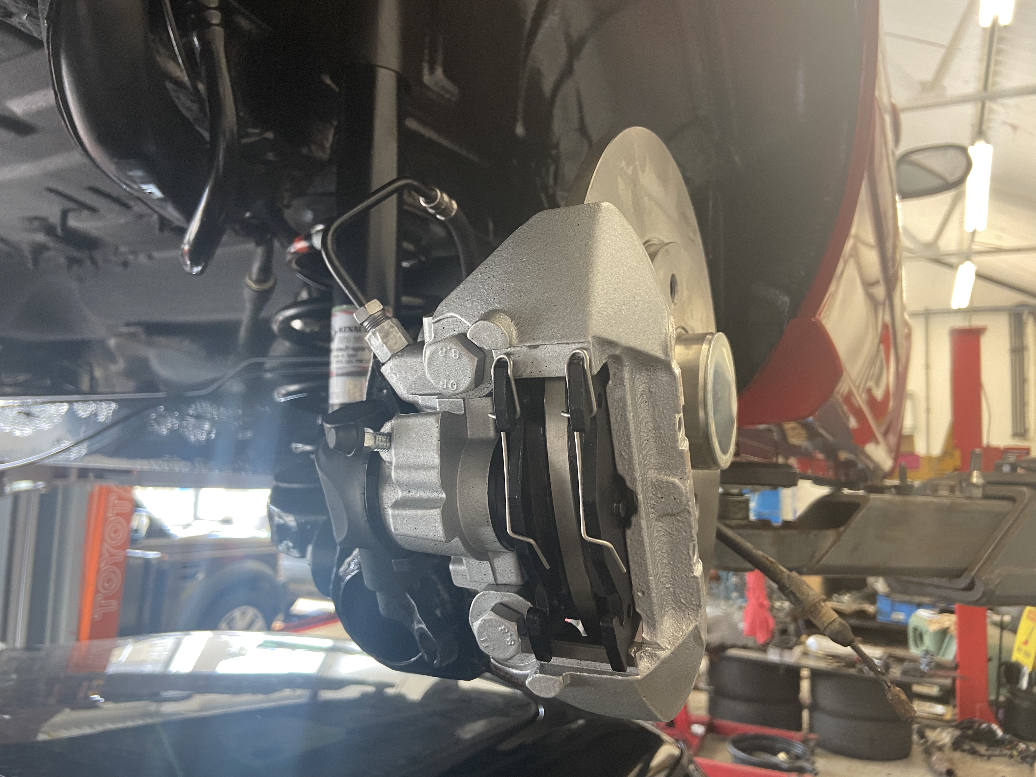

Had my front brake pipes made up Louis by the garage who is doing my Restoration - I managed to buy the two rears new which really do look great.

No at Parkside garage Huddersfield (Landrover specialist) - I really don’t think they can be bought new as I tried for mine and like most things now on a 20 year old car there N/A
