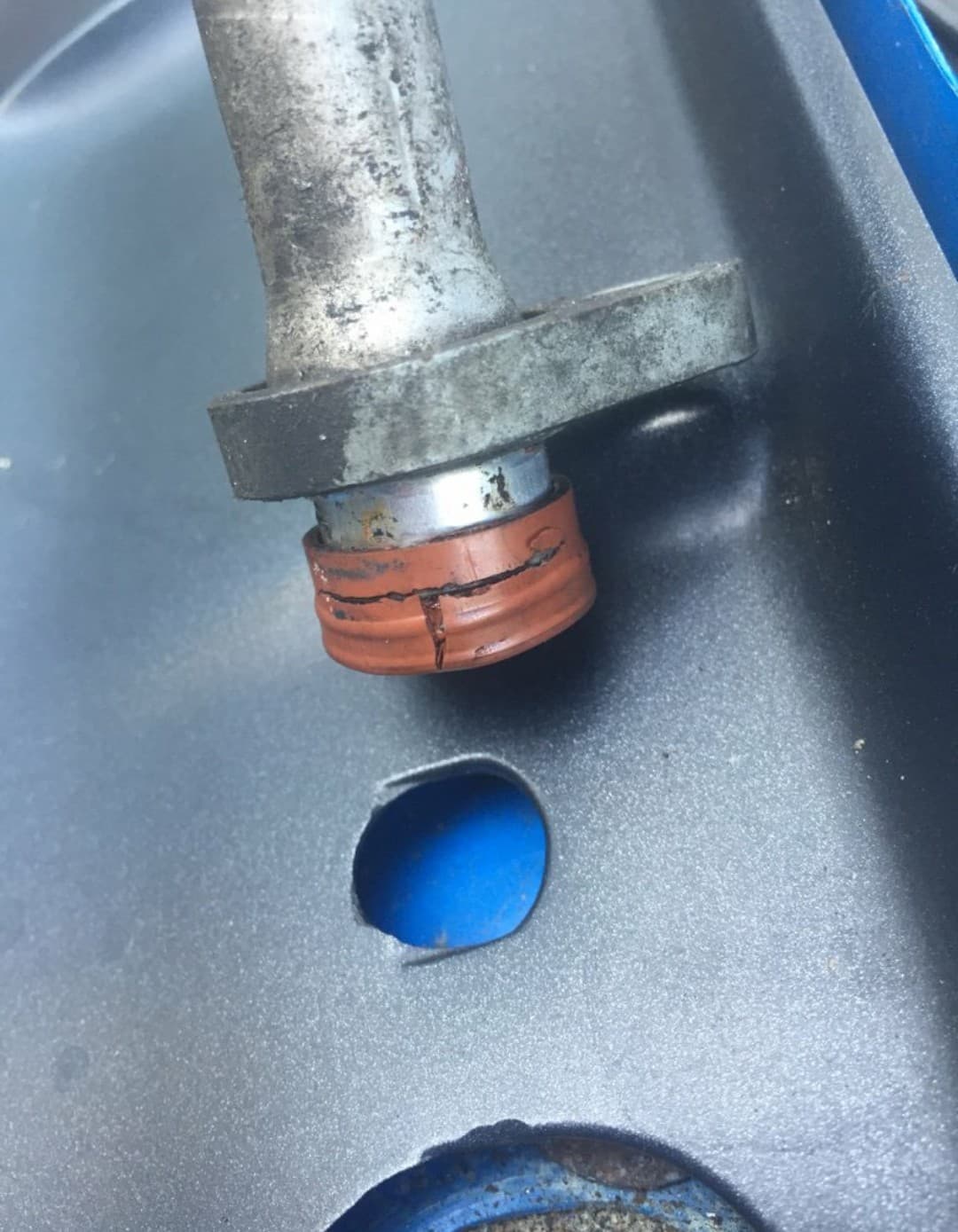

This year I'm determined to have working AC for the one week of summer we get. I'm going to go through and replace all of the seals before recharging it else I'm sure it'll probably leak out within a week.
I'm struggling to find the right part numbers though. I understand I need to order two seal kits - one with standard o rings, and another with the larger/wider seals. I've found the o ring kit at RPD (link), but I'm not sure about the second. RPD have a listing for a similar looking type of seal to what I need (link), but they only list compatibility with the MK2 Megane. I've had a search through the forum but haven't found what I'm looking for.

Here's a pic of the type of seal I'm struggling to find (borrowed from off here!).

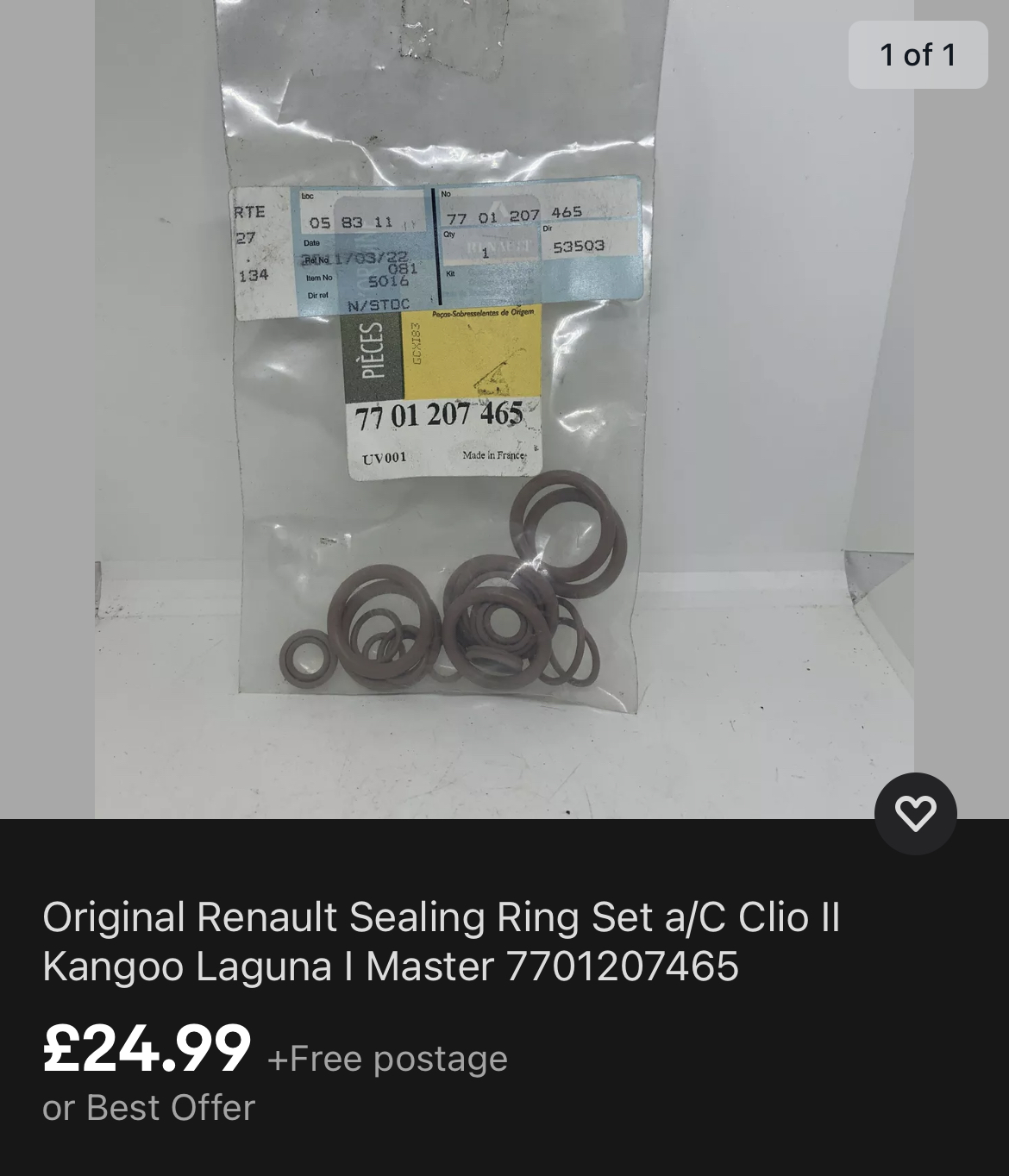

Not just me then, I've struggled to find them anywhere! Think I'll do as you said and see if I can get some rough measurements off the eBay seller. Your link for them is fairly cheap (compared to RPD) so it might be worth a punt if it sounds like they're in the ballpark.
Cheers @MarcB - I'll take a look on eBay for the o ring kit, better price than RPD by the time you've put shipping on too.

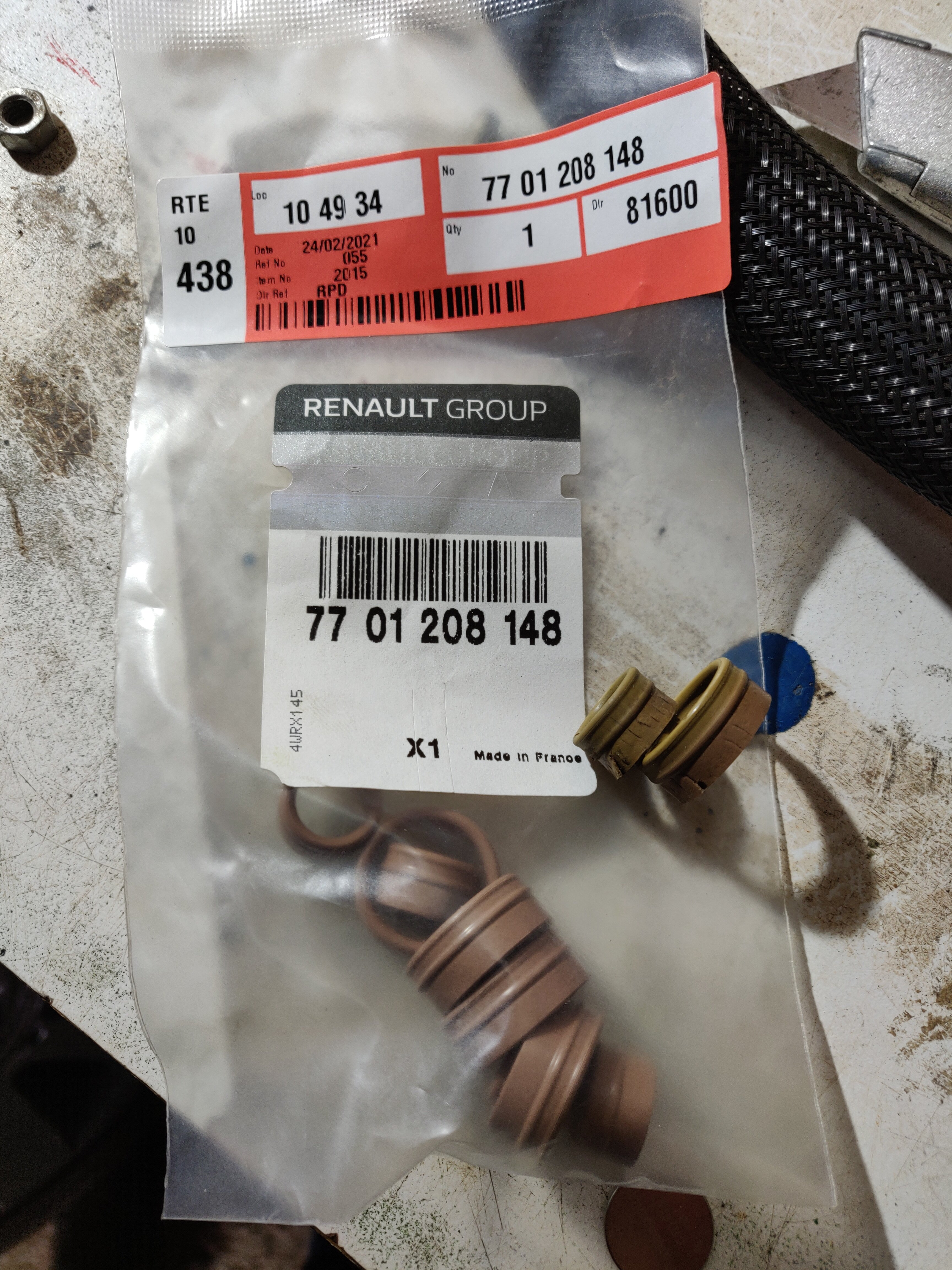

Haven't fitted any parts yet, but have had the old seals off and compared em to the new seals. They seem to be exactly the same part so I'd say the Mégane seals are suitable for use on the Clio compressor lines.
The old seals are a bit of a pain to take off as they have a metal ring inside the rubber and are quite a tight fit to the AC pipe. Add to that there was a bunch of corrosion and dried up oil crap holding mine on. Gently gripping them with a set of mole grips and twisting them off seemed to do the trick though.

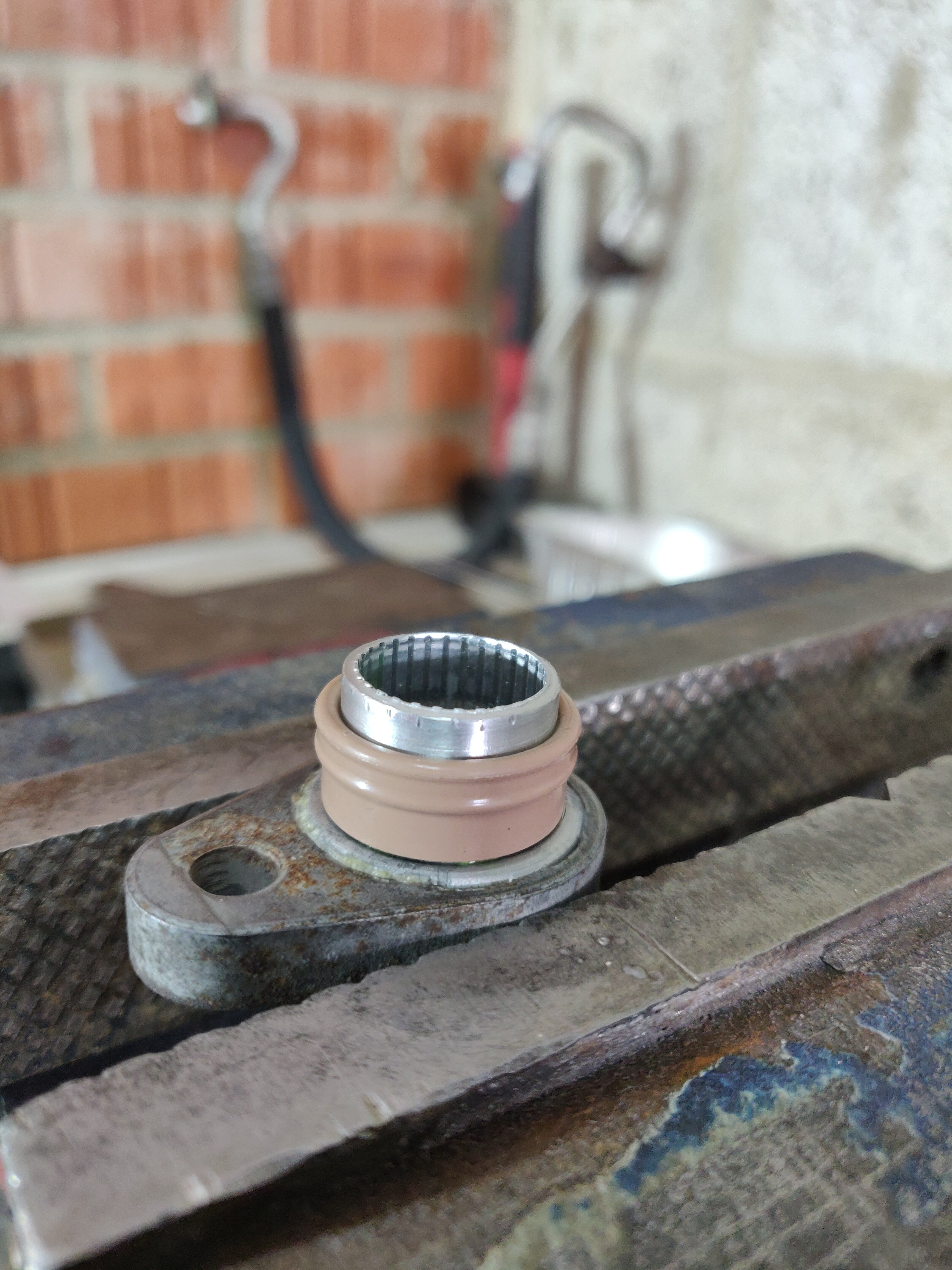

Yep they're a perfect fit, definitely the right part.
Can be a little awkward to install. The trick is to clean everything up until it's spotless, then:
  • Add plenty of PAG oil over the faces which will slide over eachother.
  • Grip the outside of the seal with a microfibre cloth or similar.
  • Slide the seal on with a twisting motion - no way it'll go just trying to shove it straight on.

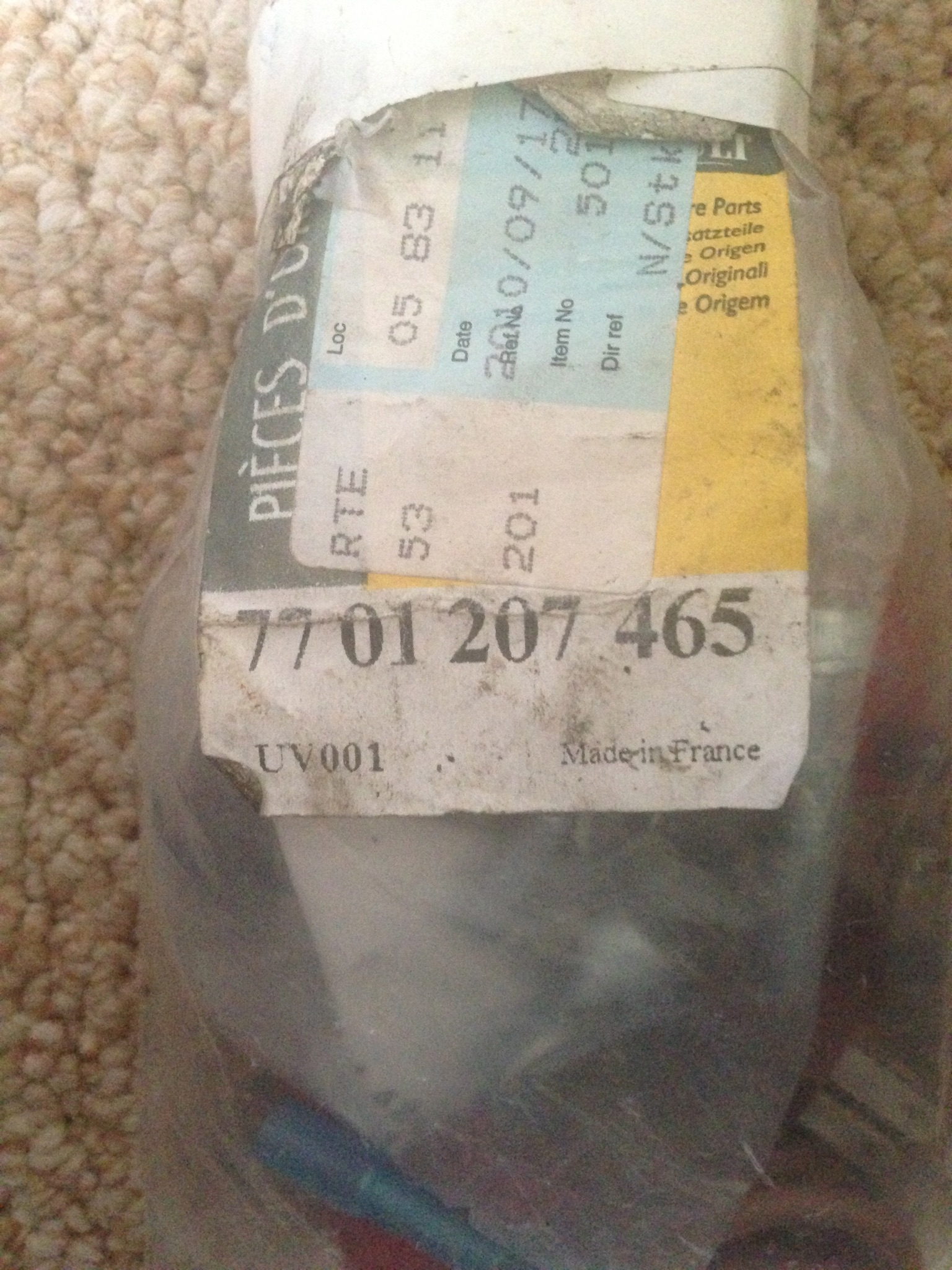

Just realised the part numbers aren't actually written down in this thread, so I'll put em here to help the search function out:
The "wide" seals which go on the compressor connections are Renault part number: 7701208148
These are listed on RPD as a Mégane part, but they're definitely right for the 182. I imagine the 172 is exactly the same.
You'll also need the o-ring kit for the remaining seals, Renault part number: 7701207465
