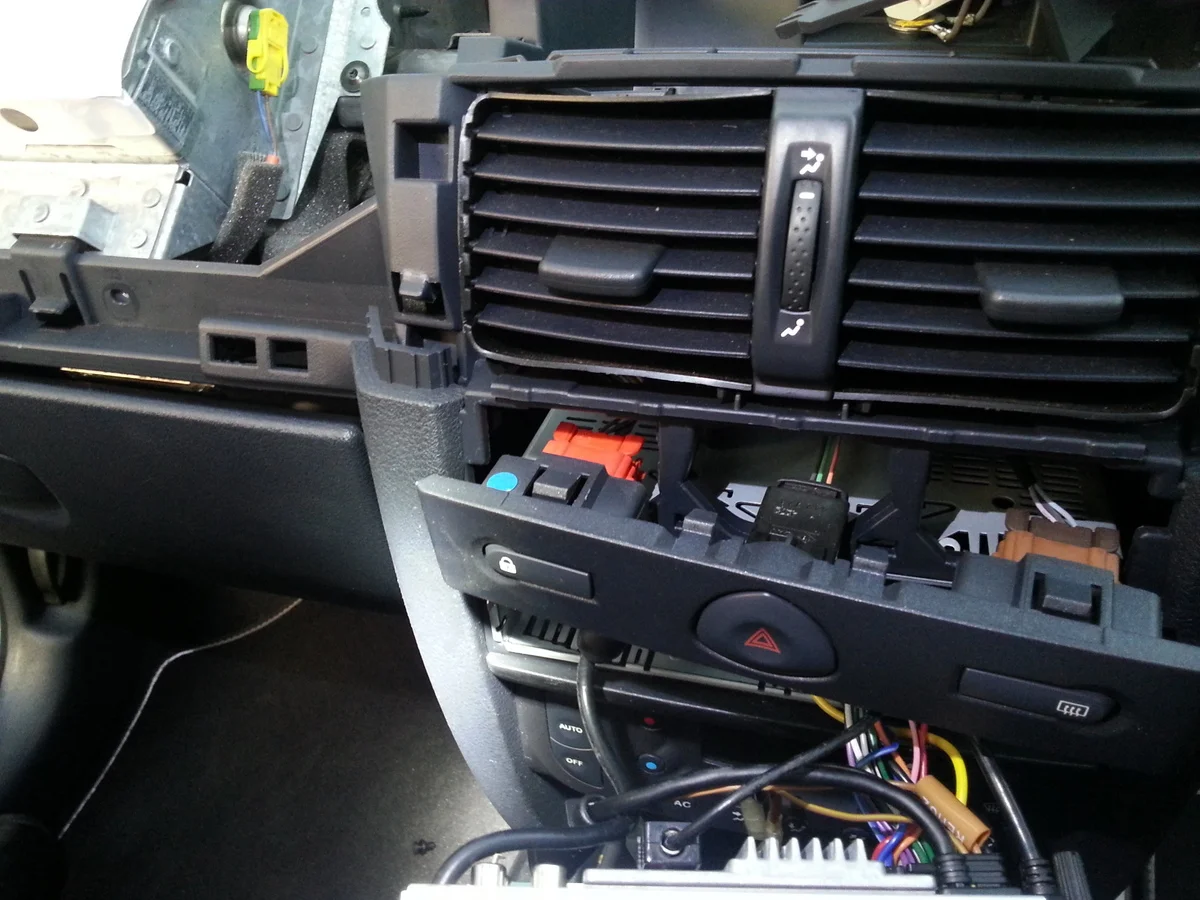

Update:
Problem fixed.
Read a guide in work quickly about how to remove the dash. I had to start there as that's the only time anything ever went wrong when doing work on the car.
Finished work at 8, got home and started on the car by 8:30 and had the battery disconnected, dashboard off, fixed the problem and had it totally reassembled by 9:45.
It's serious what you hear about these French cars, the bits really are snap off, snap on.
Upshot of all this is if/when the bulbs behind my clock go, I know how to get to it all. Might swap them out for some blue ones now. :)
The orange connector to the central locking button had come off during my war with getting the head unit back in 2 months back and that broke the whole system.
Also explains why the button stopped working and I popped the fuse. :o Shamefully I only spotted the button wasn't working a week or so ago when I stopped to pick up passengers.
No matter, all good now. One for the r****d mistakes.
