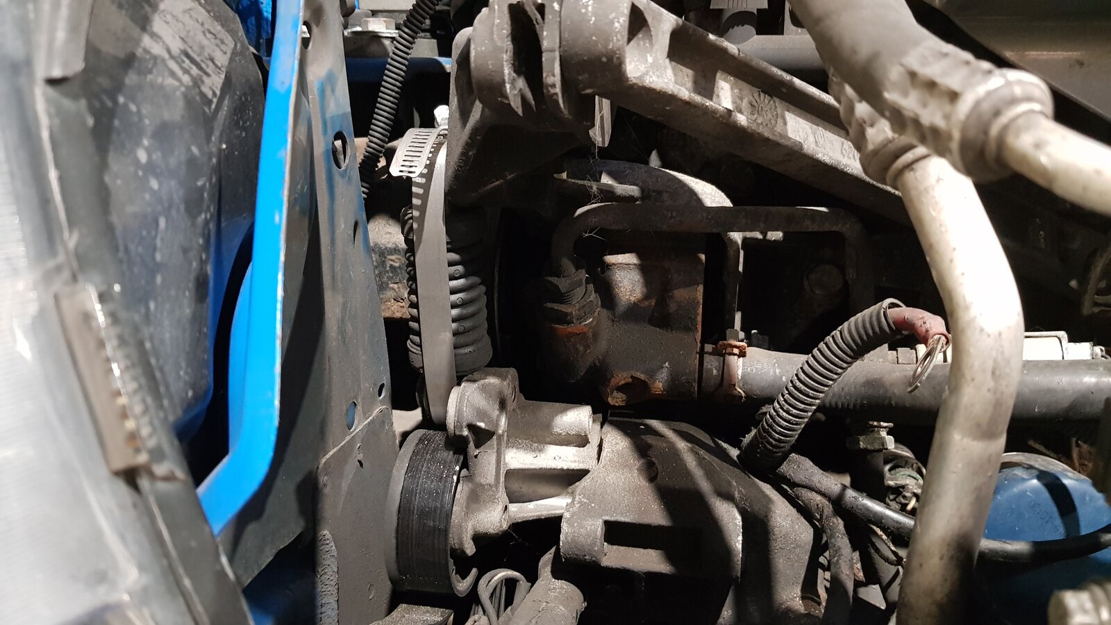

Ok this is not as gruelling as everyone is making out...
The best way I found to do this was ......
1. Disconnect battery positive & negative
2. remove plastic grill (unclip lugs behind )
3. Remove 5 x13mm bolts from slam panel 4 at the top 1 just in front of air con rad,
4 remove 2x 10mm bolts to free bonnet catch (slam panel now free)
The alternator is now more accessible.
5. Undo the positive 13mm nut to the alternator/ unplug connector
6. Now I used 70-90mm jubilee clip and it held fine, place clip around the top and bottom of the spring tighten until it's just holding careful not to over tighten!

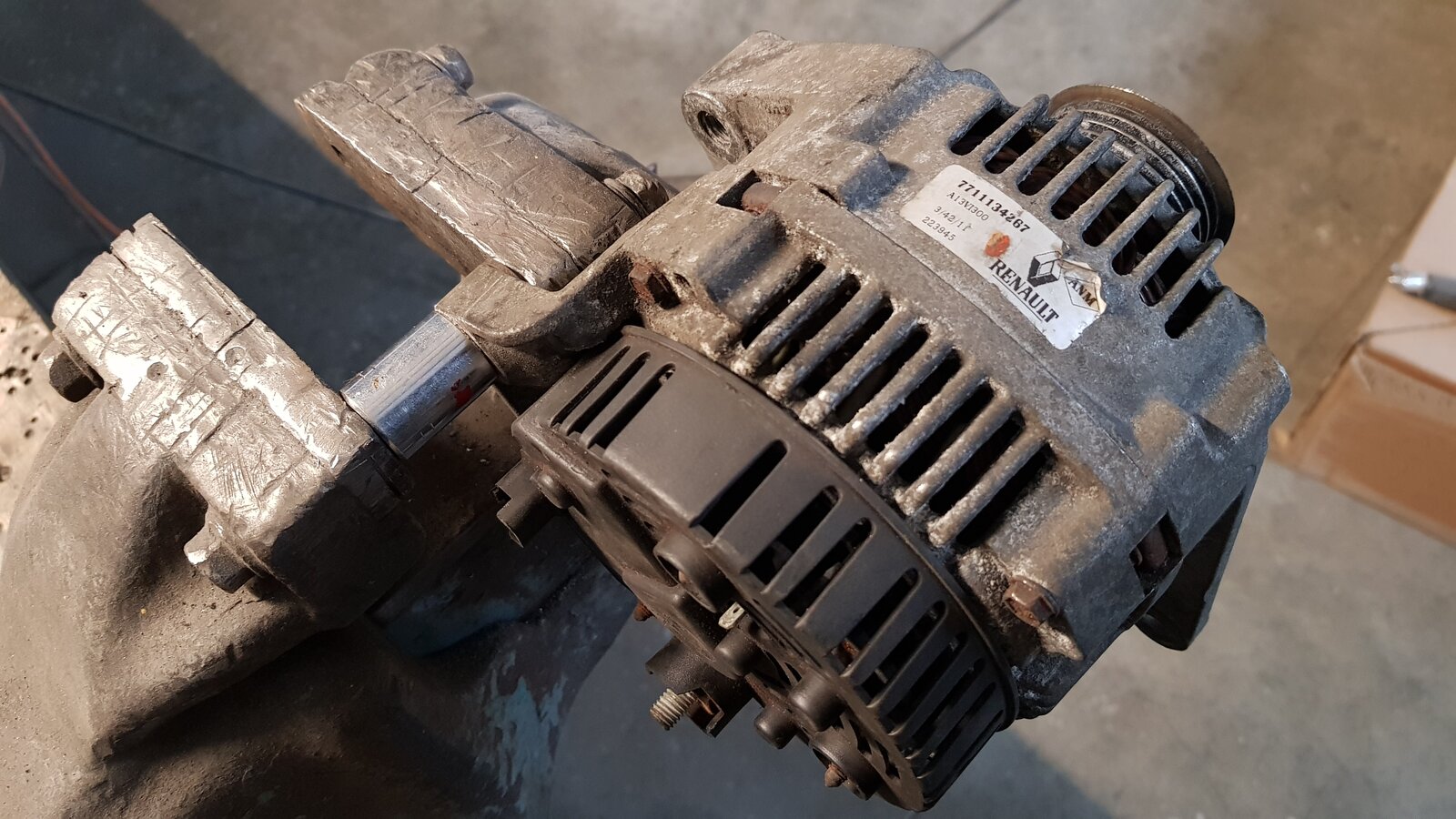

7. Unbolt alternator top bolt 13mm pull top of the alternator towards you the belt should slacken enough to remove it from the pulley then do the same for the bottom 16mm bolt undo and remove alternator will now pull free, ease it out carefully as the air on pipes will foul slightly. Anymore info pm !
Bumping up a old post/thread but I just want to add that the last post/post above is the perfect way to get the alternator out on a 172/182 with air con.
I did it recently and this worked well. I did remove the engine bolts and jack up the engine/sump to get more access, but upon refitting, I didnt bother. Its tight, but moveable.
I'd also recommend pushing the metal sleeve in place. It makes fitting the alternator into its lower position a lot easier. I used a socket and vice, but im sure a tap with a hammer and drift would work also.
