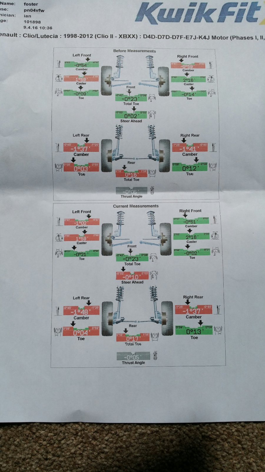

Just had mine done at kwik fit and I've no idea what it should look like. Not even sure if they've been checked against the correct model. Told him it was cup spec and he said there was no option.
Having serious issues where the car tries to turn 90 degrees when braking hard, can't see this being the issue with these specs though?
Take no notice of the bottom one as this is after I was pulling on everything checking for anything lose whilst it was up in the air.
Here`s the geometry specs,but sounds like you have a brake problem.

Looks like a s**t job that, your toe alignment was better before the adjustment. Should be around 5 minutes toe out each side.
Check the specs in the PDF contained in the link I posted on post 2 of this thread.Hope you find it usefull.
