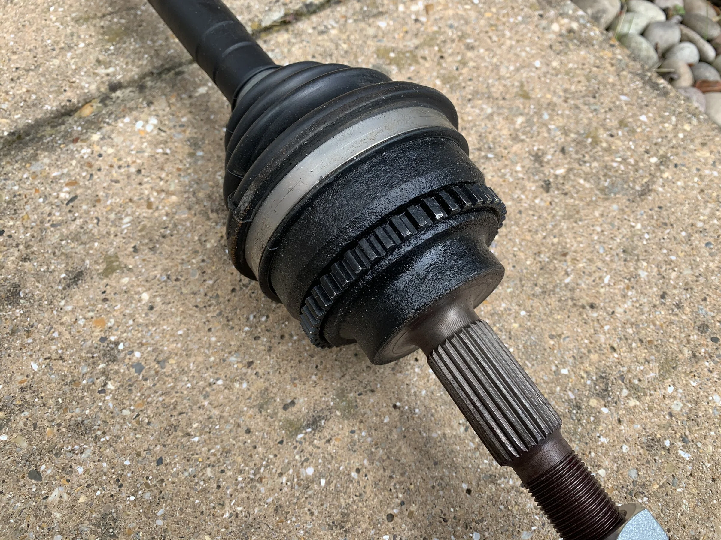

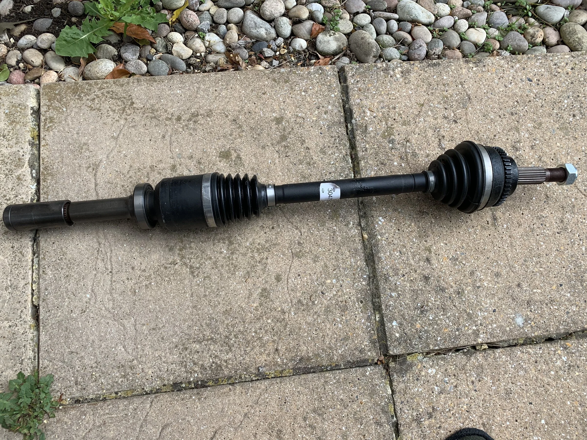

About 3 or 4 weeks ago, I went onto ECP website and saw a GKN item available, which I bought, thinking the specs were correct with what I expected a 182 Cup driveshaft to be.
Today, I looked at the specs on their website again, and see that they list this as a replacement for OE part number 8200352042 which is a Non-Cup driveshaft (clearly missed this when I purchased).
So my question; do I need to return this driveshaft because it will not be compatible?
I've not even attempted to fit the GKN item yet so no idea if it even matches up or whatever. But if I know for definite it won't, would rather just return it for a refund whilst it is new and boxed.
From what I have read, the main difference between the "Cup" & "Non-Cup" O/S driveshaft is the ABS rings, with Cup ones being thicker? This new driveshaft appears to have thinner rings?
If this is the case, would I get away with just replacing the ABS ring for something like this ?? Or is this not possible?

Pictures of the new driveshaft for reference, below.

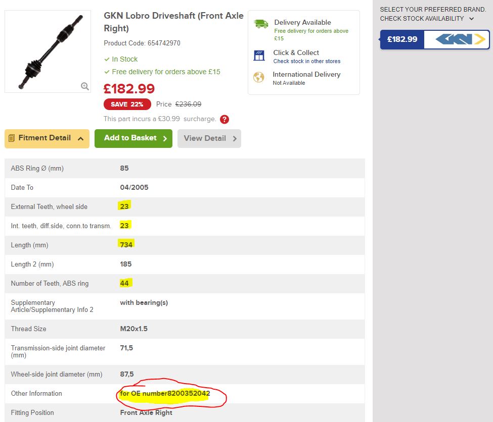

The driveshaft in question is the right hand side/OS driveshaft I bought from ECP, brand GKN - screenshot of it from ECP website below.
I have circled the part where it shows as being a replacement for OE Number 8200352042 i.e. a "Non-Cup" driveshaft. I have also highlighted some of the other stats (length; no. of ABS ring teeth etc) which we will get to in a sec.

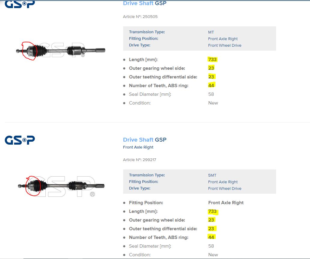

I came across some driveshafts made by a company called GSP.
They list at least 2 for a Mk2 Clio Sport 2.0 16v, as shown below.
I have highlighted the stats on each one which show identical numbers. I have also circled the ABS ring on each, one of them is evidently thinner (for 172 & non-Cup 182) and one is the thicker (for 182 cup/cup pack/trophy).
The above would seem to suggest/confirm that the right hand driveshaft for all Ph2 172/182 (excluding 172 Cup as no ABS) are essentially the same, with the ABS rings being the only difference.

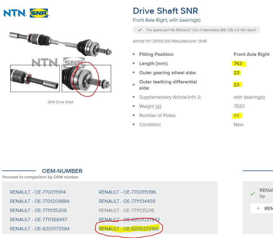

One final test then, is a shaft made by SNR which I came across - picture of this below.
The picture clearly shows it with a thicker 15mm (i.e. "Cup") ABS ring, which I have circled.
I have also circled the OE equivalent part number; 8200372166 which is for a "Cup" driveshaft.
When you then look at the specs (length, no. of ABS ring teeth etc) which I have also highlighted, everything agrees with the specs of the GKN & GSP options above, aside from the length. I believe this is a typo and is supposed to read 733mm or 736mm. Obviously I can't confirm that for sure, but think I can be reasonably confident this is the case. It certainly looks very similar to all the others.

So, what is the point in all the above and what does it show?
Essentially, it confirms that the driveshaft is the same for all Ph2 172/182's (except for the 172 Cup - no ABS) with the only difference being that the 182 Cup, Cup Packed and Trophy models have thicker 15mm ABS rings; the rest thinner 7.5mm ABS rings.
What this means for me, is that I do not have to return the GKN driveshaft I bought from ECP, which I thought I might have to as it is listed as a replacement for the Renault part number for a "Non-Cup" driveshaft, and has the thinner ABS ring fitted.
