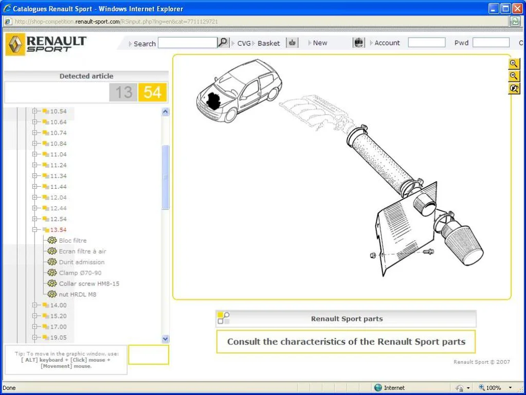

I think originally that would have had a long pipe with the filter sat inside the blocked off area forward of the turret
Yeah I thought that, I think they used to have a green filter sat down there.
What is the original cup filter setup? I know everyone says its the V6 box but im yet to see one fitted, I always thought it was a long piece of silicon behind the headlight with a green filter on the end?
its a rubber hose (both ends cut on an angle), 2 jubilee clips, and a V6 box hooked upto the headlight blank
