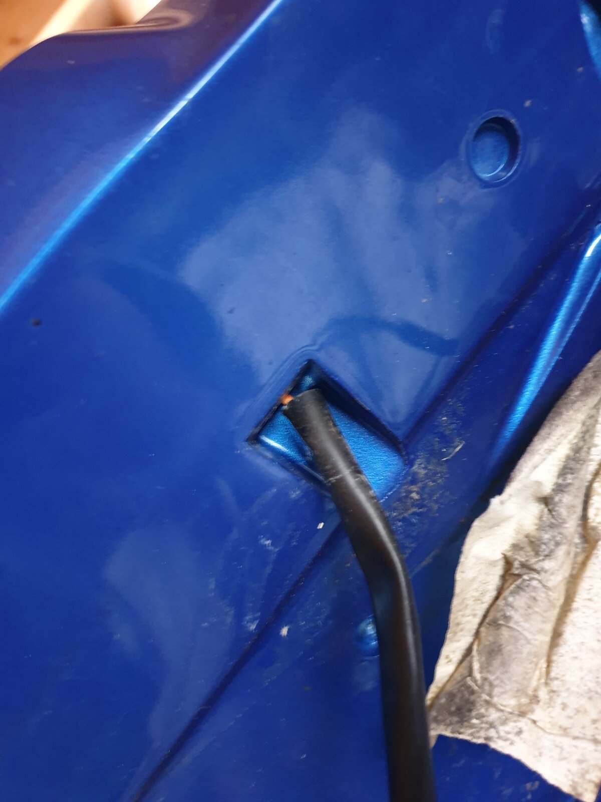

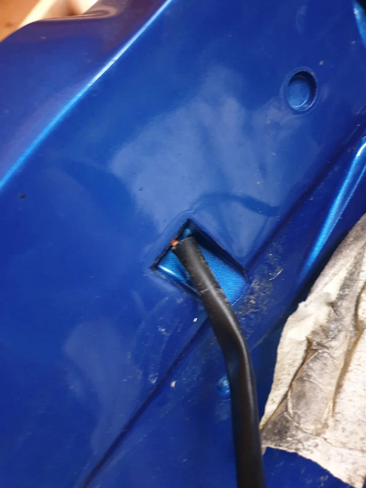

Remove the whole spoiler and theres a hole at the back you can shove a pen through
i think i see the hole but there's boy enough space to get a pen behind there

When I did it there was a hole on the other side not just where the cable went through
well i finally managed to do it without no Pen, it was a real pain tho, i think i might make a thread about it, it was si f**king stressful, but im glad to now having my 3rd brake light working

Had a look at photos and I did remove it through the cable hole. There was loads of room for me
