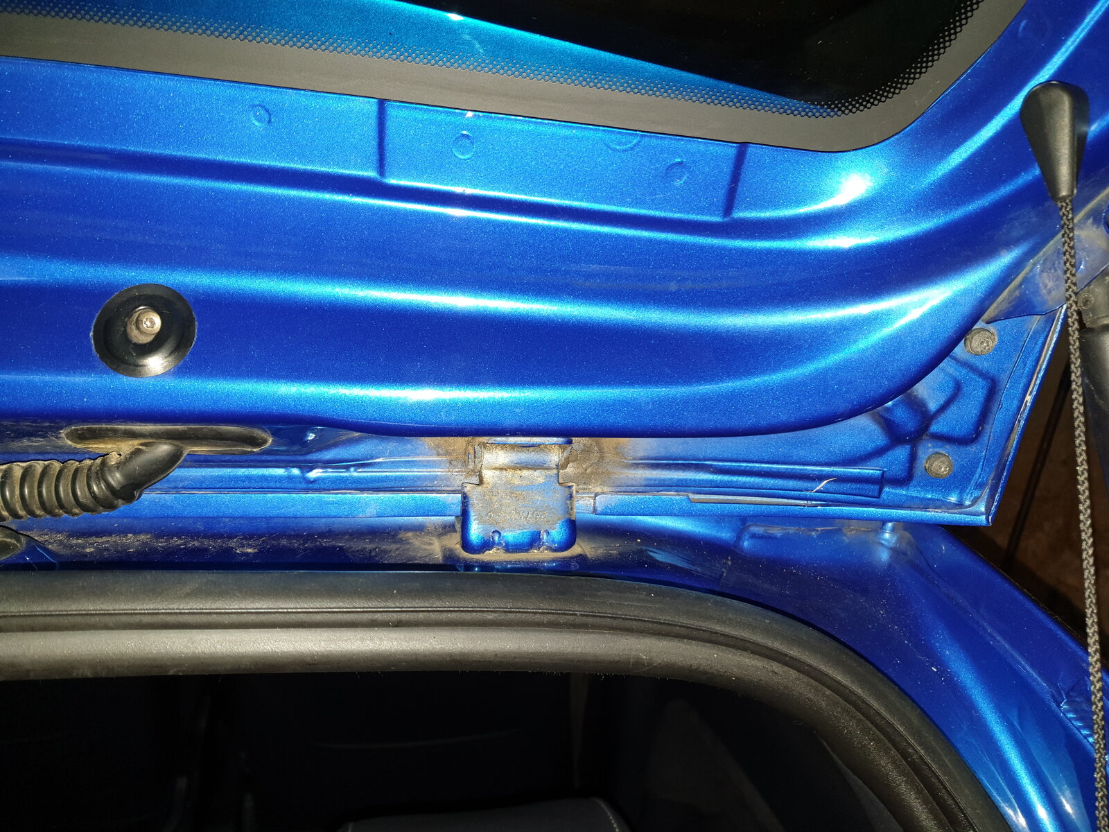

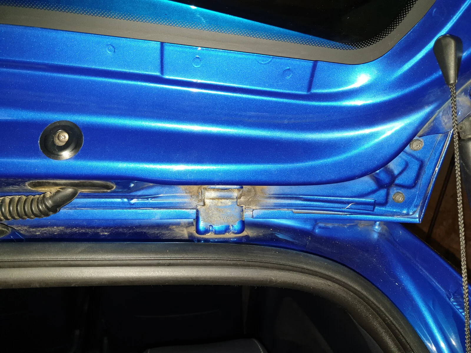

Once that's done, you need a screwdriver and T20 socket to go along with it. Open your boot, there are 6 screws to remove, here are the 3 of the right side, same story on the other side.
Once that's done your filthy spoiler is out, good job, but that was the easiest part. Give it a clean whilst you're at it.

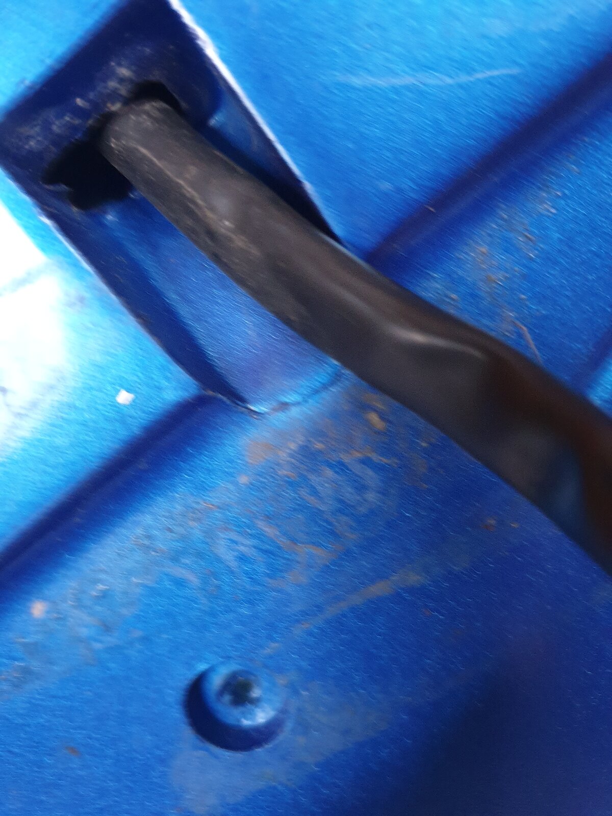

So now you really have two options, some other users have used a pen through the hole where the orange connector goes into, and pushed the brake light out, through that hole. I wasnt able to do it.

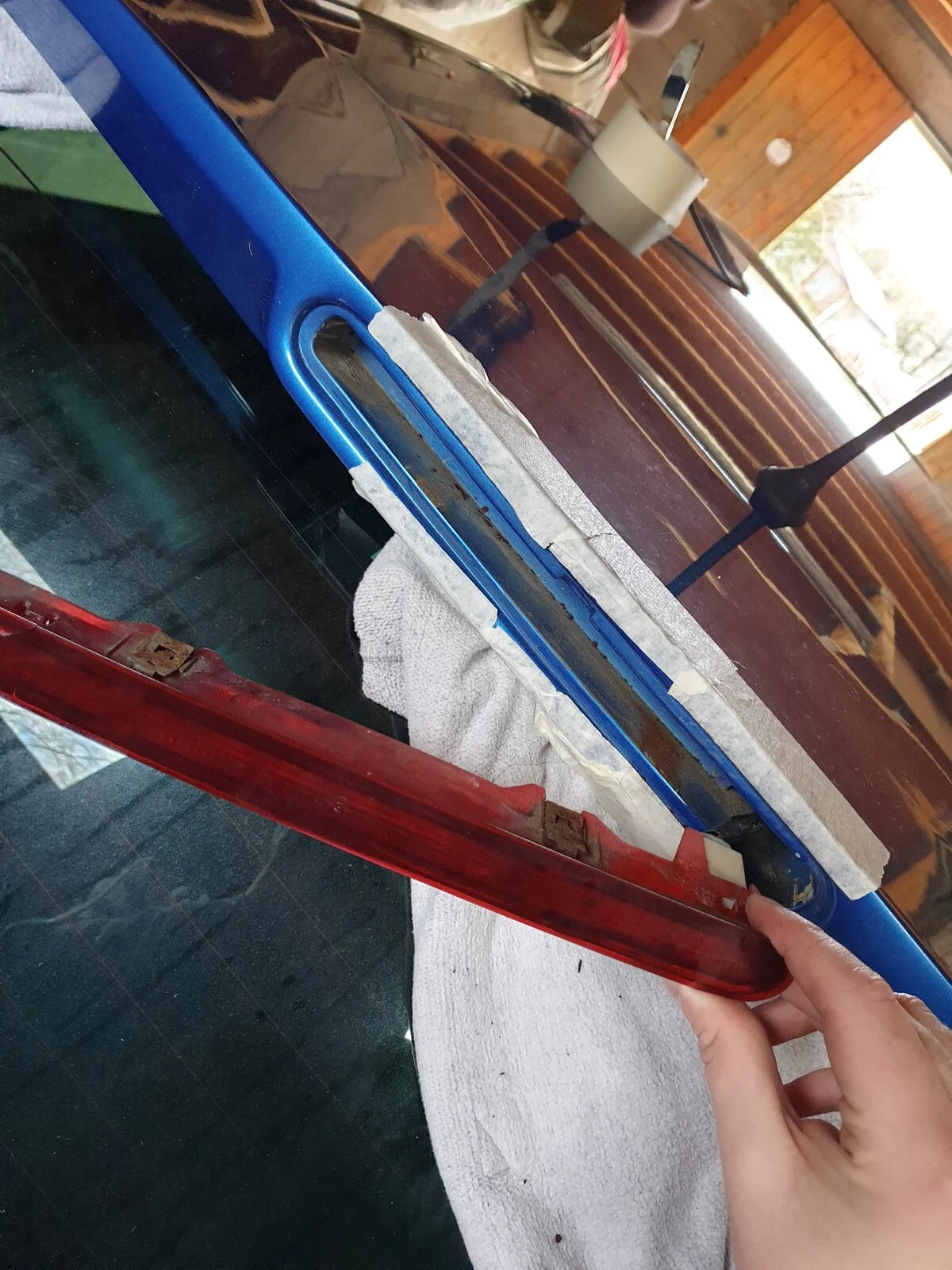

If like me the pen method didnt work, now you'll need a butter knife and a spatula (yes i know right ? ^^) and some masking tape, you really dont have to use the exact same things i did, but that worked for me, a plastic wallpaper remover would have been better but i didnt have any.

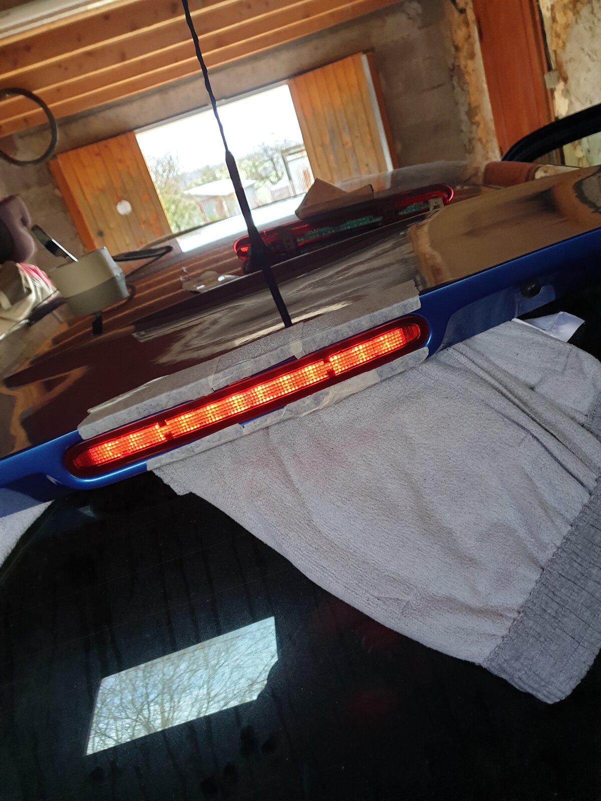

1)So use the masking tape all around the brake light to avoid you ruining your spoiler.
2)Leverage is your real tool, you need to be real patient and gentle, use the butter knife against the brake light (non cutting side always aims UP so you avoid cutting in the spoiler, i say that because you REALLY shoudnt use the tip of the knife as it will put too much strain on the plastic and you will end up cracking your light, always use the side of the knife only) start with the right side and then do it all around the spoiler, now do that for maybe 10 minutes, go slowly. Then once you have enough space between the spoiler and the light you can start using the spatula, i found that pointing the spoiler upwards helps at this stage. Now repeat the last stage, use leverage and be real patient, it will come at some point.
3)GOOD JOB ! IT'S OUT !

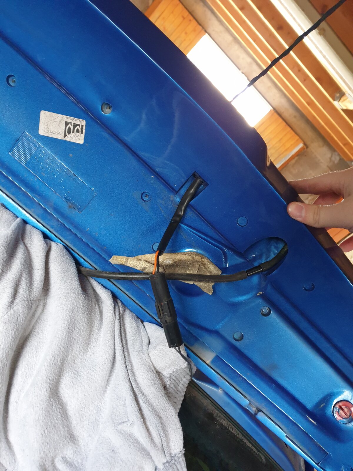

Now you need to remove the connector on the right by pressing on the little grey tip, didnt take a pic of it at the time but it's on the under side of the connector, mine was really hard to get out even by pressing the little tip really hard as it was on there for 15 years, but it did come out eventually.

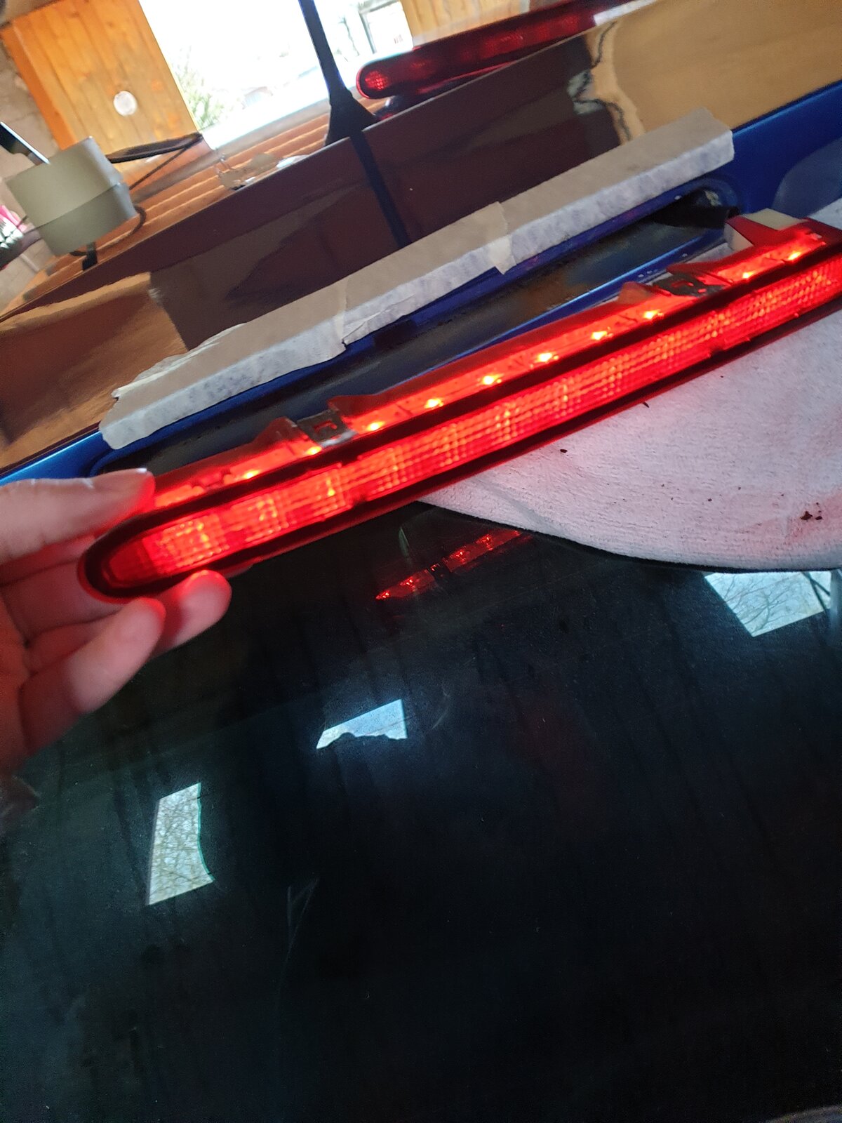

4) When that's done, take your new brake light, fit it, and test it, i tested mine by just putting the ignition, without starting the car. And removed the brake senser from the pedal so the light would stay on ( i was alone, but you could just have someone to help you see if it works or not). Hopefully it works now.
5) Now this step is not neccerary if you're lucky, now if you're like me you are finding that the light doesnt reaaally quite fits in. So what i did is i just sanded down one of the sides so it would get in easier, then whilst fitting i had to use a bit of brute force, i kept "punching" it in with the side of my hand as it is a really close fit. You could use a mallet, but you just need to focus on spreading the force when you're smacking it cuz you obviously dont wanna break your brand new light, just imagine you're giving your girl a good spank lmao, it will get in.
TADAAA it's done :
