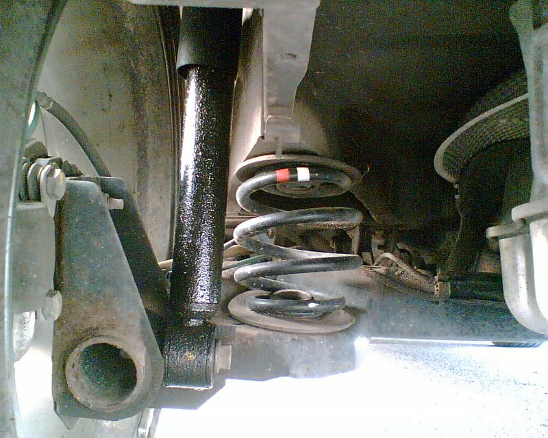

How did you discover the loss of oil? Was there oil under the rear of the car or was the rear twichy?

I was actually quite glad in how quickly I realised what the problem was! It felt a little loose at the back one day and then their was a slight knocking from the nearside rear.
Got to work and checked the nearside rear. Sure enough, the tell-tale glint of oil....
By the time I actually got back home (driving very carefully, obviously!) it sounded like there was a small drum kit at the rear. You can't mistake the noise.
D.
Thanks for the picture Darren. . . mine has felt loose at the rear lately, I will have a look at see if I can see any oil leak.
