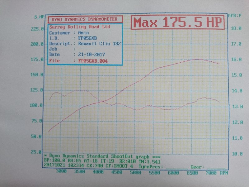

Is this Air fuel ratio correct? What should it be on a healthy 182?
Charlie at Surrey Rolling Road said its running a tad lean? What Could cause that?
Spec
Ph1 airbox, caf & performance filter
Rs tuner map
Ktec 2.25 inch decat system

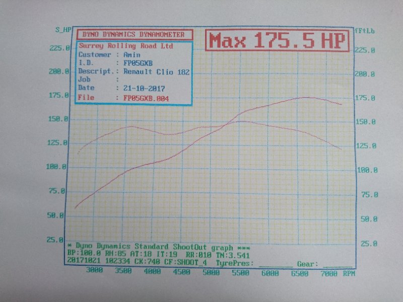

Second graph with torque looks about right to me.

Lambda or ECU temp sensor are worth a look if you're worried, MAP sensor is a possibility.
The figures on the graph a fly hp I assume?
charltjr
Does look a little bit lean, especially lower down the rev range. Wants to be about 13 at full throttle on these IIRC, but it's not like you're heading up to properly dangerous territory.
I believe it's atf figure yes. A few 1*2 made about the same on the Day.
Both lambda sensor and coolant temp sensor are fairly new.
