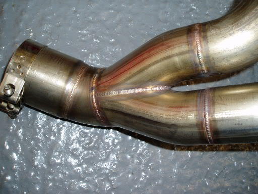

shed's is nice (i don't like the pipe work where it splits, and the silencers are too big for my liking, but nice welding)

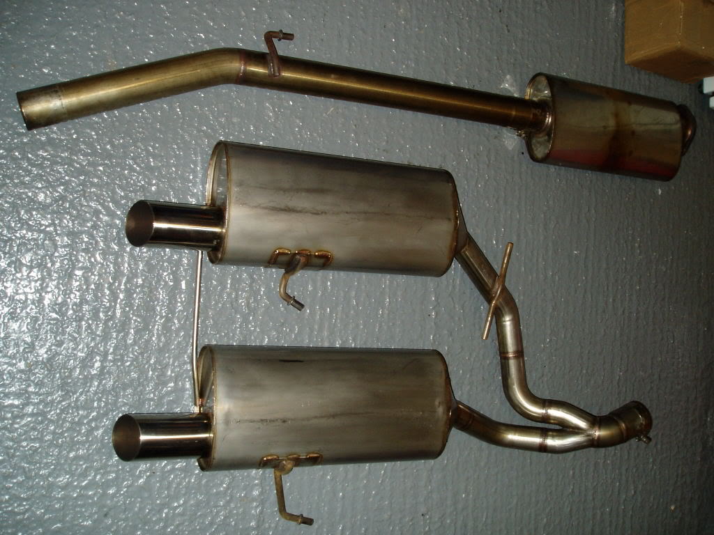

Struggling to see whats not to like about this>>>
The rear boxes are shorter and 5kg lighter than the std boxes ;)
