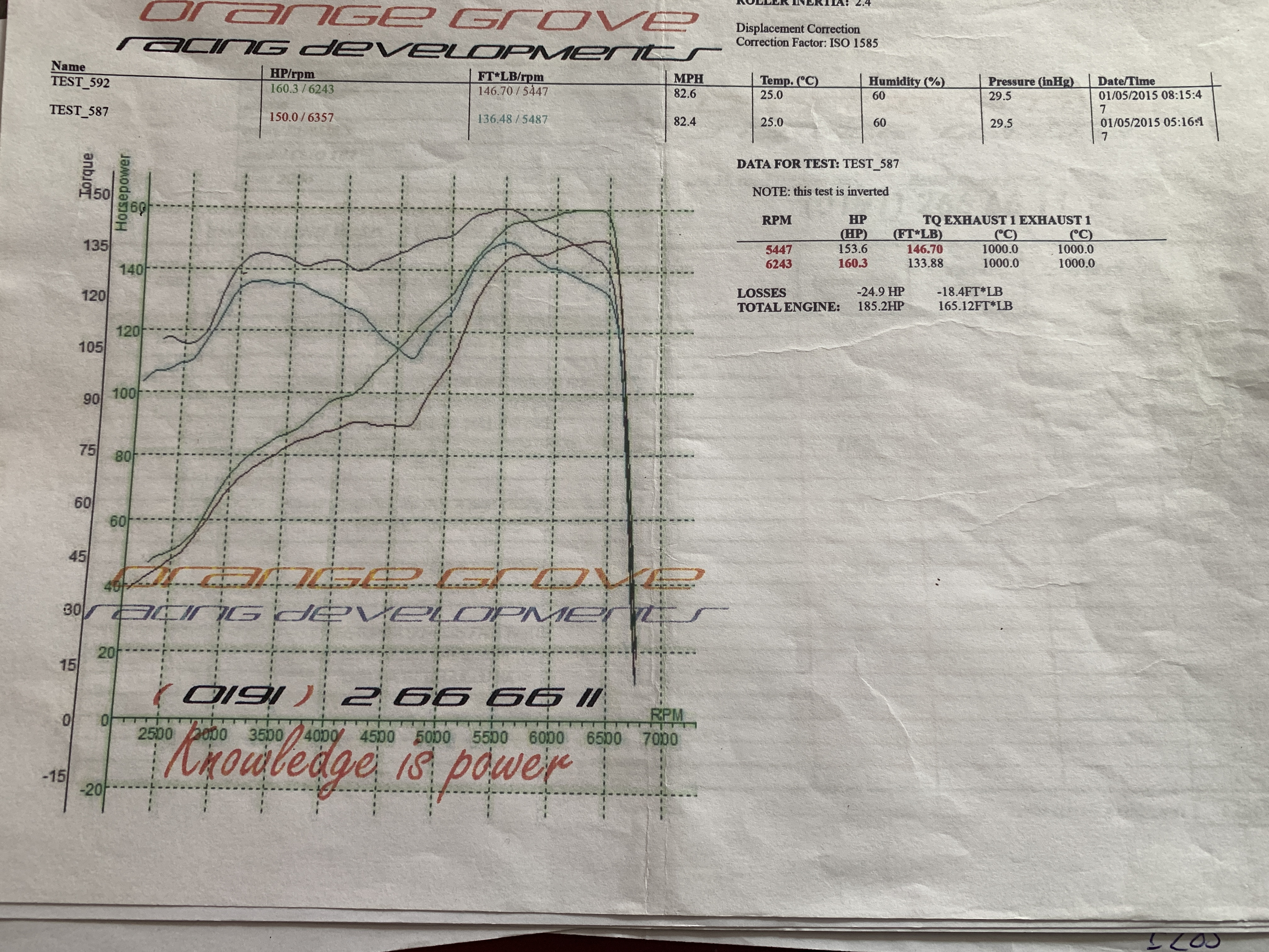

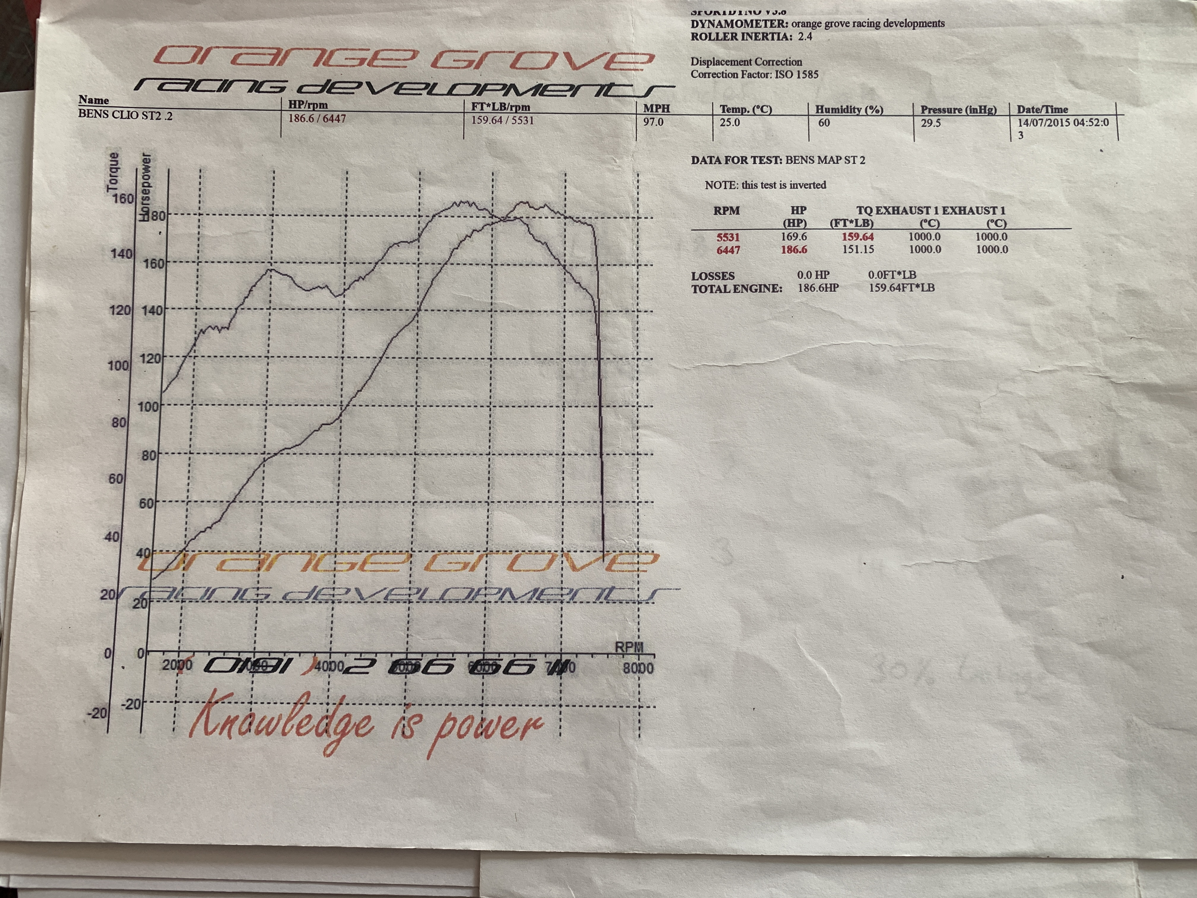

Ok here’s how it started when I first got the car, I’m gonna post what I have and try to get them in right order. As I haven’t posted on here before I’m not sure how to post multiple photos at once. Anyway this was initial leak down test before anything was done. The car hadn’t been cared for when you go through the first lot of mot history

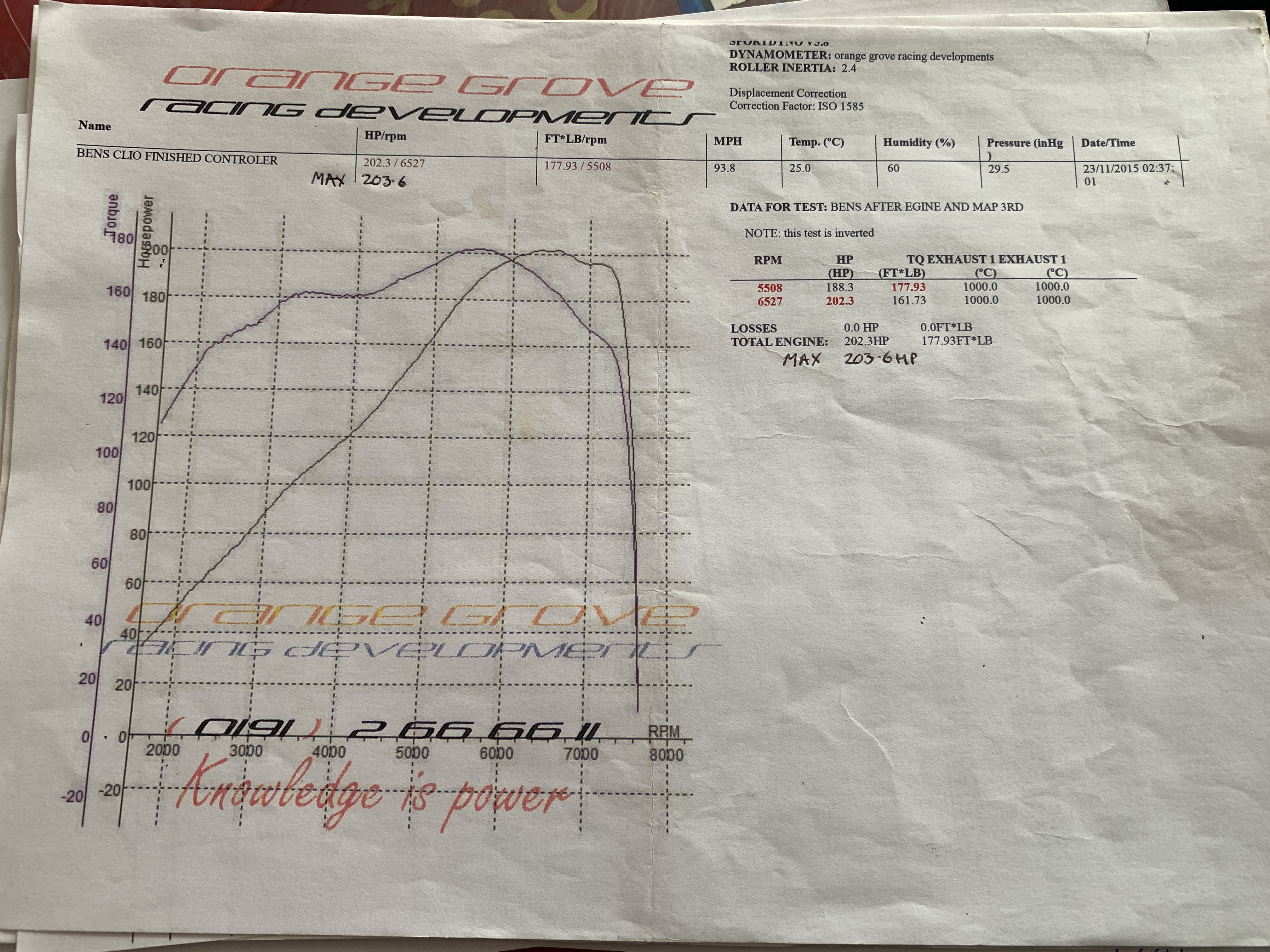

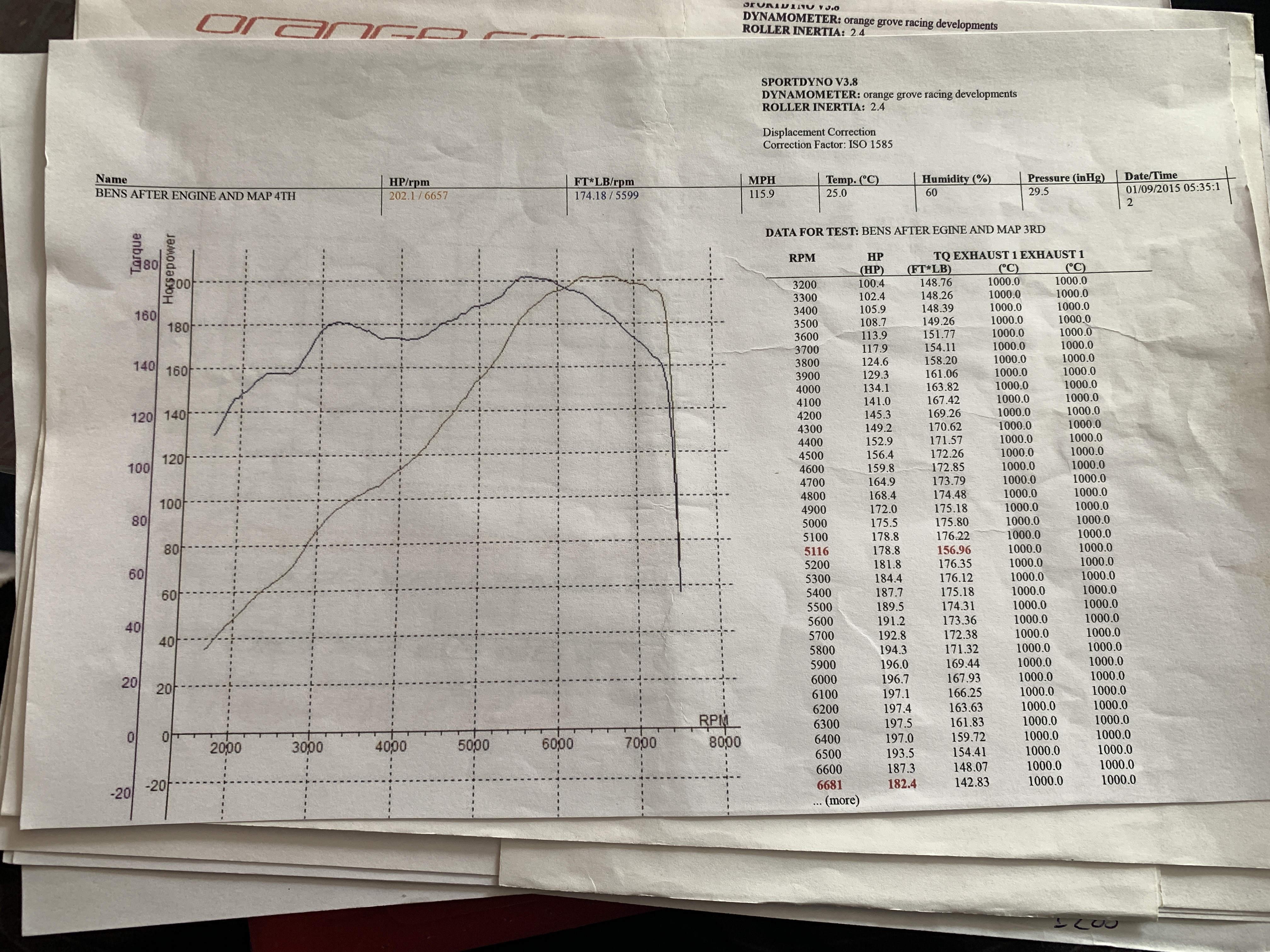

This is the final map, if you look at the dates u can see it was done over a few months from the time I bought it so was on and off the dyno several times.
This is all I have paperwork wise. I do know a 172 cup went on and he managed to get 198 out of it.

In all fairness, those figures look a tad high especially the torque, given that I had the following work done on mine:-
  • Complete strip down of the engine
  • 197 pistons
  • Catcam 438s cams
  • Supertech valves
  • Remap at Engine Dynamics - including a specific 98RON map
From that, I was a midge's dick away from 200 - at 199.2bhp and 164lb/ft of torque. It could be that you just have a really good base engine, despite the initial readings and that having it fettled has released a lot of trapped power. I'm just a bit sceptical of the torque knocking on the door of 178lb/ft with no major internal mods on an N/A engine though.
Sir_Dave
ClioSport Trader
Looking at the graphs, your "150-160bhp" is at the wheels, they are then using a 25bhp transmission loss to calculate flywheel figures.
So before the work, when it was "knackered" it had 175-185bhp at the fly, which is probably 25-35bhp to high, depending on how f*cked it was.
You're now at "202bhp" at the fly, which is probably the same 25-35bhp too high.
The map on the Trophy is also the same as the normal 182.
I'd suggest putting it on an independent "dyno dynamics" rolling road to see what its running, if healthy, with those mods, id say 175-180bhp (y)
