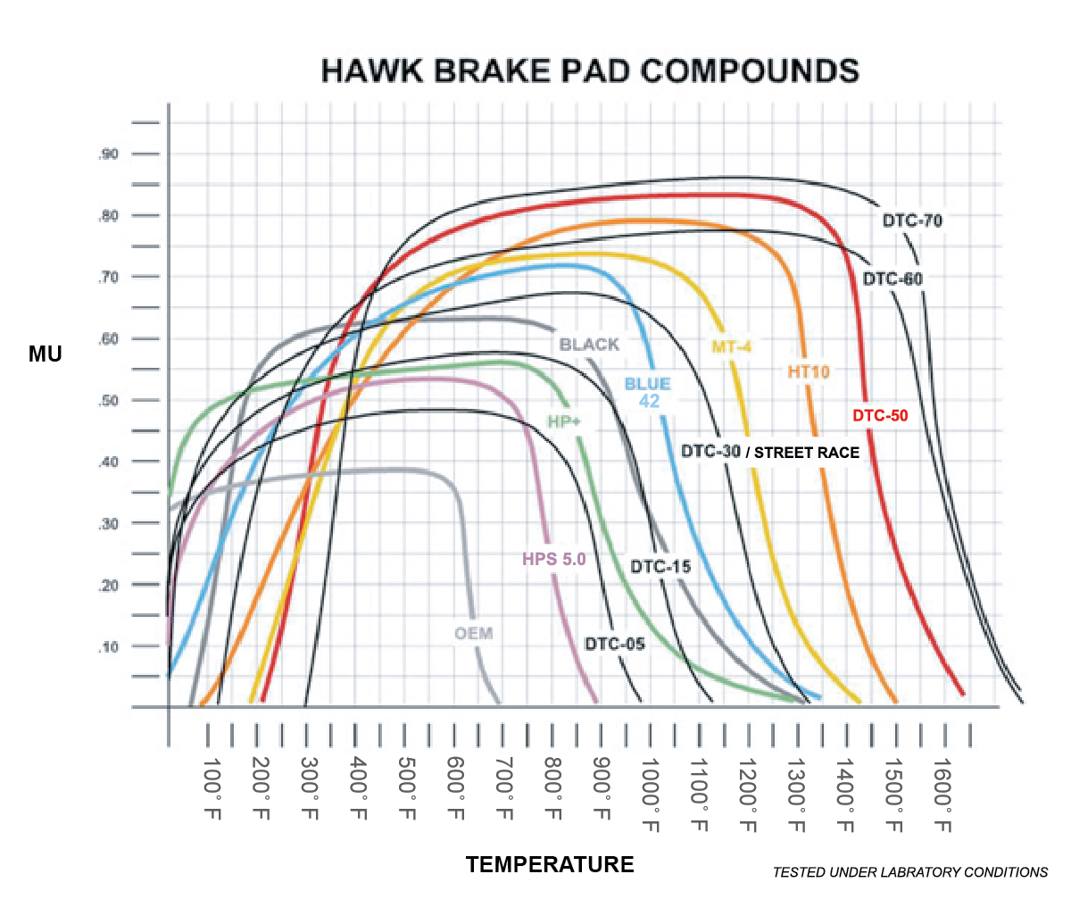

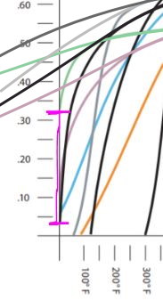

1430022
I went with the HP+ because the mu/friction rating compared to all their other pads at 'stone cold' was much higher (HP+ being the green line) and who really needs a pad that runs above 800 degrees Fahrenheit on the road?!
1430021
I have tried the DTC-30 in a different car and I just don't like it - feels very 'wooden' and has little feel through the pedal/seat, and while it may be more epic when hot, I think it would be poor when cold and you'd struggle to get up to temperature on the road unless you're driving like a tit!
I swapped to the HP+ from the unknown pads that were on when I got the car because first stop of the morning was anything but - several times I sailed past where I was aiming to stop because they just didn't work when cold :eek: so OEM+ retardation when icy cold with the HP+ is just fine by me!
  406 V6, Race Buggy
I'd take that friction graph with a big pinch of salt because the ends where they drop off are completely made up. Probably by a marketing guy who just set them to go to zero the minute they didn't have a data point. It's absolutely no use outside of the actual working temperature ranges they've recorded, where it drops off at the start and end are fiction.
Mind, most of those graphs are fiction, it's just that one is a lot worse than most.
You may well be correct, lol.
I can testify that the HP+ are awesome when cold, though, if that's any help :p

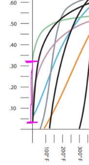

Yeah, it's just the distance you marked there on the graph is nothing like what they are - realistically they probably do something more like this:
But even then you need at least a 3d or 4d graph really for brake compounds - they're pressure and time sensitive as well as temperature.
