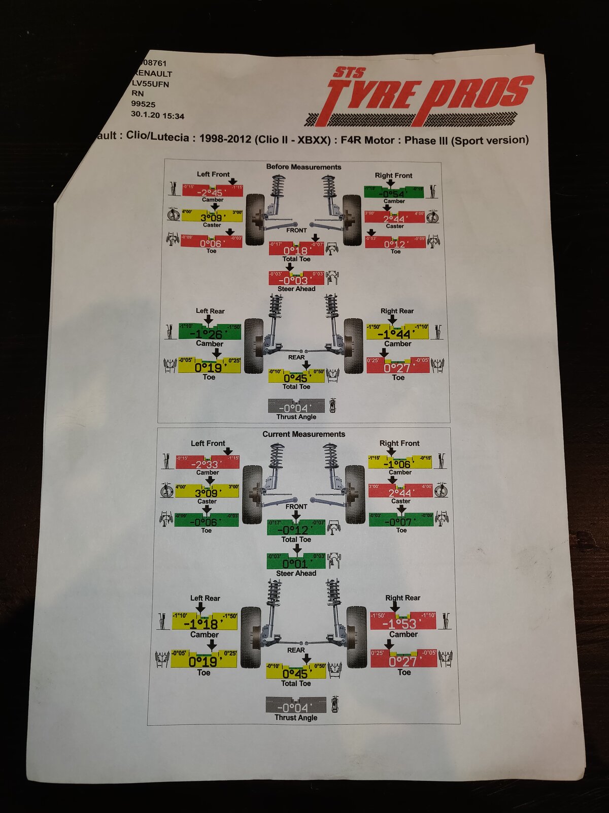

I had some new tyres fitted last week, and thought I'd get the geometry checked while I was there, and its all over the place. What should the values be? The car has Eibach springs on Cup dampers.
I assume Eibach front camber bolts would be a good place to start?
Also, any recommendations for where to take the car to get the geo done properly.
Definitely needs camber bolts.
The rest isn't too bad. Could shim the rear to get the camber a bit more even if you wanted.
Where abouts are you?
What size shims would you recommend?
I'm in Bexley, which is Greater London/North West Kent border.
As said, camber bolts and adjustment on the front would put you in a much better place. The rest isn't too bad. Most rear beams are all slightly bent.
You could add a camber shim to the NSR to make it nearer -1.53 on the other side.
