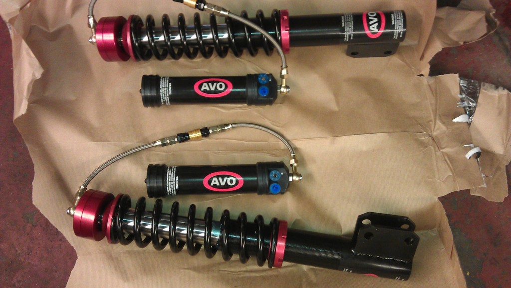

we currently run a 182 on tarmac rallies but thought we would have a go at a forest event . we need some help on spring rates and lengths also any recommendations on tyres and any other set up info cheers Will Philip

not long fitted these to a forest car...

Have Avo solved the issue with the remote canisters not fitting through the strut top hole yet?

Interesting on the dry break connector, not 100% how that would work without introducing some sort of air bubble in the system...?
Regards Gavel not done anything but obviously softer spring damper setting but surface dependant etc. Works Renault manual highlights 230 front vs 115 rear (if 1:1 coilover used) but would definitely stiffen the rear beam running that soft.

Would the residual pressure be enough to stop any air ingress into the reservoirs Steve?
That said, had always assumed they had to be depressurised to reconnect.
