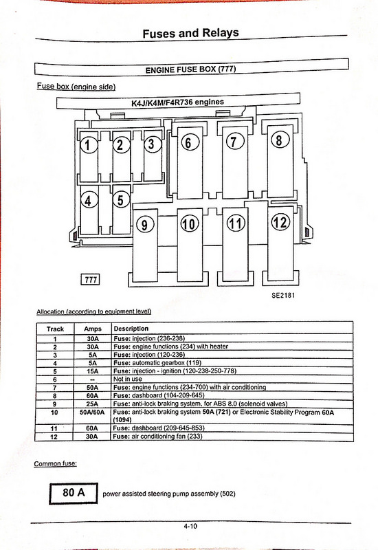

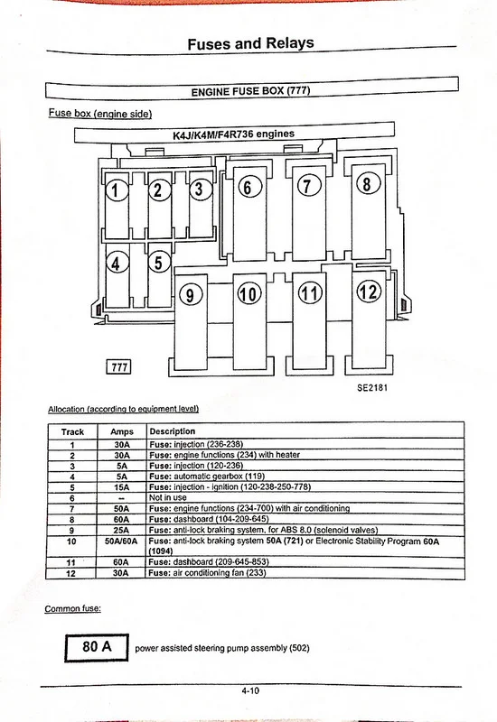

Engine bay fuses & relays.

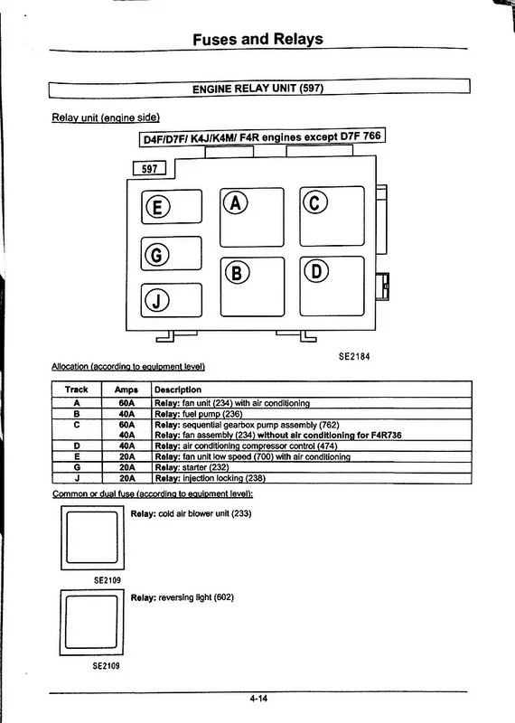

Just coming back to this, It turned out to either be a relay problem or connection as i replaced the 3 relays pictured below and ive been using it for a couple of weeks and it seems fine now.
One thing ive noticed after changing the 3 is, my emissions light no longer comes on which has been doing randomly since ive had the car from new and the first few days after swapping them the car stank of eggs but this seems to have gone away now. As you can probably tell im clueless when it comes to cars. Anyone any idea why this was?
Thanks
  PH2 172
Thanks
Thanks for concluding this.
Relay G in the middle is the starter relay, so that make sense.
