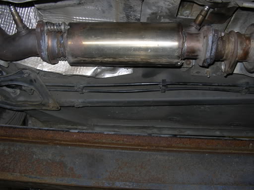

Bought my 182 manifold a few months back and finally got it all bolted up to the mk1 172 today.
Got a couple o mates on the job, one a mechanic and the other a welder. Cost me the grand total of 100 notes all done.

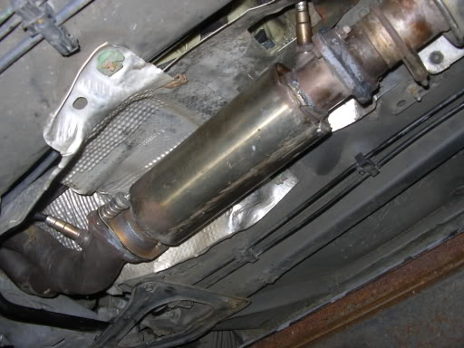

We also cut down and modded my Janspeed decat to fit to the system. Biggest job was getting hold of a gasket between the centre section and the decat !!
For some reason the exhaust sounds a whole lot quieter which is a bit strange. Got more of a quality growl now.
Cars booked in for a remap on Monday.
Only down size is we couldnt use the 182 cat for MOT time due to it being too long.

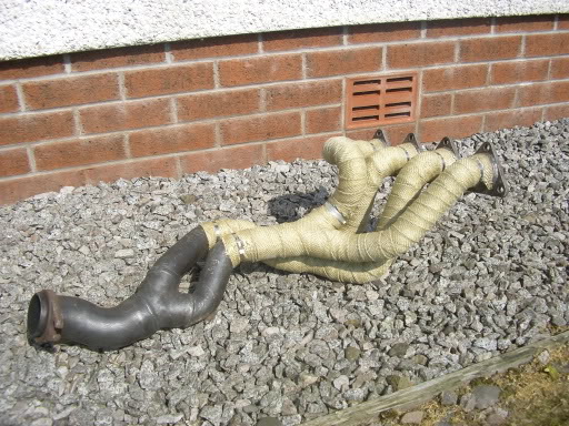

50 foot of wrapping on that !! the wee tie's are a fiver each !!
God knows if it works but as i had the manifold sitting there and its only to be done once i thought why not plus i spoke to Andy GDI and he recommended i did it and apparently he's gonna be doing it to his 182 demo at some point.
any heat reduction is a bonus
oh god yeah, we did it on ours, took afd to do it, the wee tie's are a rip off, you should've used lock wire!

My worry about wrapping the manifold is the quality of the metal used for making it (being OEM and Renault i'd presume not that great!).
Took about 5 hours to fit and about a hour all in to weld the zorst / mod the Janspeed decat.
Does make a noticeable difference to performance from what i felt although not booted it behond 3 thousand revs due to it running dangerously lean. Its in getting remapped now.
